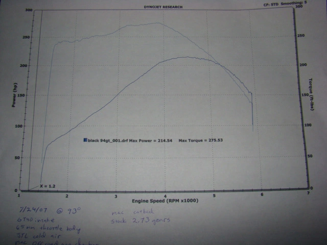

OK heres all the info, whats up?
Gt-40 intake
65mm throttle body
1/2in Spacer
JLT cold air intake
Mac off road prochamber
Mac catback
stock 5.0 w/210,000 miles
with all these ive noticed a huge difference in power, PI 4.6's arnt even close, my friends 350z cant keep with me either, a well kept 93-95 vett is a hell of a close race where its anyones call, and the same with pre LS1 formula firebirds ect.
dyno read 215rwhp 276rwtq
temp was 93*
now i know i have alot of miles but its never been a problem

I don't know what you were expecting
but
A fresh stocker will lay down around 185-190rwhp
with these mods .........
Gt-40 intake
65mm throttle body
1/2in Spacer
JLT cold air intake
Mac catback
It looks about right to me
The intake is your major gain mod for sure :Word:
The rest is small compared to it
When you consider you got over 200k on the clock
I see it as being even more impressive

Thats about right, Get new heads and those numbers will fly up.

Ok well I guess your right, I looked around some more and it seems to be more the norm than I thought, but you know how it is when you spent the money and then go to the dyno with high expectations, but yes the intake made the most difference, and who knows the 200k might have been hurting me more than I thought. I think a new engine is in order, with heads and cam, then some kind of power adder

Yeah, that is about right... Mayeb a few (5-10) HP less than I would have expected...
Do gears when you can afford them (by best mod so far I think) then when the engine goes go with the explorer motor.. that will set you back about $1500 ($500ish for engine, $500ish for needed items, $500 tune)... You can do it for less but not a whole lot...

Now that a few more members have given their thoughts I wanted to
more clearly define my previous thinking
You talk about money spent for so little gain
Believe me ... Been there & done that ... I all too well understand
I listed your mods to the motor again for reference
1) Gt-40 intake
2) 65mm throttle body
3) 1/2in Spacer
4) JLT cold air intake
5) Mac off road prochamber
6) Mac catback
#1 As was said above ... most productive gain ... about 15rwhp
#2 If you got any gain at all ... less than 5rwhp
#3 Not really a gain mod
#4 If it was cool when you dynoed ... a small gain
but ... at a temp of 93 ... most likely ... no gain
#5 This would be your next largest gain mod ... about 10rwhp
#6 Catbacks are about sound ... not hp gain ... less than 5rwhp
With 200k plus miles ... a loss of 5% to 10% would not be unreasonable
Here is how my math rwhp values look when I added them up
190 rwhp stock - 5% loss = 181 rwhp
181 rwhp + 35 rwhp from mods = 216 rwhp
I agree with Grady 100% but I think he planned these numbers to work so well...
I will throw out to look at the tmoss site, he has a table with a good summary of dyno runs and for the most part I would have guessed 220-225 HP and 275-290 tq, BUT then it was 93', not good for power at all.
Go back in the fall and the numbers will be MUCH better...
I knew somebody would say something along those lines
Try to be totally honest ... and ... Look what happens
A tough crowd for sure ... with ... its share of tomato chunkers
Hey ... I know your just funnin with me a bit
Out of all I proposed
As I see it ... the intake to me kinda falls in the most gray area
A gain of only 15 seems a bit conservative at first
but
Consider it is working with untouched E7's
Even if he only went to the next level with some OEM 40's or 40p's
The air flow would be up enough to add something like 5rwhp more
to the gain of that intake
Also ... note that pull was done with a STD cal
so
If it was in SAE ... the values would most likely be less
Gt-40 intake
65mm throttle body
1/2in Spacer
JLT cold air intake
Mac catback
temp was 93*
Stock GT 5-speeds are putting down about 188hp and 253lbft to the rear wheels. You have about 27hp/23lbft more than stock which, I reckon, is right on the mark.
The GT40 intake doesn't yield anything like 15hp; more like 7hp. Add 5hp for the mufflers, 5hp for the Prochamber, 7hp for the CAI, 3hp for the TB, and you're there.
The temp. doesn't matter because the dyno numbers should already be corrected for atmospheric conditions (elevation, barometric pressure, air temperature, humidity).
