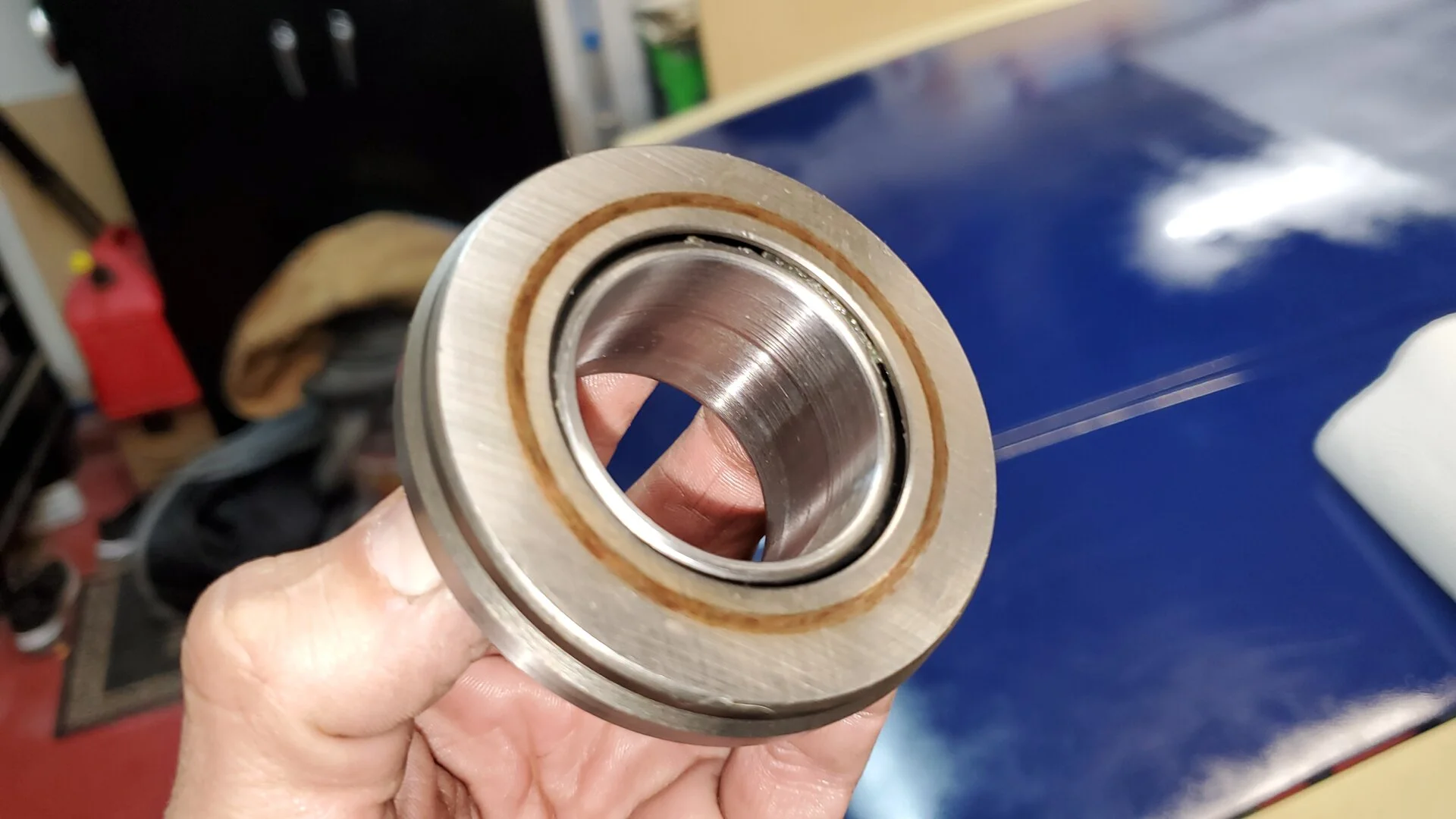

I got my King Cobra kit on eBay. It has a Valeo pressure plate and disc, but I also highly recommend not using the T/O or pilot bearings. Already had to replace the T/O with a Timken. This thing started squawking at me immediately after I put it in. It was all lubed properly, it was just a junk bearing.

Yes, exactly... That's exactly why I bought new Ford OEM TO and pilot bearings and used those and not the ones in the AutoZone kit, which when viewed side by side the OEM bearings are clearly higher quality.
