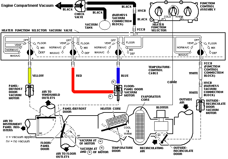

I need to know where it is, how to get to it, how to check it, where the vac hoses are located under the hood, what to check, etc.

This should help..........

Nice picture Tom!

OK, awesome pic, now this: Is the blend door then the big one you can see if you look under the passenger footwell. When I turn my control knob from the Off position to the vent position, that door opens.
Is there another door that opens or closes when I adjust the heat from hot to cold that could be malfunctioning?

The diagram shows the Heat Defrost door that might be hanging up.
What problem is it having?

The blend door is the mechnical one that connects ot the "heat/cool" knob (temp blend door). The one on the driver's foot well side is the one that diverts air from the winshield/footwells to the dash vents heat/degrsot door).

so then the blend door is the one that I can see opening when I turn the knob from "Off" to "vent"?
Is it supposed to have any more movement when I turn the knob from hot to cold?
basically, my heat will blow a little warm, but certainly not hot. The heater core has been flushed, heater hoses are hot, T-stat is a balanced Mr. Gasket 180*.
There is a leak from a broken water pump bolt, but even then i think the heat should be better than lukewarm, so just checking all options.

The door infront of the pass. seat is the outside/recirculate door. Your lack of heat is probably due to low coolant level.

Diagram courtesy of Tmoss and Stang&2birds.
See http://www.veryuseful.com/mustang/tech/engine/ for moreuseful infromation

I checked my vac hoses, and all "appear"' to be connected and still pliable, and I can see the cale and arm for the blend door open, and can hear the flapping when I turn it to cool, but I suppose there's no wat actually see the door open and close w/o taking it apart, right?
