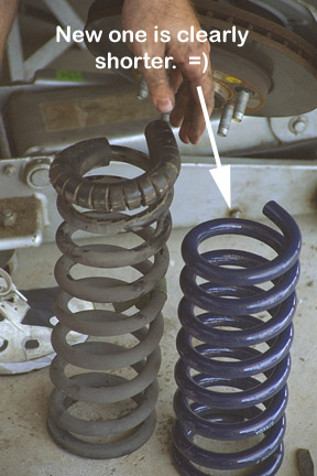

8. Remove the rubber isolators from the top and bottom and place them on the new springs (for the tops, I used zip-ties to keep them in place). Remember which way the pigtails are facing!!!! It will help if you spray some WD40 on the new spring to get the bottom isolator on (snake like sheath). Worked for me.
9. Now, place spring in a-arm (shouldn�t be too bad since the spring is shorter than the stocker). Have a friend hold the strut as you jack the suspension back up. Use one hand (while friend is holding strut) to jack the jack, and the other to guide the sway bar end into the sway bar. Carefully line up the holes of the strut to the tower (you may have to wrestle with the liner again�.I found if you pull down on the strut to compress it, it helps). Once you got them lined up, jack it up and bolt in the strut. Don�t worry about the stock strut (C&C) plates, on the newer stangs, they should be riveted in, but since you will be in need of an alignment, I wouldn�t worry about them moving. The alignment shop is gonna move them for you. Bolt the strut back up at the top (15mm : 30 ft-lbs).
