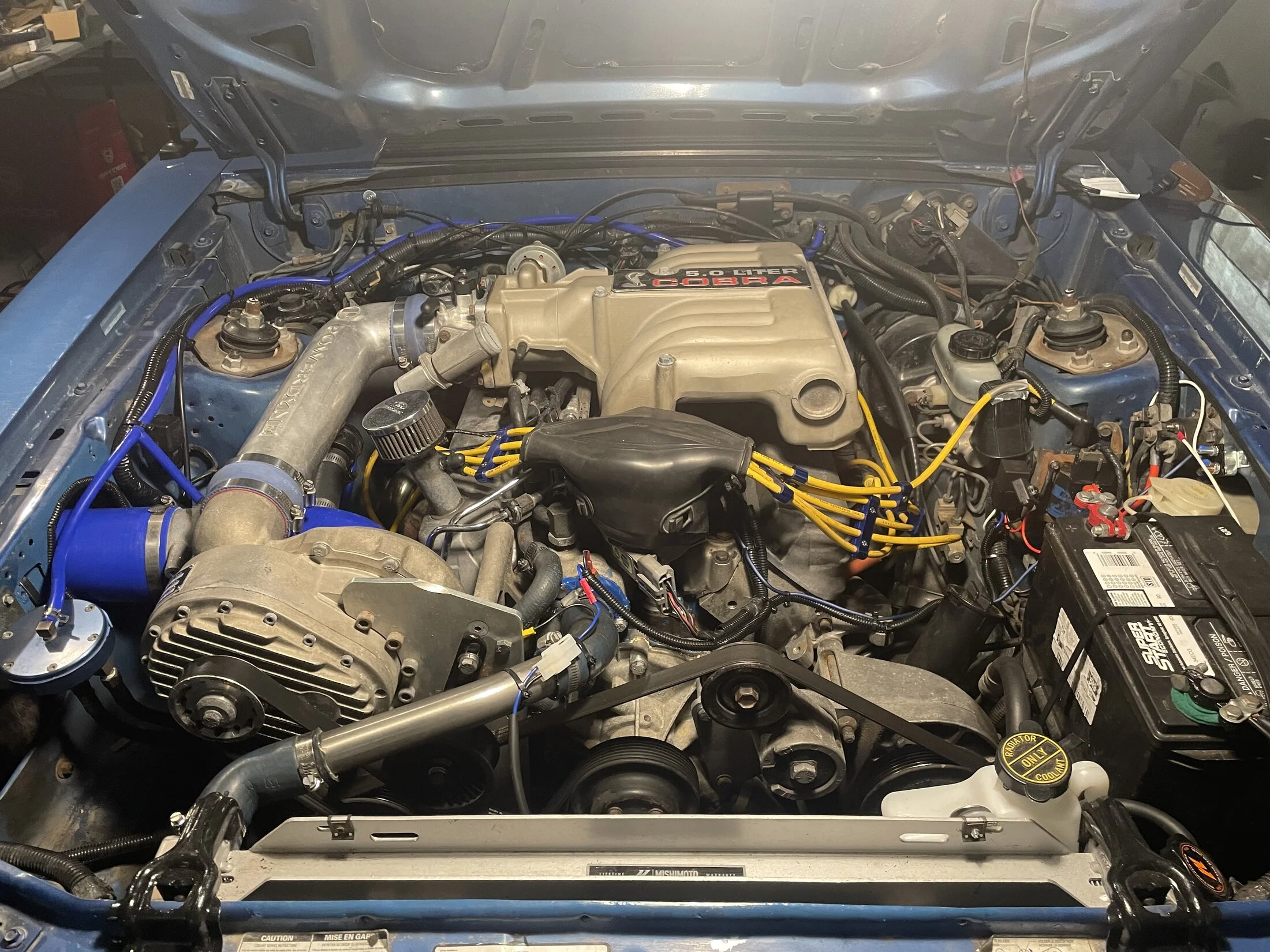

Looks good though don’t it.
What heads are on this car? The cam is usually what puts the factory computer over the edge (and even at that, it will take quite a bit more). A B cam should never be an issue.
