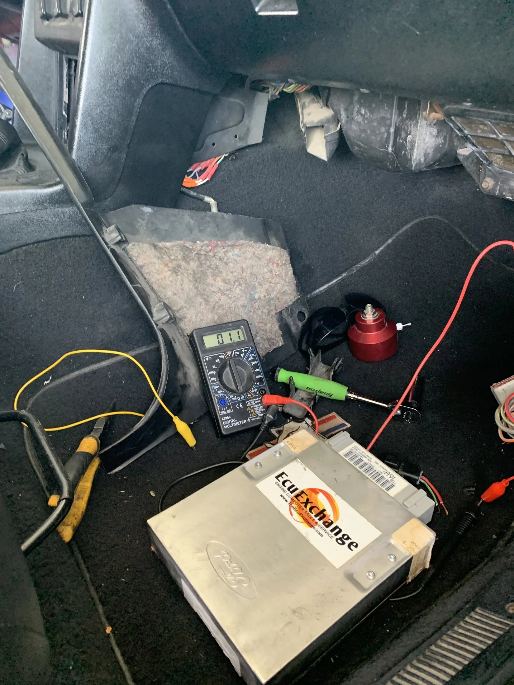

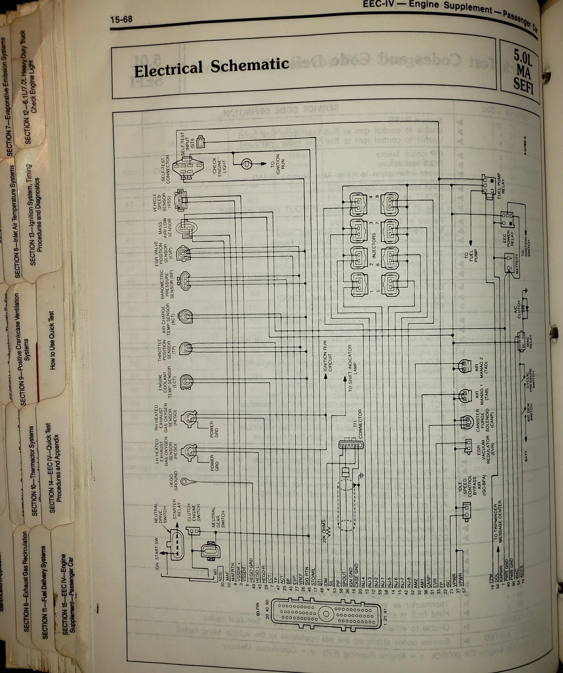

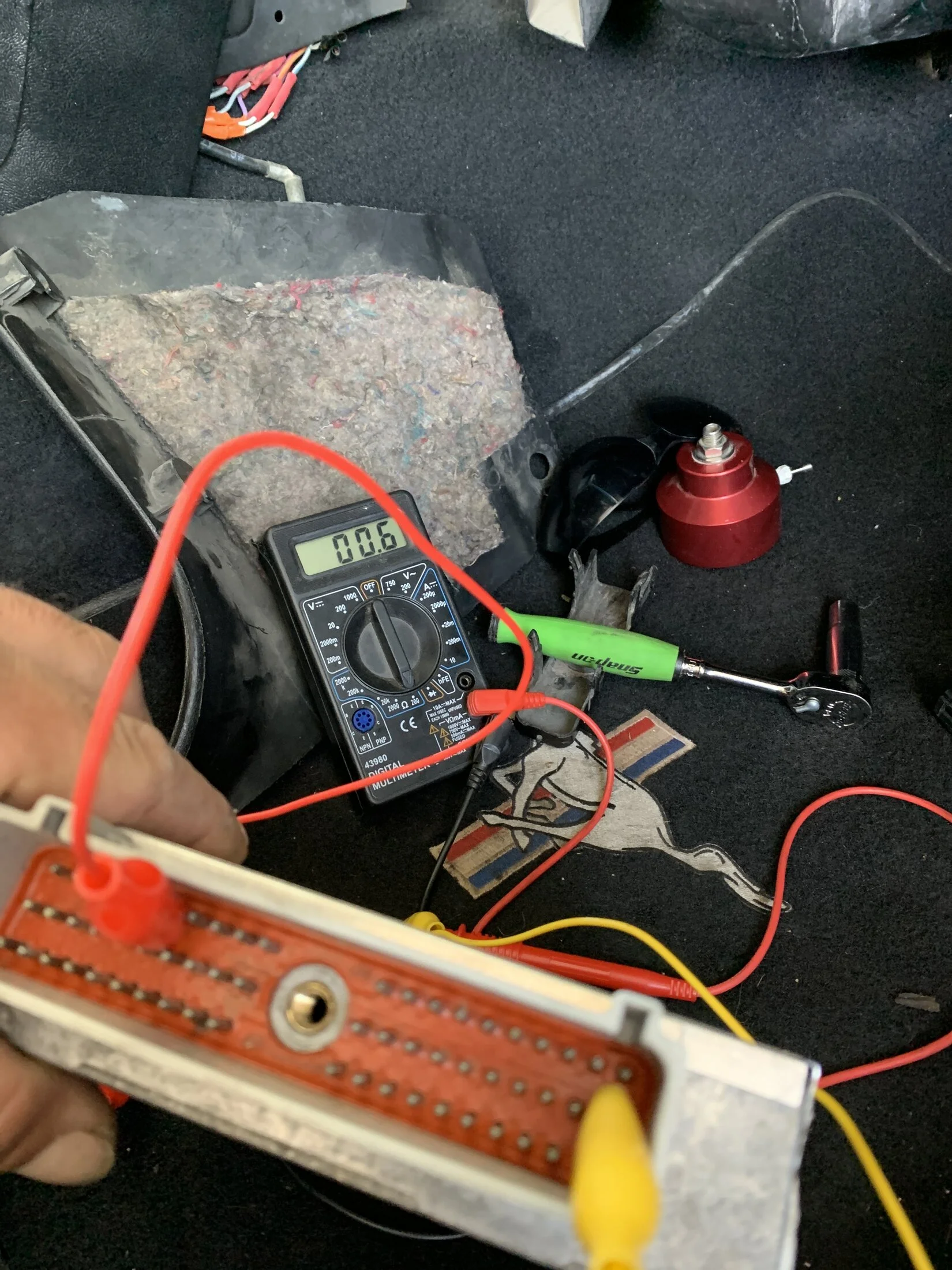

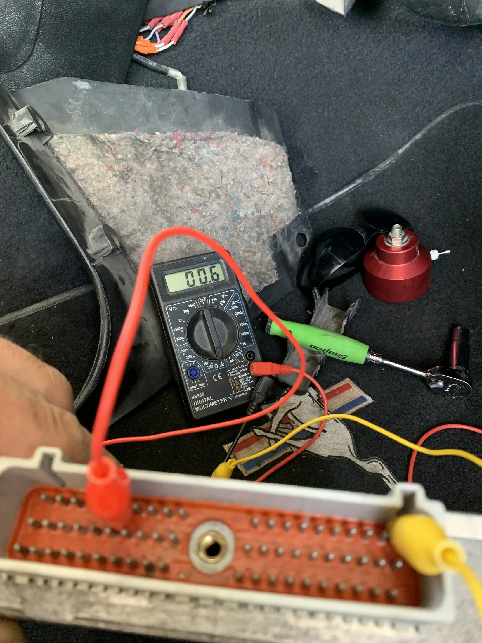

I used this tread from stang net to test wiring ecu first ground test from black/white wire from self test to -battery I got 1.4 ohms. Went to Check 12 volts while ecu battery connected from ground in car to pin 1 on ecu i get 12 volts using battery ground .Pulled ecu out tested from sti black/white wire to pin 46 getting 1.1 ohms to 1.4 ohms(fluctuating) Then tested from pin 40 to 46 and pin 40 to 60 on ecu I got 0.6 ohms.From Sti single wire red/white to pin 48 on the connector no ecu I got 1.1 ohms. Should I be worried about the ecu itself because it’s asking for less then 1.5 ohms and I’m getting 0.6? From pin 46 to 40 0.6 ohms and from pin 46 to 60 same 0.6 ohms. Too low?
