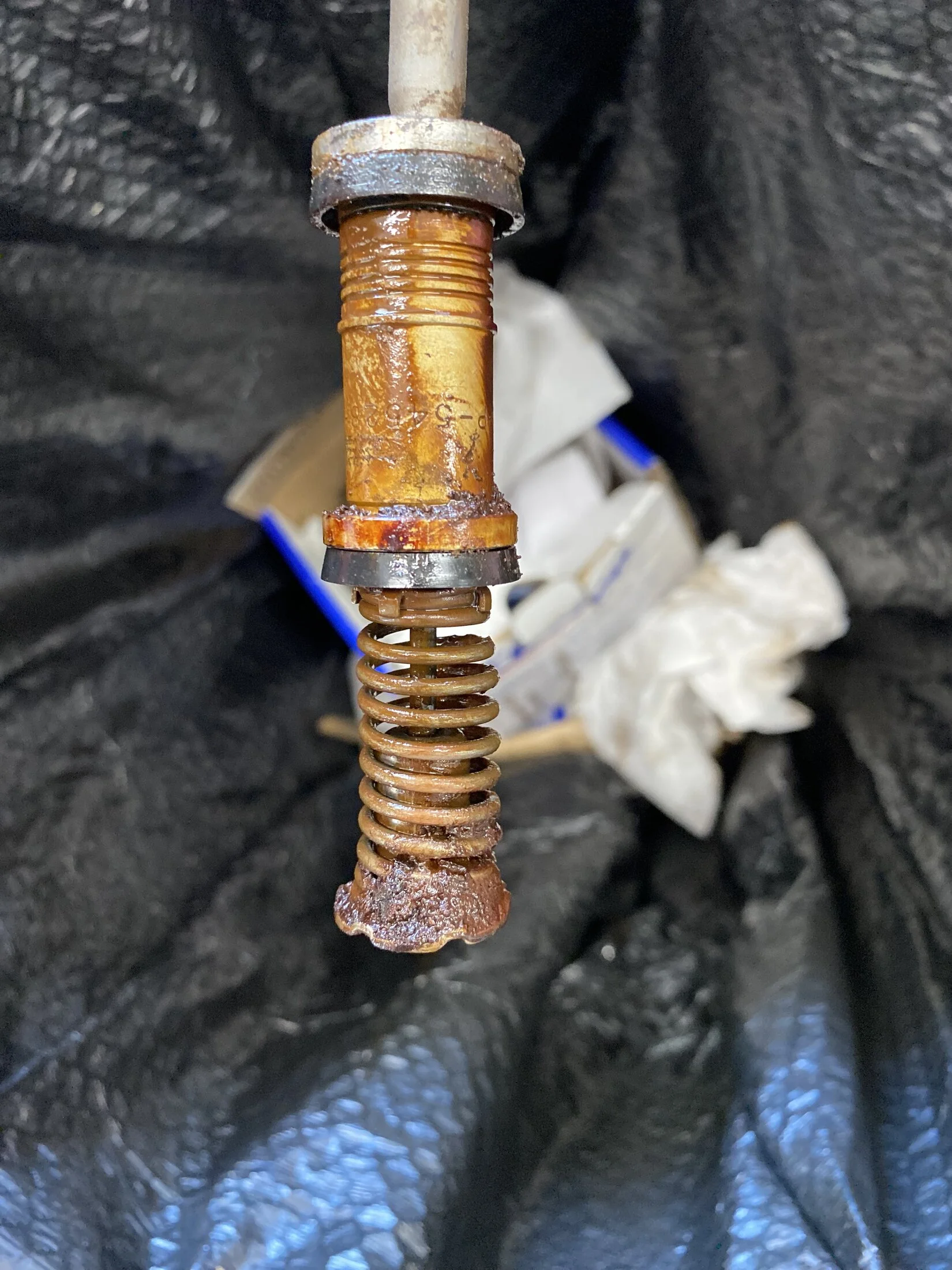

We removed the rod from the old drum/drum MC by cutting it apart but the inside was nasty.
I’m starting to think this crap is also in the front calipers and combination valve. I think I have him convinced he needs to get new calipers and we need to clean the combination valve. IF the combination valve has issues we will most likely gut it and install a manual proportioning valve but I would like to avoid that as he wants this car simple. There may even be an issue with the front soft lines (rubber lines from the body hard lines to the calipers) being old and soft so if we do calipers those will be replaced as well. When we bled the system we ran over a quart of fluid through it and the fluid was clear when we finished. Doesn't mean the calipers and combination valve were clean but just thought I would throw that out there.
