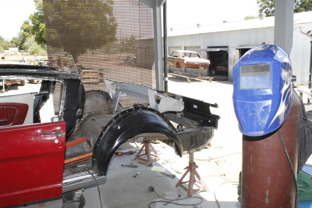

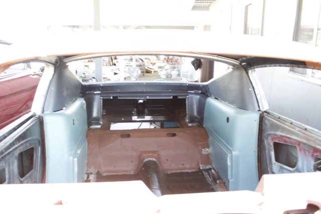

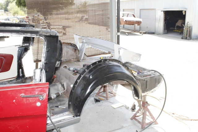

i got the seat devider and the tail panel and the outer wheel tubs in the red one today .you can realy tell the difference between the cheaper wheel tubs that my friend bought and the Dynacorn tubs i used in my car, they are cheaper for a reason.

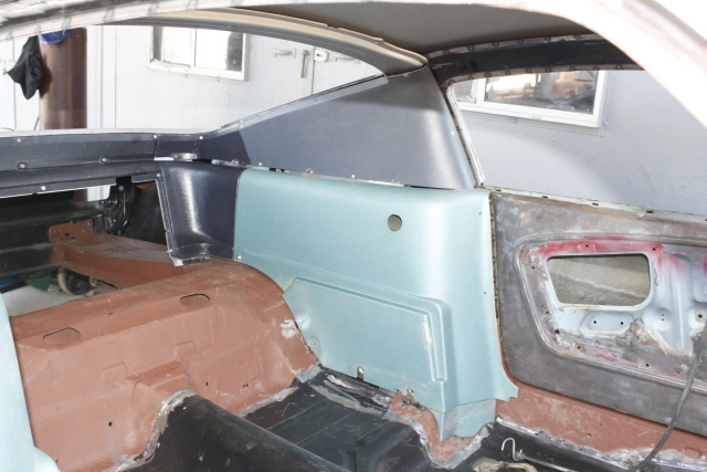

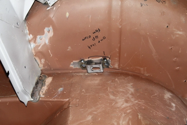

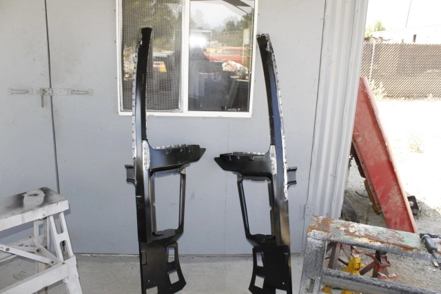

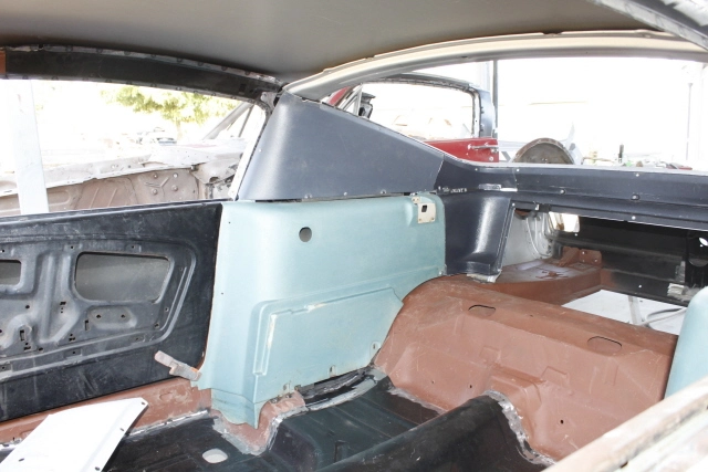

i made the last two brackets ,it was easier than i thought it would be. i bolted and screwed all the fiberglass in place .i have to move the top bracket on the driver side large panel back about 1/4 inch to let the panel pull up all the way but every thing works very nice . now i have to locate the 1 inch wide trim and the two larger trim pieces at the roof on the headliner ,that is the only trim pieces i don't have. i ordered both new doors and both front fenders today not sure when they will be in, nothing comes in fast when i order it.still waiting on the radiator support and the battery apron

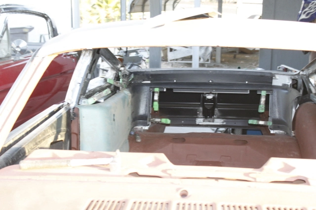

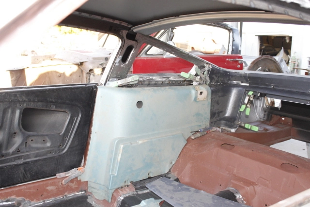

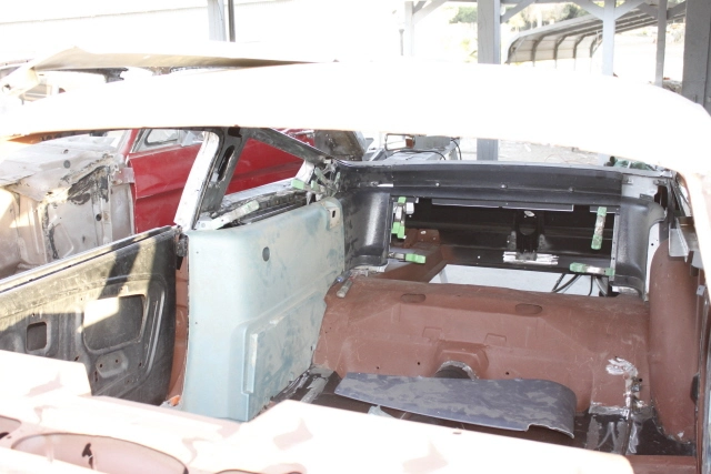

i have all but the two long brackets made,the ones that look like a Ws tied together .they will take a while .i test fit the fiberglass and it FIT. it is only clamped in place and it FITS. all the brackets hit right on in every hole

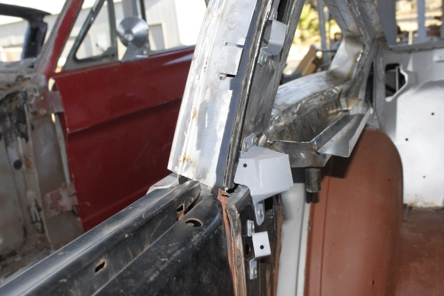

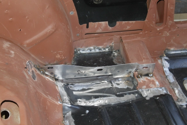

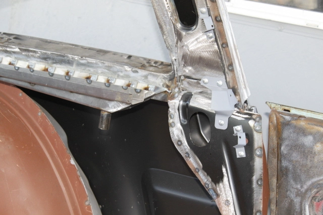

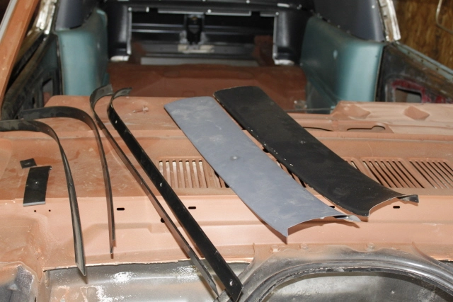

i made some of the brackets that mount the interior fiberglass. the small bracket on the wheel tub and the long bracket that mounts the big panels beside the seat.
the three brackets in the front that mount the big panel and the upper vent panel are original 67s they are the same 65-68 , i got lucky and had a set from a destroyed 67 fast back. i still have about 9 more brackets to go and they are not available so they have to be made. i already tried the fiberglass panels and it looks like a perfect fit so far.

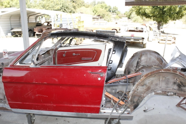

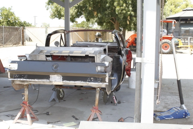

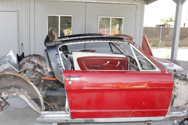

i assembled the door frames today,trimmed them and welded them in . i think i could do this with my eyes closed now . i guess the trunk devider will be next
