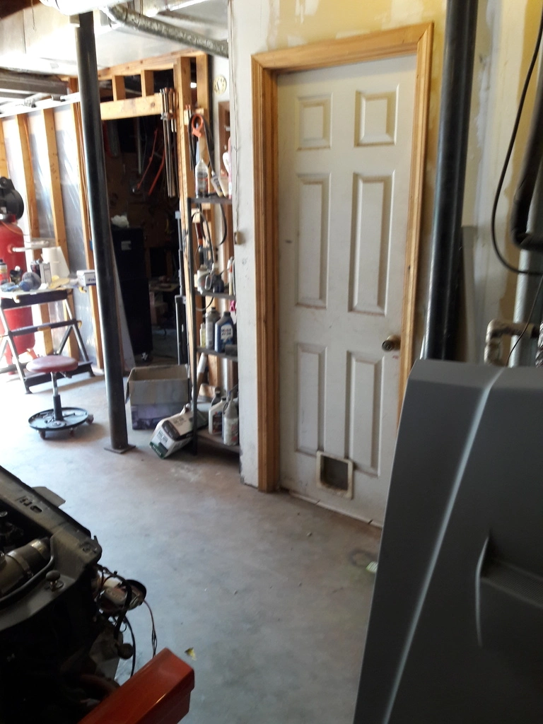

This door,......

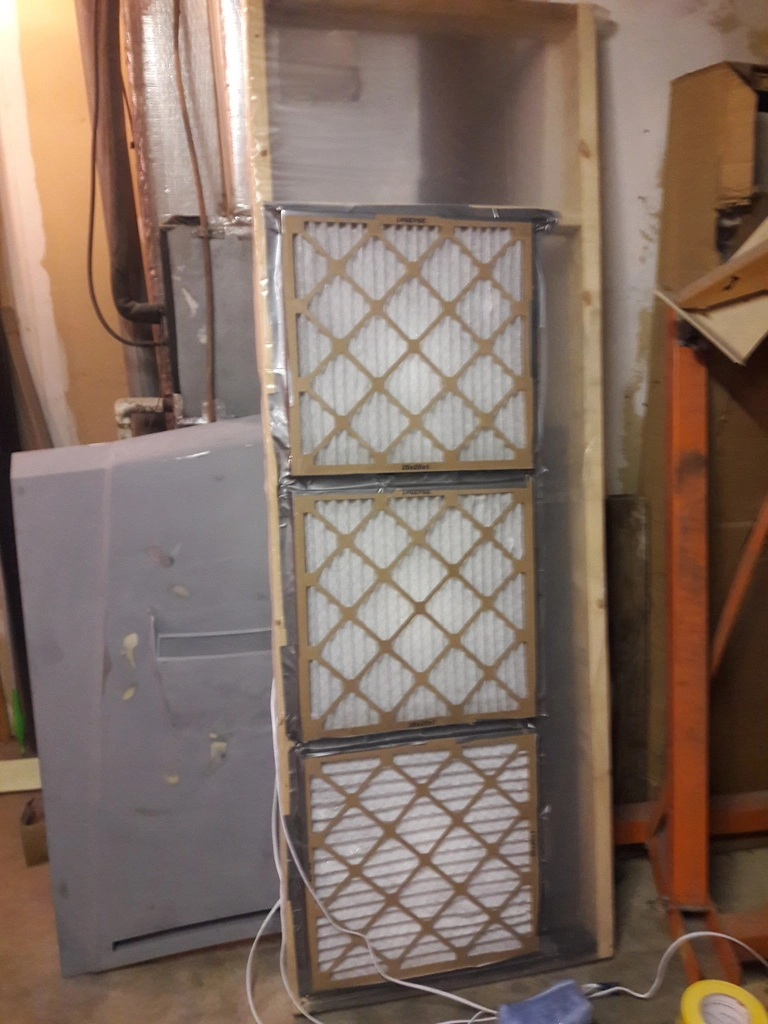

Gets "plugged" with this insert. There are 3 of the 5 box fans stacked behind the filters.

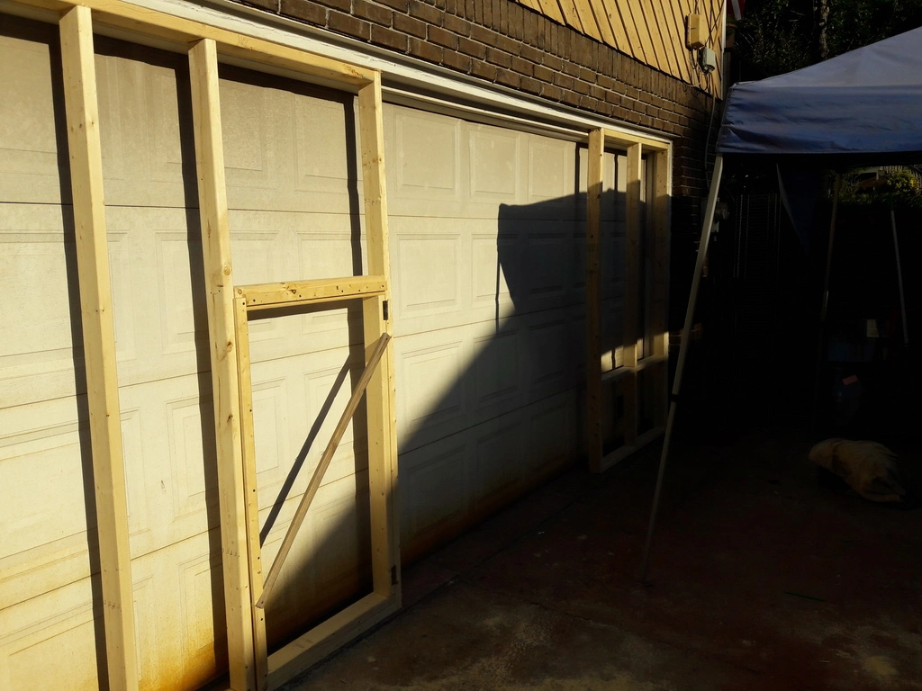

The air will be exhausted through the overhead door opening..
The little "escape hatch" will allow us to get in and out of the booth between coats.
Two fans sit in these boxes, I'll tape two additional filters over the inlet side of the fans to keep bugs out, (Even though there'll be air blowing out,...and it'll have to be one hell of a bug to fight that headwind.) But with my luck......

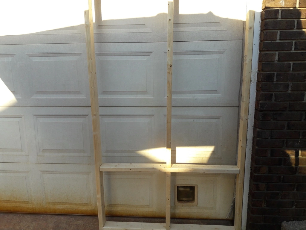

So,...why isn't there lumber in the middle?.......15 studs were not enough.
It just wouldn't be normal if I didn't have something to do over, extra, or because I didn't have enough of for me with this car. Why should I expect anything different?
I'll finish that up tomorrow after work. The center section is removable so that the car can be backed out, and the fenders, hood, and trunk can be painted separately.
That whole door opening gets covered in plastic. I'm gonna wait to do that till Friday morning, because plastic attracts it like a magnet.
