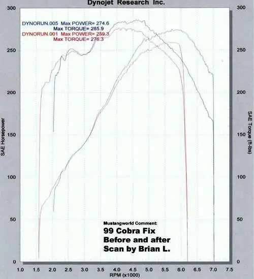

I would prefer a 99 as long as all of the stuff was done to the heads by the dealership. You could get one of the hot ones like I did. Its almost like getting a free port job on your heads.
