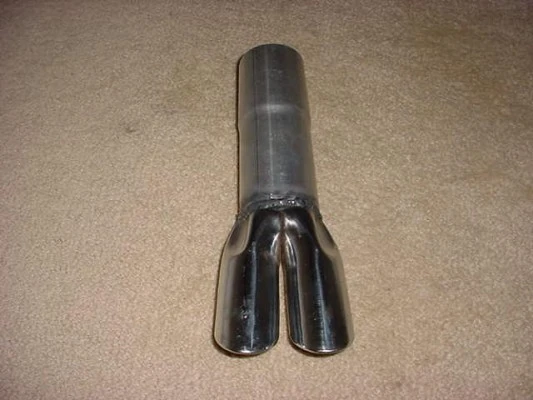

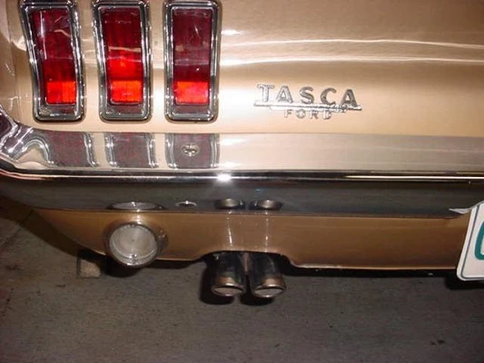

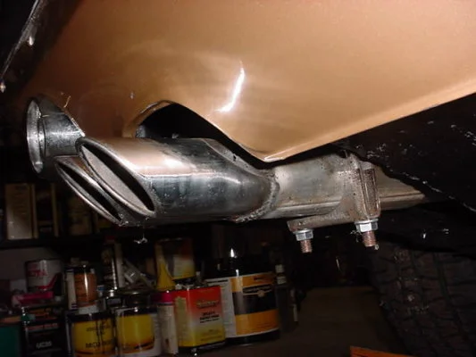

Well, yes and no. I gave up on having some crafted and after several discussions with other folks in the same boat it seemed that the best alternative was to cut the original tips right below the Y and weld on a 2 1/2 to oval stainless transition to make them fit and retain the original look. Here is a set that was done already, hopefully I'll be tackling my own this summer unless I like the look and price of what Pete is selling, I can probably even hook him up with a couple dozen other 69 owners dying for some, (ahem...for a discount of course).
