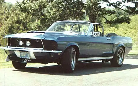

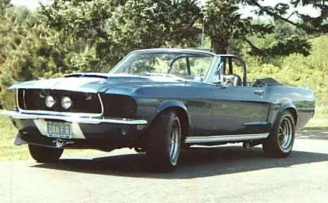

are those the round lights in the middle of the grill? Thats the ones i wanna get. No idea what they are called though.chepsk8 said:The regular Mustang grilles are available at almost any good Mustang Parts vendor. Pic your favorite.

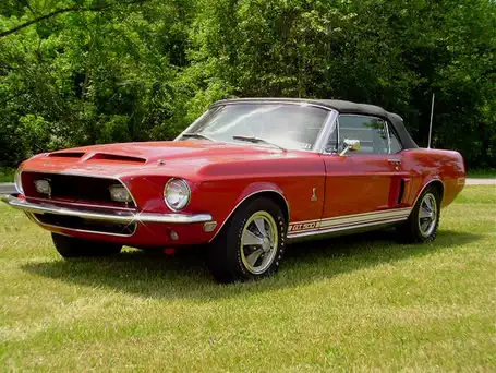

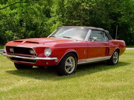

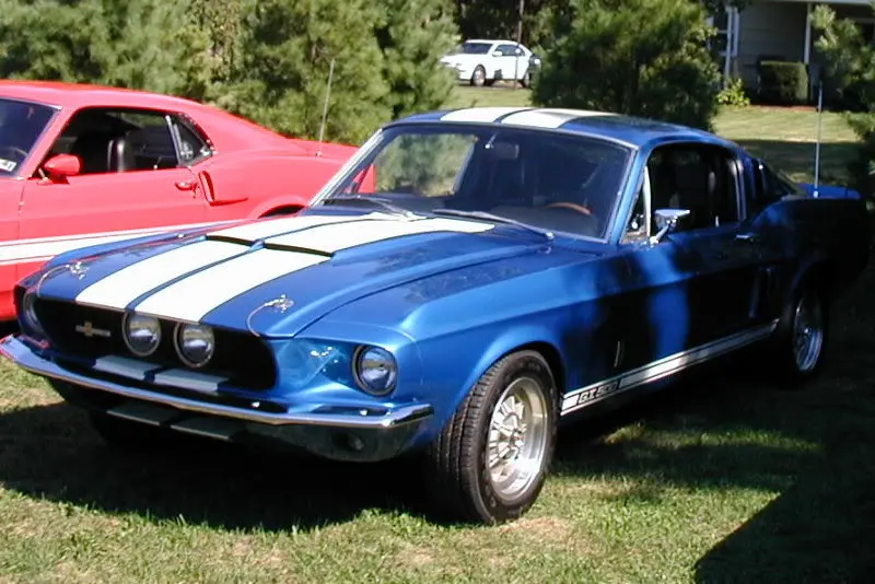

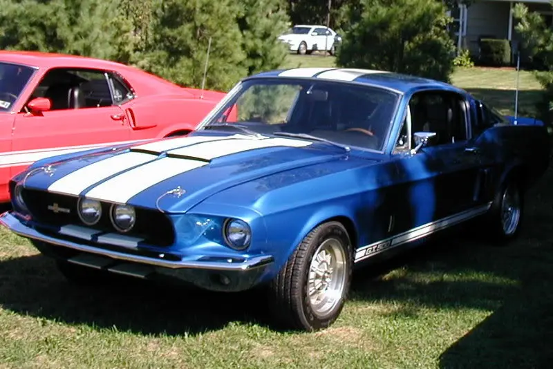

Are the fog lights for a Shelby, GT/CS, or Mustang GT? The 1968 GT-500 & GT/CS originally used a MARCHAL light, I think a few vendors, such as Branda, who specialize in Shelby parts have those, or good reproductions.
yeah i noticed that and i think you convinced me not to do it even though i would love the look it would give my Fastback with the lights. Although i am pretty sure if i change my mind i could modify my stock frontend for a bigger opening.zookeeper said:While you can probably mount the Shelby lights on your Mustang, I wouldn't. The Shelby high beams mount to the Mustang hood latch support and block pretty much the whole upper part of the radiator. That's why the Shelby front ends have a huge opening below the bumper, to expose the radiator to fresh air. Even then, lots of original Shelbys had heating problems. But if you decide to use the Shelby nose, you have to run the Shelby hood, since the Shelby hood is something like 4 inches longer to match the nose.
