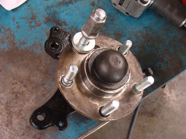

Place hub aside

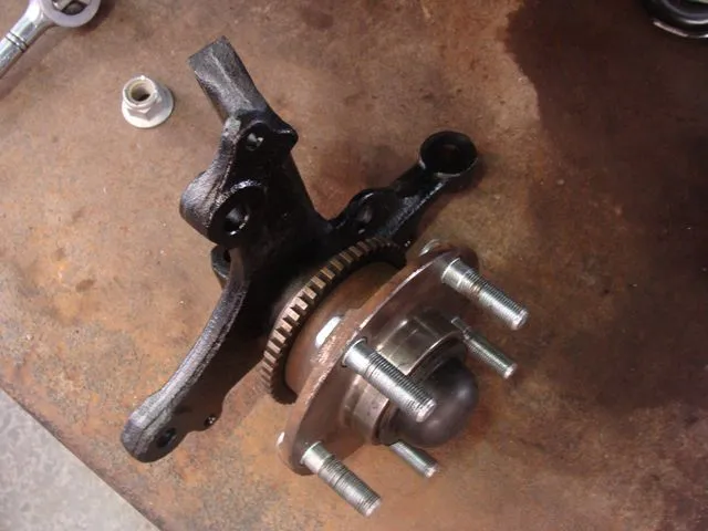

Should look like this:
*note, should look like that plus the control arm, I took mine out already when I took this pic.*

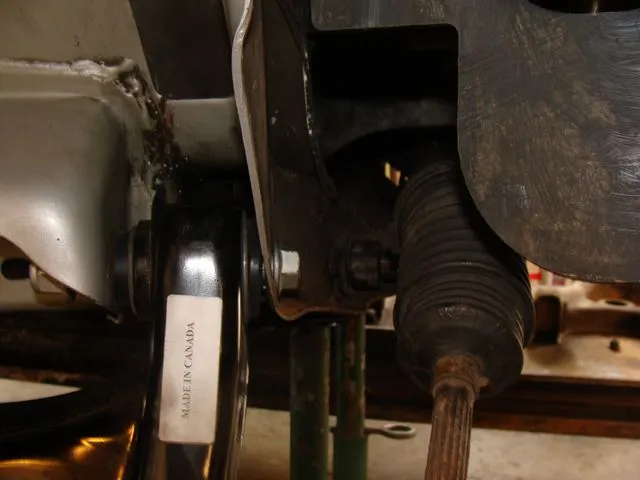

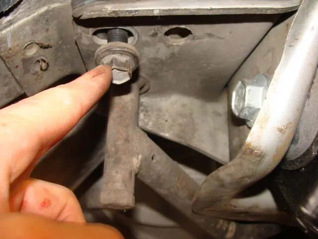

Remove this bolt connecting the K-member, found at the rear outside of the control arm.: The bolt to the right of what I'm pointing at is the rear control arm bolt.
Remove the control arms nut from the inside and remove bolt.

Same with the lugs and/or hub. If you suspect a bearing is gone, the new hub will come with new lugs.
Lugs aren't expensive and easy to replace...once the hub is off, a good thwap with a hammer and they're out, place the new lug through the back, a couple washers and tighten em up until they're flush.

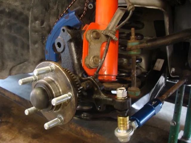

Here's everything but the brakes back together:
