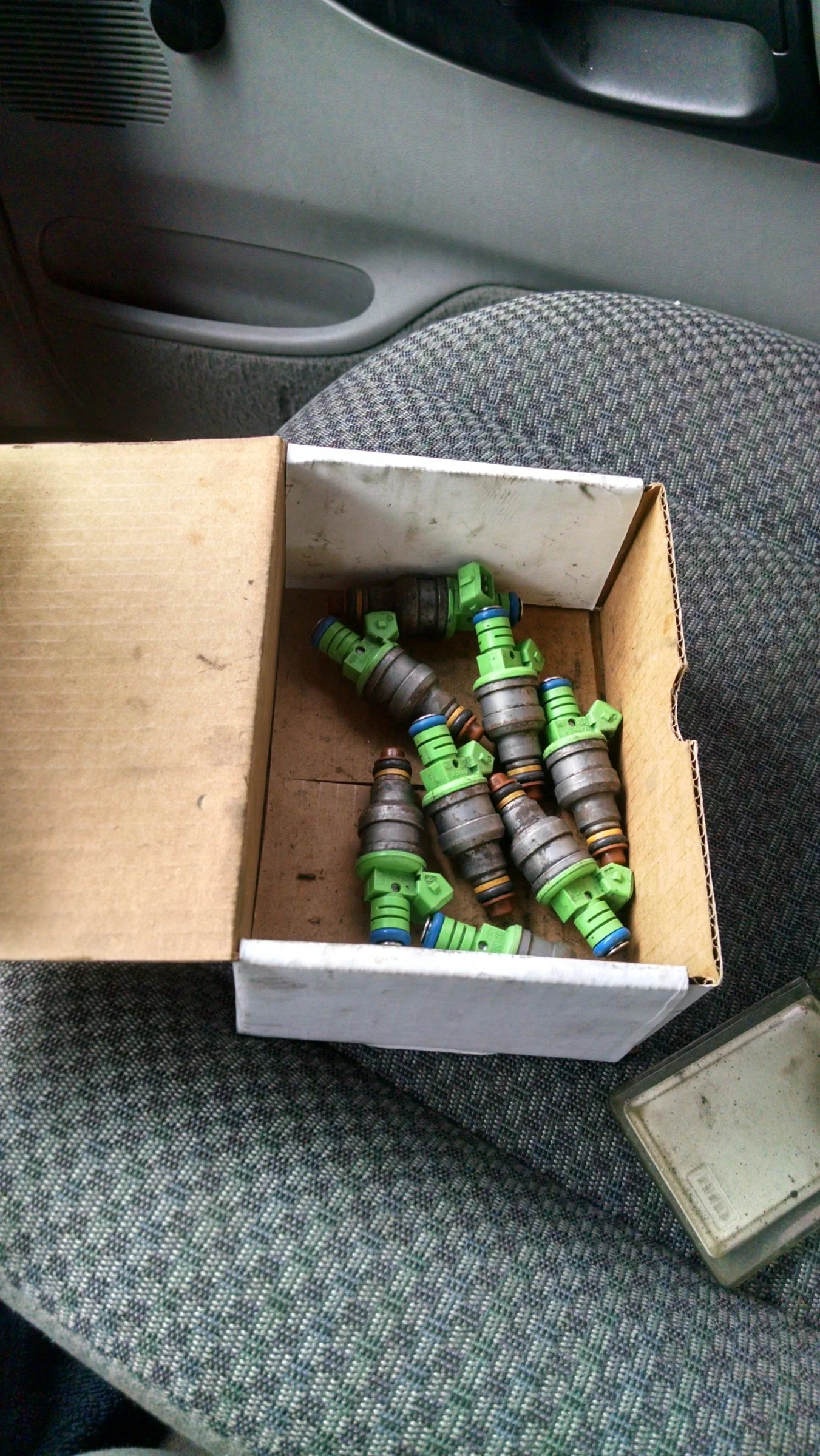

Get the 42lbs turn the fuel pressure up to 50lbs.... what fuel pump do you have? You will need a gss255 high pressure pump.Don't want to insult good info. The ford lightening had 42lb stock injectors....and ran 8 psi with stock blower....motor was also 5.4ci. some run 9-10 stock with intake and exhaust. I Ford has rocket science engineers to tune. I've got to try them for myself. ( I'm broke ) They may max out and I'll have to change them....or they may work for me. I'll data log when the time comes and I'll post every fail.
I really do appreciate all the info I've gotten from you guys. The problem is I started getting garnished and my funds are low. If I don't try this dumb ish then you guys wont see this car drive, under its own power, for about a year.
This way at least over a year you might see me build a dart block monster. I'm rolling the dice. I have an extra plenum gasket and can sell the injectors for a profit....nothing to loose.
You should be fine then. If you set your fuel pressure to 50psi the injectors will act like 52lbers. They should work like this just fine.I've got a 340lph fuel pump. I'll be using a slot style MAF calibration shouldn't be too hard...I hope. @a91what
