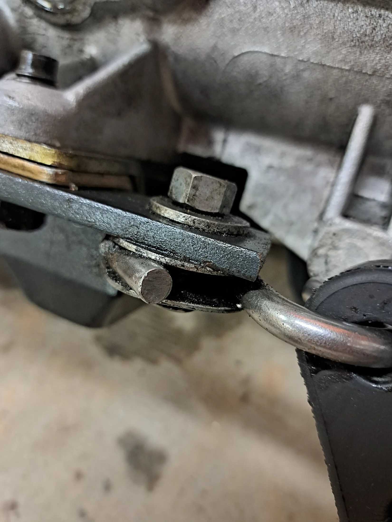

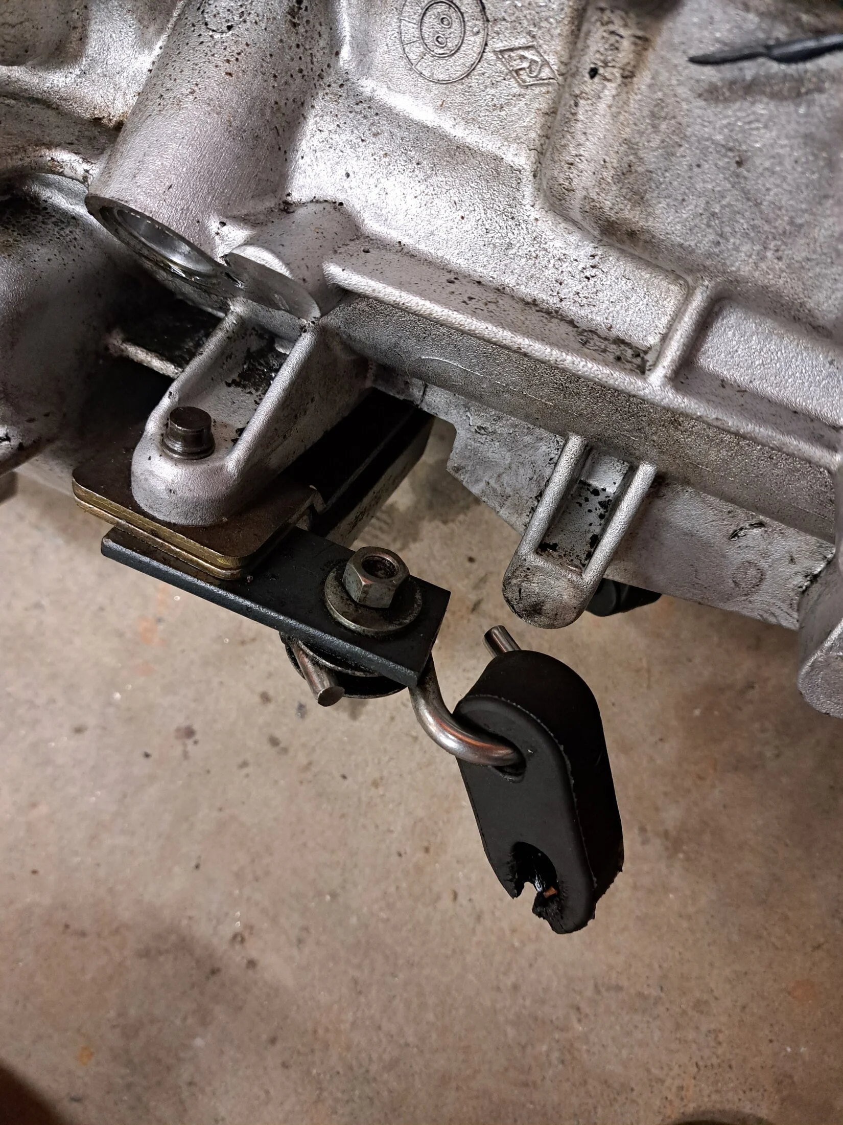

How are you going to hang the mid-pipe? Did you already have the stock SN95 hanger modified for the TR3550? The factory setup is kind of odd hanging off ofthe trailshft housing. I've been trying to think of clean alternatives that don't involve buying a Foxbody mid-pipe or major fabrication.
Thanks!
Fantastic question, and thank you for bringing that up. I actually never thought to mention the midpipe hanger. In 1999 when I installed the TR 3550 I fabricated midpipe hangers. I took 2 S hooks and 4 one inch washers from Hope Depot and welded them together, I then used some bar steel to push them back a few inches, and then bolted them to the top of the transmission mount to hang the midpipe hangers on. I didn't know how to weld at the time, so I had to take them to a local shop and have a guy weld them for me. The transmission mount for the Magnum is identical, so I assume I will be able to transfer the $8 of hardware I use for my midpipe hanger. Whatever, a picture is worth 1000 words, and youtube video is worth 1000 pictures. So I have attached the pictures.
I actually have a Mac Pro-Chamber that was originally designed for 94' headers that I re worked the inlet tubes to fit with foxbody headers. I love the sound that thing makes. Anyway, this a huge opportunity for me to do a technical drawing with part numbers from Home Depot to show other people how to do this extremely inexpensive simple modification.

Thanks a million for posting that, I appreciate it. That's a really straight forward solution for our cars. I really like it because it keeps the setup very clean. Plus, anything that can be done from home depot parts at that price level gets extra praise! A+
