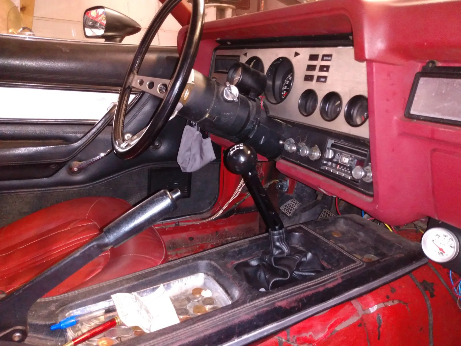

The shifter looks like it's close to the dash and fairly tall. It may be fine depending on your seating position and arm length. If you find yourself reaching too far for 5th Modern Driveline has a shifter for us now. Places the shift lever dead center of opening. I picked up their 6" lever too and it feels pretty close to the stock rad 4 position.

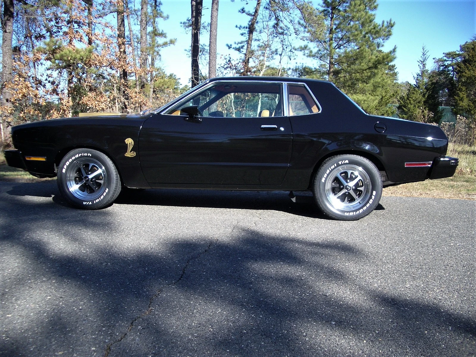

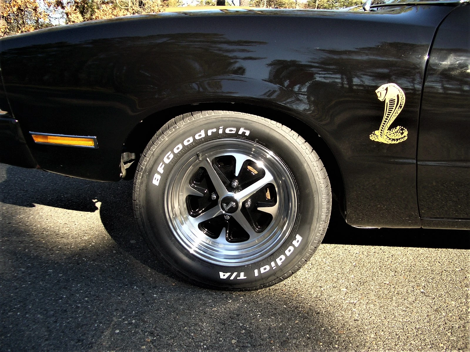

Here is my car when I first installed the trans and shifter. It is a T5 using the modern driveline shifter and lever.
Do you know what front springs are on it? I only ask since it started as a v6 with the manual. It came with fairly light front springs from the factory. My car started as a v6 auto. I used a bunch of aluminum parts, put the battery in the trunk, have the T5/302. I thought the v6 springs would work with the diet I put her on. I have the larger new front sway bar but it's not right. It rides bad, sits too low and doesnt handle like it should. I just picked up coil overs to firm it up and hoping it will ride better. If you find it's wandering or unstable cornering it may need addressed.
