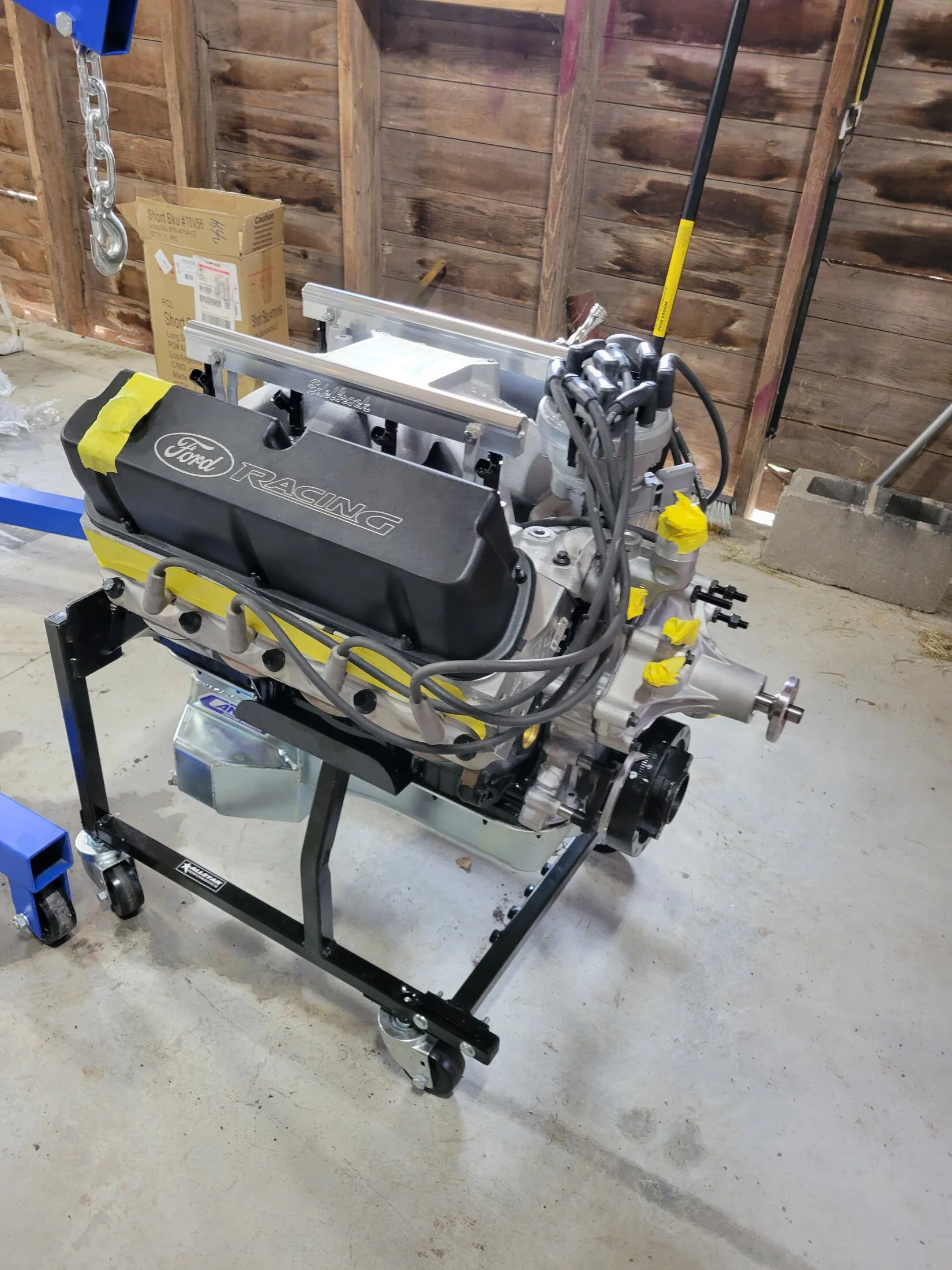

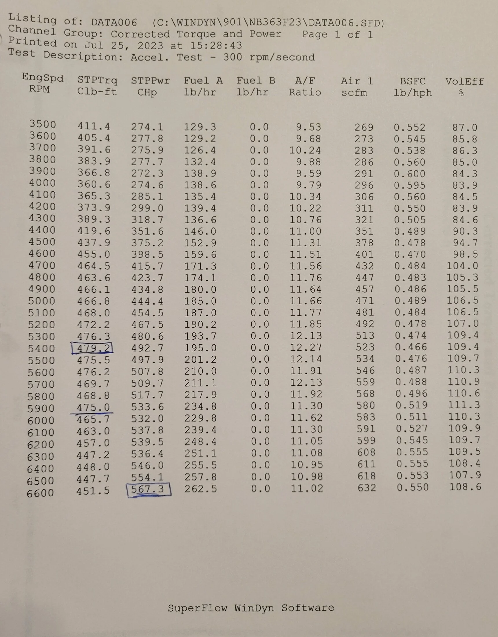

Mark at Vigilante Performance who supplied my pistons per Ed Curtis' recommendation told me he expects I'll make between 500 and 550 flywheel horsepower based on the top end Ed put together for me. It ended up at 10.57:1 compression so I can run 91 octane. I'll be tickled if it makes 500 at the crank. Should hopefully know within 2-3 weeks.Deck looks good man! Sucks about your knee. My 331 made right at 452 fwhp on an engine dyno and carbed. Made around 360 rwhp injected and its a 5 speed car. I think some of the loss is due to the fuel system not being 100% up to the task which it is now and the cold air kit was cobbled together and that is also fixed now. Will not being going back on the dyno until the MSPNP is installed this winter. I am done with having to pay someone to tune it every time I make a change.

Exact same theory applied to the new engine. Almost transferred the 347 assembly and TF170s into a Dart block to save $$$, but realized it'd be silly to do so. Then nice heads lead to bumping to 363 ci, which meant new cam and intake, etc, etc. I even bought a new clutch, flywheel, waterpump and timing cover because I just want it all fresh and clean. I have a lot of slightly used parts to sell off on marketplace. Just wanted it done right the first time.Do it once, do it right!!!
