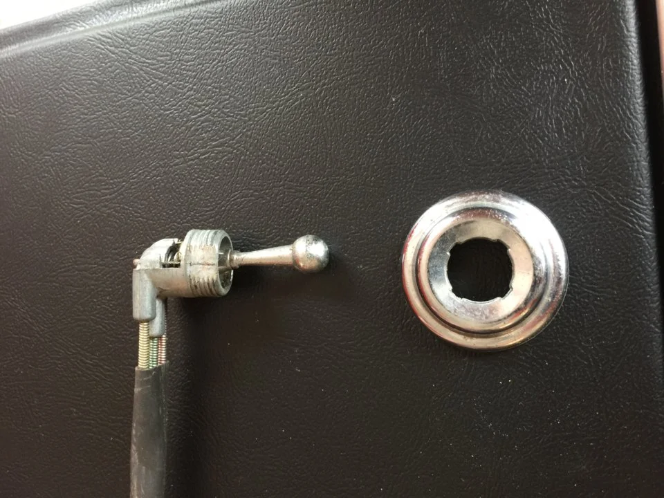

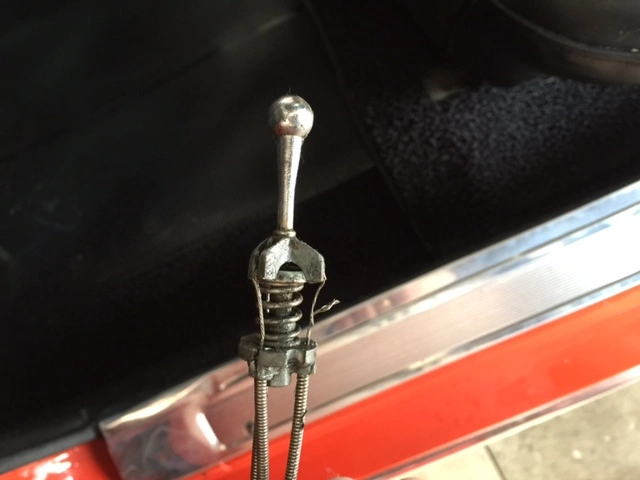

i am down to the final steps of assembly of my 69 and I need help with the drivers side remote mirror. I have two mirrors with two different joy sticks. I purchased both of them years ago from two different people both claiming they were 69. But as you can see they are both different and I don't know which is correct. The first photo looks more correct but has no attaching hardware nor is it threaded to accept a bezel. The second photo is a tight fit and the bezel is to large in diameter to fit the door panel fixture. If someone has a picture of one installed I would appreciate it.
Thanks in advance.
I believe the second one is the one you need, the straight one is for a Deluxe interior . I will have to look at my mirrors ,they are for the deluxe interior .
In addition in the second picture. The joy stick and the bezel are positioned on the door panel of the picture only. The bezel is not mounted in position. If the top,is correct I must be missing parts.
Yep ,you are missing the threaded part .The bezel for the deluxe Mach 1 mirror is a rectangular bezel about 2 1/2 inches long by about 1 1/2 and the toggle comes in parallel with the door panel ,it is kind of a recessed cup .
I have the rectangular piece, but it is not threaded for a bezel. I believe the piece in picture one should have a threaded barrel for the bezel to attach to. Do you agree? And do you know if that piece is available?
It isn't threaded ,the barrel slips through the bezel and a nut threads on to the barrel .There may be a washer that goes on the back side of the bezel as well ,been a while since i took my mirror off. The barrel is not supposed to come off ,i don't have any extras . I have a Torino mirror here somewhere if i can find it but it may be the angled toggle ,i will look tomorrow .
