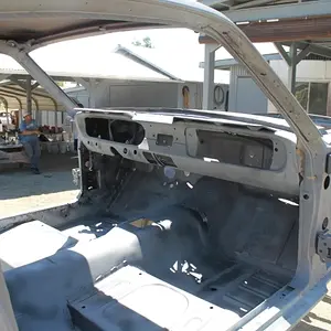

finally in primer.

now comes the primer and sealer. the primer dries to match the original as close as ive ever seen

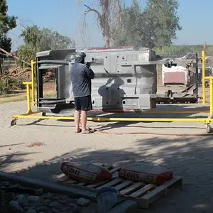

the whole car was sand blasted to remove the black primer. paint wont stick to it

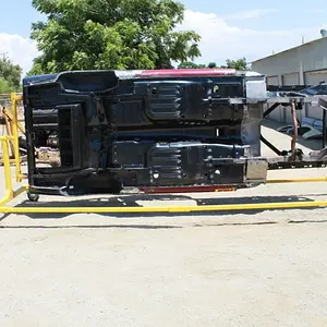

kinda weird to see a car on its top.

once the body was done we put it on the rotiserie in prep for sand blasting

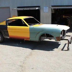

semi roller with all sheet metal mocked up

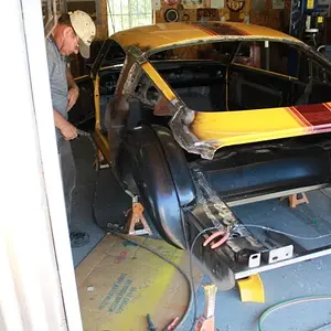

i guess i should show you what it took to put on the new quarters.

the end caps from stang aholics fit the quarters perfectly. no problems

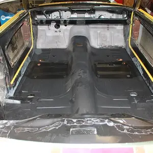

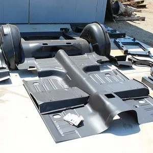

the floor pieces all went in with little or no problem

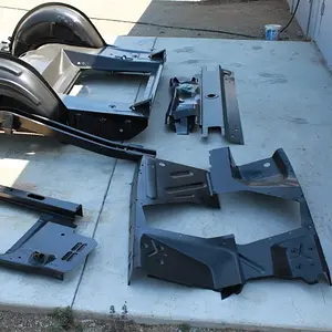

more parts

the next part was the jig saw puzzle that would soon be the new floor assm from the fire wall to the rear tail light panel

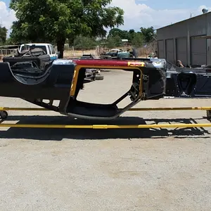

once everything was fitted, the front clip was slid into position on the body. squaring and leveling was the tricky part. its nice to have more than one car around to double check measurements.

when we started looking at the frame and how it was attached the best way to do the deed was to cut and pull the body off of the frame
