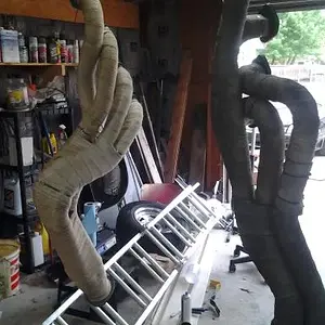

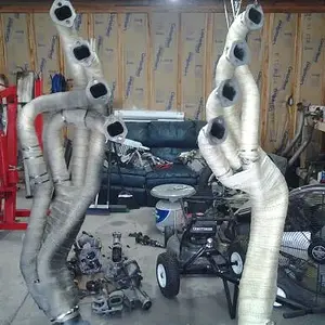

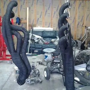

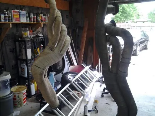

Take your time and use water. And don't use the metal zip strips. Use the bailing wire to tie the ends down. The steel strips look cool but had a Hell of a time getting them tight. After you cut them to be clean they will cut you up next time you do a plug change!!!
