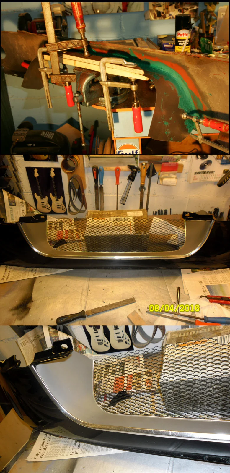

Something like this?
That looks great, as does your whole car! You really have an eye for what works and what doesn't, that's for sure. As for anyone wondering about the front plate legality, I think most cops are beyond that these days. The Shelby front end on my car is plateless, as is my wife's Suburban. We've owned the Suburban for nearly 10 years with no hassles, so I'm not about to clutter up the front end of my car with one. If I get a ticket, I'll do what I have to to get the ticket signed off, then remove it.
