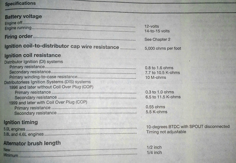

I've read testing the coils with a multimeter isn't a guaranteed way to check for a bad coil but I decided to try it anyhow, the Haynes manual says to check resistance and replace if they don't match the specifications listed but it doesn't give you any range to work with, how far off spec can they be?
|I ask because my results were a bit off from Haynes specs.
The primary resistance ranged from 01.10 ohm to 02.2 ohms (multimeter set @ 200 ohm, its lowest setting) Haynes lists the spec @ 0.55 ohms (?)
Secondary reading ranged from 5.18k ohm to 5.59k ohm, Haynes lists the spec @ 5.5k

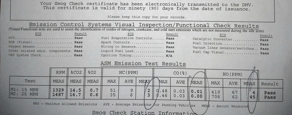

Today I chanced it and attempted to get it Smogged, It passed without any issues the technician even mentioned it running clean in the results, I'm no mechanic so not sure how to really process all of this, when you say it sounds mechanical are you talking internal engine problems (more serious?) or something else, The whole time it was in the shop running through the tests It sounded fine except for a random but quiet "pup" sound coming from the exhaust when it was idling, Thanks again.
