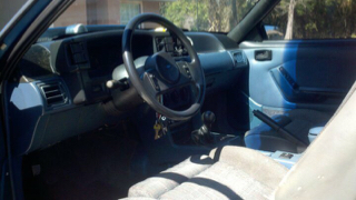

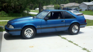

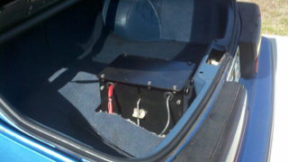

Have any of you had any success using the sem or the interior paint from lmr to change interior colors? Just picked up a clean roller that's nice but I can't stand the blue interior. Would love to go grey. I know I'm out of luck for the headliner , carpet and door panels but I'm wondering how it would work on everything else.
SEM interior dye works ok. It is not a perfect match. You must use the prep/promoter spray and make sure all surfaces are clean. You can actually use it on the carpet and carpet on the door panels. LMRS. Summit, Ebay and AM have them.
