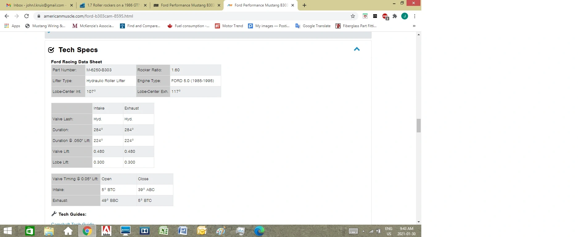

Yes you should be fine a b cam only has .444 lift w 1.6 rockers. With 1.7 it will increase only a little. The limit is about .544
No that is incorrect. Stock cam is .444 with 1.6 rockers, .472 with 1.7s. B cam is .480 with 1.6 rockers and .510 with 1.7s.
From the specs on the B-cam shown on American Muscle website
Based on the valve timing info, I would say install it straight up (not advanced on multi keyed timing set) and you should have no problem (with 1.6 or 1.7 rockers).
Why... The above says intake starts to open at 5 deg. before TDC and exhaust closed at the same time. Basically when the piston hits top they are essential closed. Would be no interference there. The more advanced the cam gets installed the greater the chance intake valve has opened too much when piston gets to top that would cause interference.
