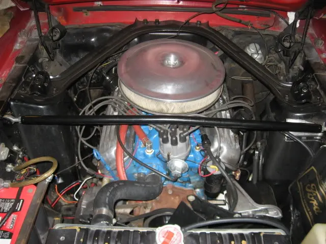

Hello everyone! New to website. Could someone please tell me where the temp sensor is located on the 289 engine and what color wire runs to the gauge. I have looked and do not see the sensor or any loose wires. Could it be located on the left head under the a/c compressor? Thanks! Granny
The temp sensor is next to, almost under, the distributor.
Right in the center of this photo:

According to file '1965g.jpg' your temp sensor wire should be red w/white stripe, there is a 90* elbow on the end.
You can see mine ('67 289) in this pic, it's gold (brass) and just below the inline black fuel filter and just right of the dist. in the pic:

I don't know I could miss that. It is right behind the dist. looking toward the rear of the car. It is pretty small and I just missed it. Thanks for your help. Granny
