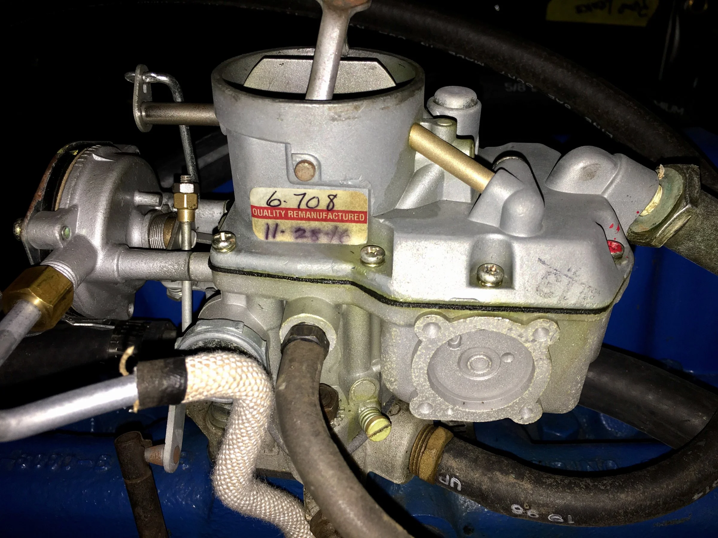

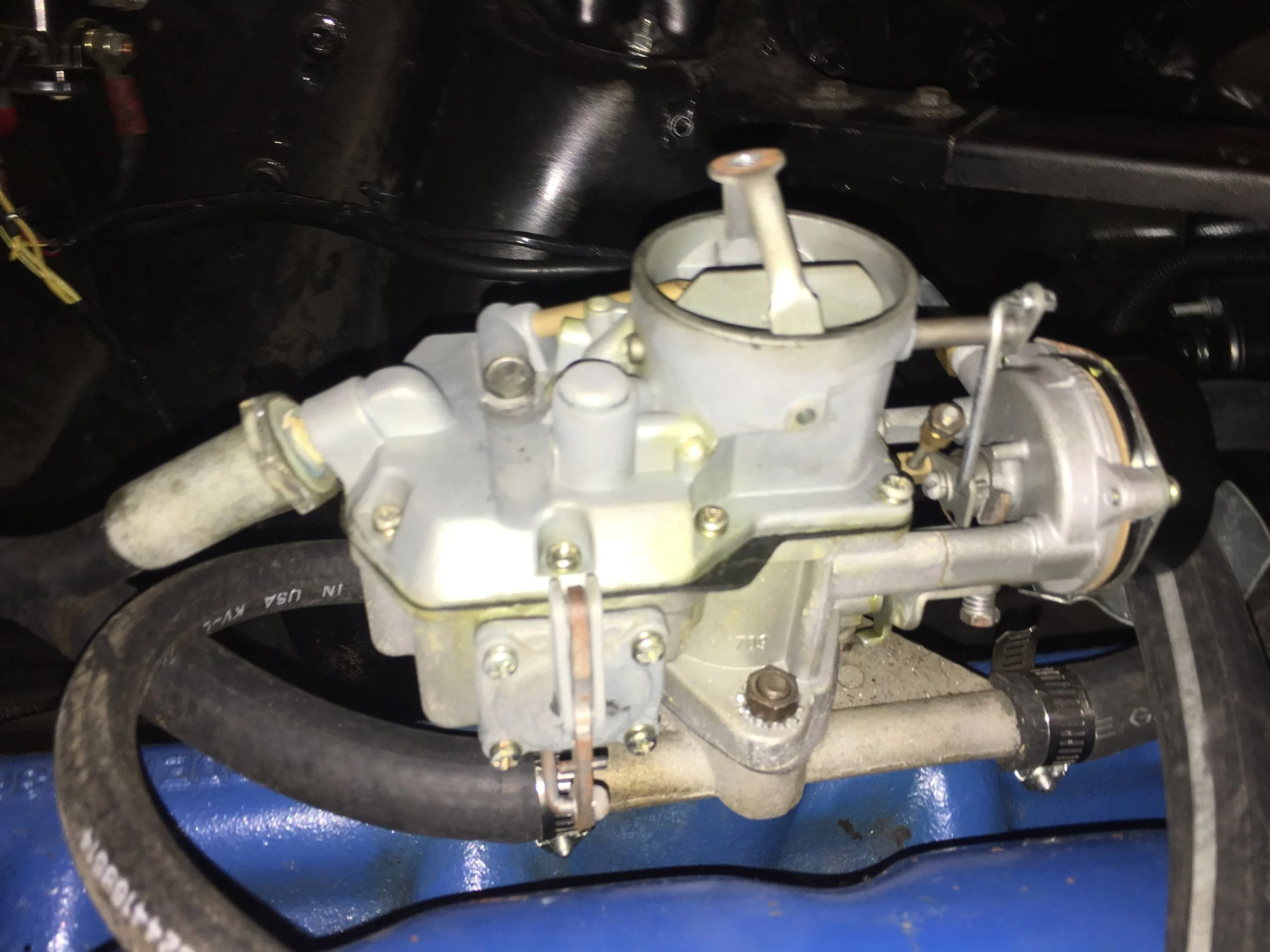

My friend has a 1966 200 6 cylinder with the single barrel carburetor on it. I'm trying to identify what model it is...it's remanufactured. Can someone help please?

looks like an autolite 1100 carb. there should be a number stamped on the side of the carb somewhere though, probably on the base plate, that has a ford part number on it.
Thankyou yep that's it. Set timing set mixture purring good went out got gas coming up to my house got on it to listen for knocks under load stalled wouldn't start again for an hour 90!degrees out. Cooled off fired right back up, when it was hot would turn key it would fire and stall fire and stall. Choke open. Newly remanufactured carb 2016 on fresh rebuild 200. Man restored car put new manifold andsaid carb on that's it.
