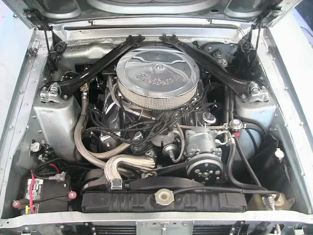

I have a 1967 Mustang Coupe with a 289, automatic, power steering, power brakes (drums all around), classic auto air in dash A/C, black interior, and painted "Silver Smoke Grey".
The 289 has: bored 30 over, dual plane highrise aluminum intake (not sure of the manufacturer), hooker long tube headers, Edelbrock 600 cfm carb, some kind of cam (previous owner rebuilt engine), stock heads, aluminum water pump with 6 blade fan. The car originally had a 289 2V, automatic, power steering, and dual master cylinder drum brakes, black interior and was painted "Springtime yellow".

The main problem I'm having is the 289, I get 13 mpg (when I drive it carefully, 10 when I drive it normally) and it runs like crap, acceleration is is good but taking off normally sucks, it spits and sputters. I have cleaned the carb, replaced the distributor (still running points), coil, plugs, and spark plug wires (plugs and points were set according to specs).

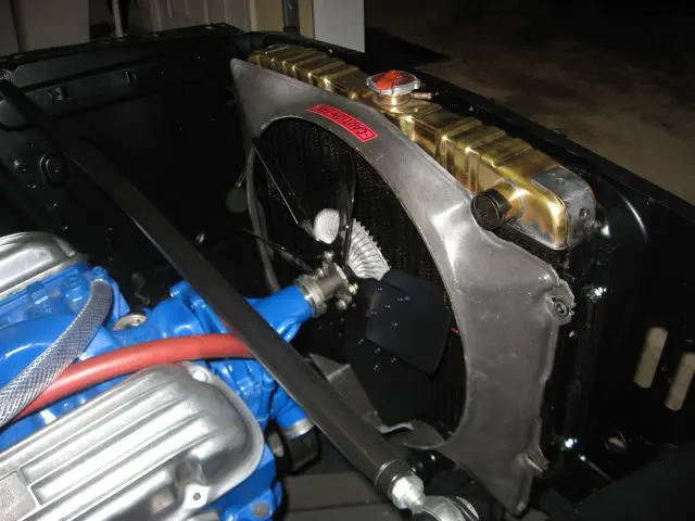

It runs hot even with a 6 blade fan and fan shroud, hot meaning 195 while driving with the a/c on but quickly jumps to 210-225 when idling. These temps were taken from a Sunpro temp gauge.
Once its warmed up, if you kill it and let it set for 15-20 mins, it is very difficult to start. I have installed a fuel pressure regulator that is set to 6 psi, reset the floats in the carb, and installed a spacer between the carb and the intake to keep the carb cool and prevent boil over. None of this has fixed the problem.

Fstbk-the water pump is the correct one. I just have a radiator that isn't meant for cars with a/c.

GO ahead and install that points conversion, it is one of the single best bang for your buck additions you can do. I noticed a night and day difference in the throttle response on my 289, it was doing the same thing. Also, timing, jetting, get rid of that crappy 2 row radiator and get a 3 row copper or 2 row aluminum radiator and put in there and that should take care of your cooling problem.
The above statement is correct!
the problem your having is once you stop moving forward your not getting much movement through the radiator to cool off the water/antifreeze. you need to upgrade to a larger aluminum radiator with at least 3 rows.

If you open the cap to the rad. (cold of course) you can count the rows of tubes running front>back (2,3) in the top of the rad. if the fluid's clear or you may need to bleed a little off. I swapped out my stock nonAC 20" '67 rad. with a '68 AC 24" wide 3+ row from NPD. The '68 one comes with the correct right upper/lower hose inlet/outlet and fits your rad. opening with the spacer plates removed. I fabbed my own side mounts out of alum. flat stock as I didn't want to buy the up/low mounts for the '68 and like the cleaner look of no upper mount. I also liked the look of the bare top tank once i stripped it for repaint so I polished/clear coated it.

I'm working on getting a new radiator atm. My dad is going to check the local radiator shops for pricing otherwise I will order the champion cooling systems from MU, its only $20 more than the 3 core brass/copper one they have.

Actually, everybody had that radiator in 67. 390 cars were equipped with a 23" radiator, but everybody else got the 20". If you had AC, they added a 20" fan shroud and upgraded the fan.
