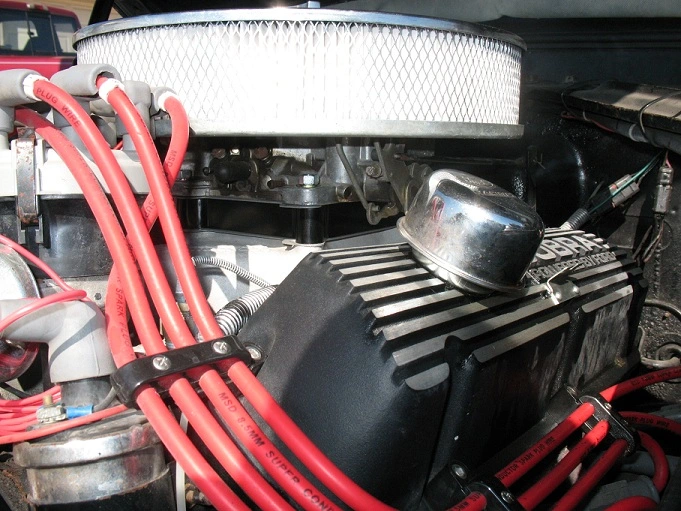

I have a Performer 289 intake on the 302 in my 67's with a matching carb. I have a 1' carb spacer (Phenolic) with an air cleaner that's probably 2-3" tall and I don't have any clearance issues. I'll go take a picture real quick and post it. I would make sure to use a phenolic spacer to keep your carb cool.
Here is a picture.
I'd look at getting a different air cleaner. The bottom part of mine is dished in, so the how assembly sits low. My air cleaner is the $15 chrome deal you get at Kragen Auto Parts or something similar.
Here is a picture.
