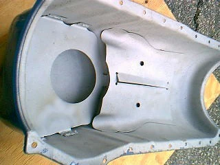

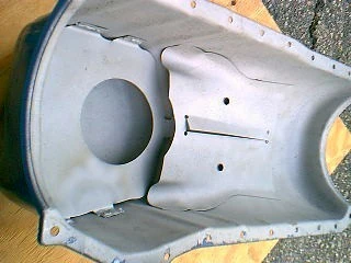

I found boss351registry.com which seems to have a good collection of pics and info. I can't help noting the internal difference between the oil pan pictured on that website and the one shown for auction:
boss351registry:
eBay auction:
