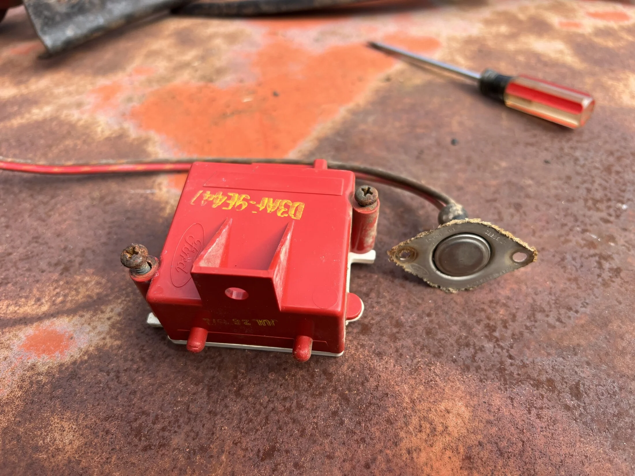

Oldkckr41 Member Sep 4, 2016 39 6 18 Cadet missouri Sep 17, 2023 #1 Sep 17, 2023 #1 Could anyone Identify this for me? Right side under fender at outer door post

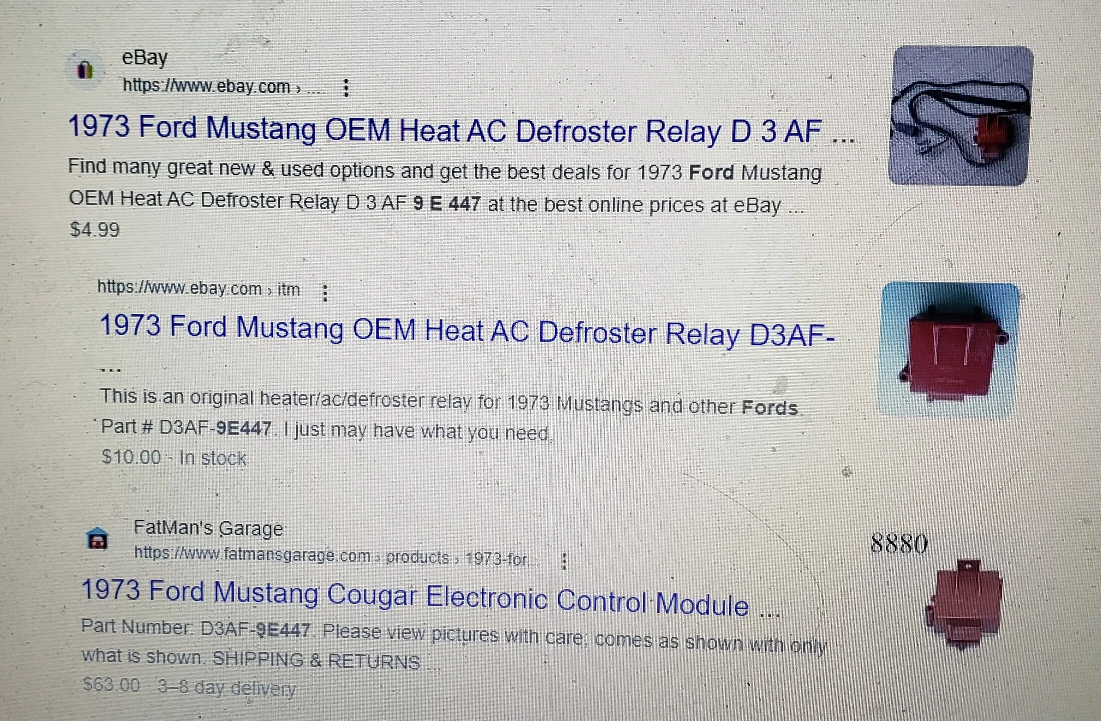

manicmechanic007 5 Year Member Sep 26, 2017 2,534 714 143 Roy, Utah Sep 18, 2023 #2 Sep 18, 2023 #2 Looks like they are calling it a A/C - heater -defrost relay Attachments AC defrost relay.webp 839.3 KB · Views: 103 Reactions: 2Blue2 and Oldkckr41

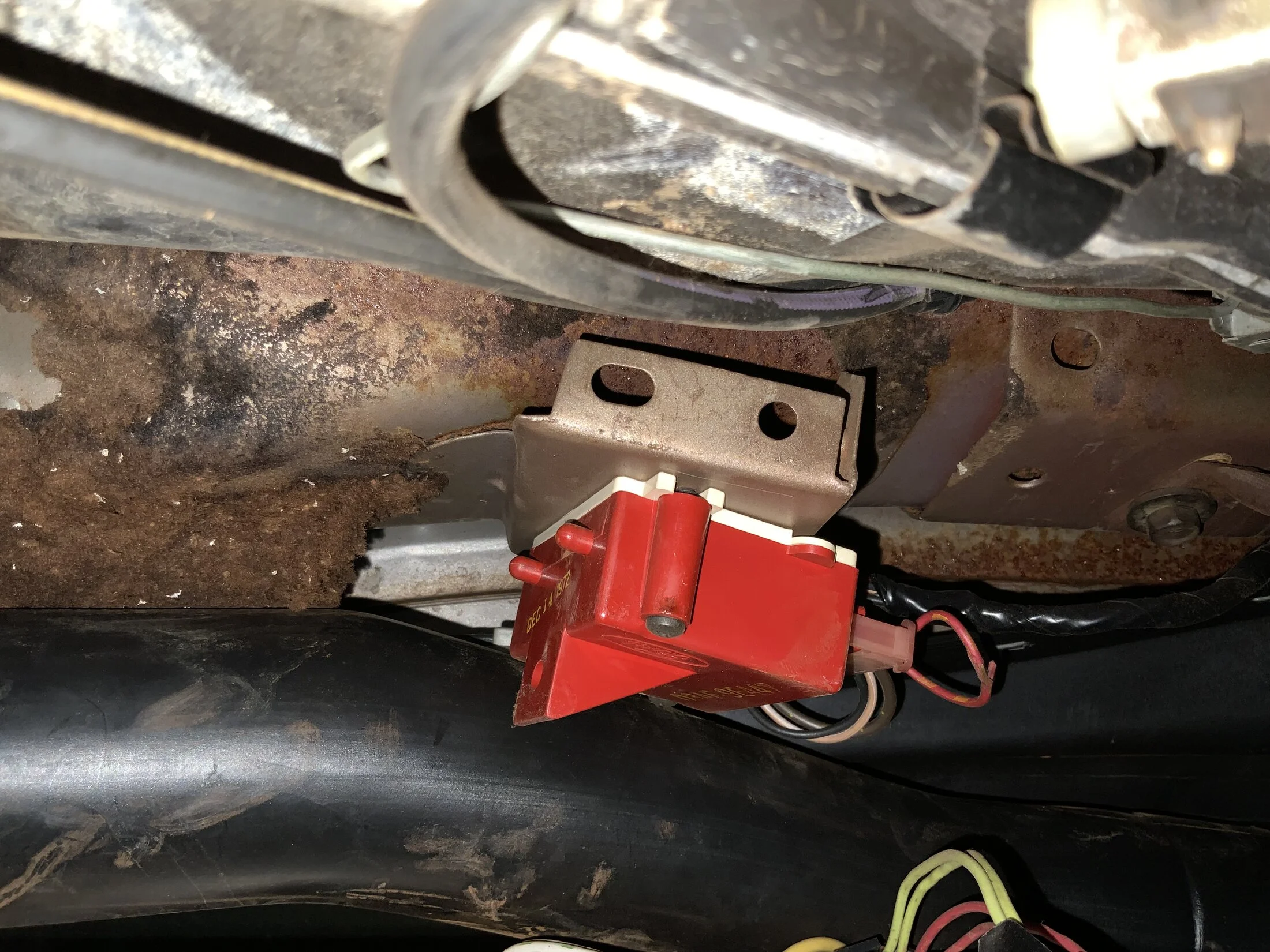

Mcmahst 5 Year Member Jan 19, 2021 681 267 83 Laguna Woods CA, fort Mohave AZ Oct 4, 2023 #3 Oct 4, 2023 #3 No, that’s part of the emission control system, used on 351 cars. The sensor pictured was an air, ambient temp sensor. Ypu can find it in the Ford Service Manual, Emission systems chapter. Heres a pic of mine on my 73:
