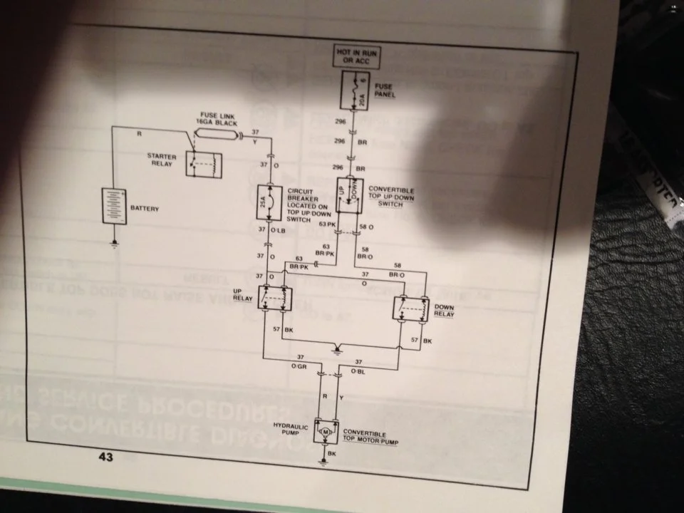

There is a circuit breaker in the circuit somewhere, but it's in different places depending on the model year. The manual says it's located with the up down switch but it wasn't on mine (a 90'). I never did find where the breaker was on mine, but that's because it wasn't my problem.
What you describe with clicking relays is exactly what I experienced with mine, and it was my motor that was the problem. But since you tried a good motor, that doesn't seem to be it for you. To troubleshoot the circuit just move from front to back and check that you have power getting to the up/down switch. Then that you have power leaving it when it's been tripped. Then that you have power going into the relays (which it sounds like you do at least from the up down switch), and then leaving them going to the motor. If you have power going to the motor and it doesn't work, then it's the motor. Keep in mind that the relays have 2 inputs, and one output to the motor. One of those inputs should always be hot. The other one will only be hot when you hit the up down switch. It trips the relay, which then should power the motor.
Here's a picture of the top motor circuit. Sorry for the crappy image, but as you can see it's pretty pretty simple. Good luck..

The diagram that virtual posted shoes a fusible link to the circuit breaker. If that fuse is bad will it give me what i am experiencing? I have searched the engine bay to no avail. If it is under the dash, I guess I will have a manual top for a while...dread tearing into the dash!
I will try retesting the motor again...maybe I fried it when I tested it the first time.
Thanks for the info everyone, and the diagram.

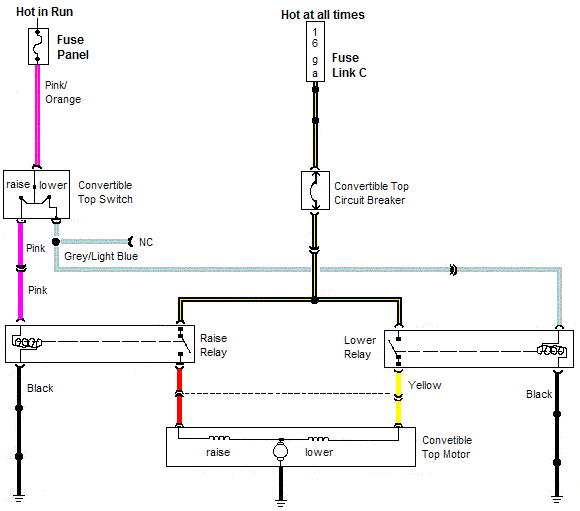

Typically the fuse links are in the wiring attached to the battery side of the starter solenoid. Some items use a circuit breaker located at the starter solenoid.
Diagrams courtesy of Tmoss & Stang&2birds
Notice that the control wiring for the relays and switches is separate from the motor power. Therefore you could have power to the relays but no power to the motor. As suggested by billison, use a test light to determine if you actually have power at the motor. If not, keep backtracking until you have checked the circuit breaker and fuse link.
The fuse link will probably be 16 gauge orange or black. Use caution, since there my be other devices that use the same color fuse links.
