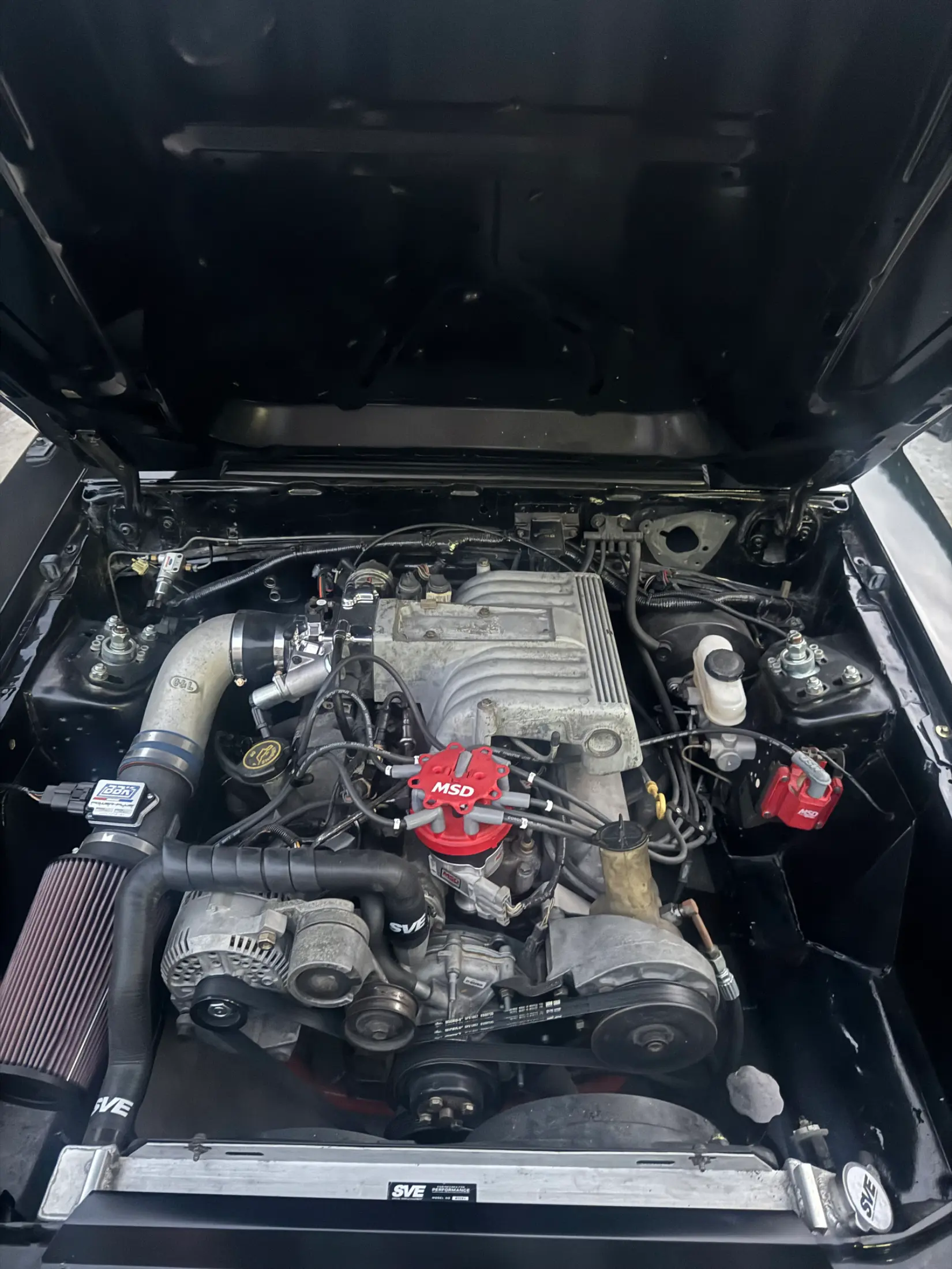

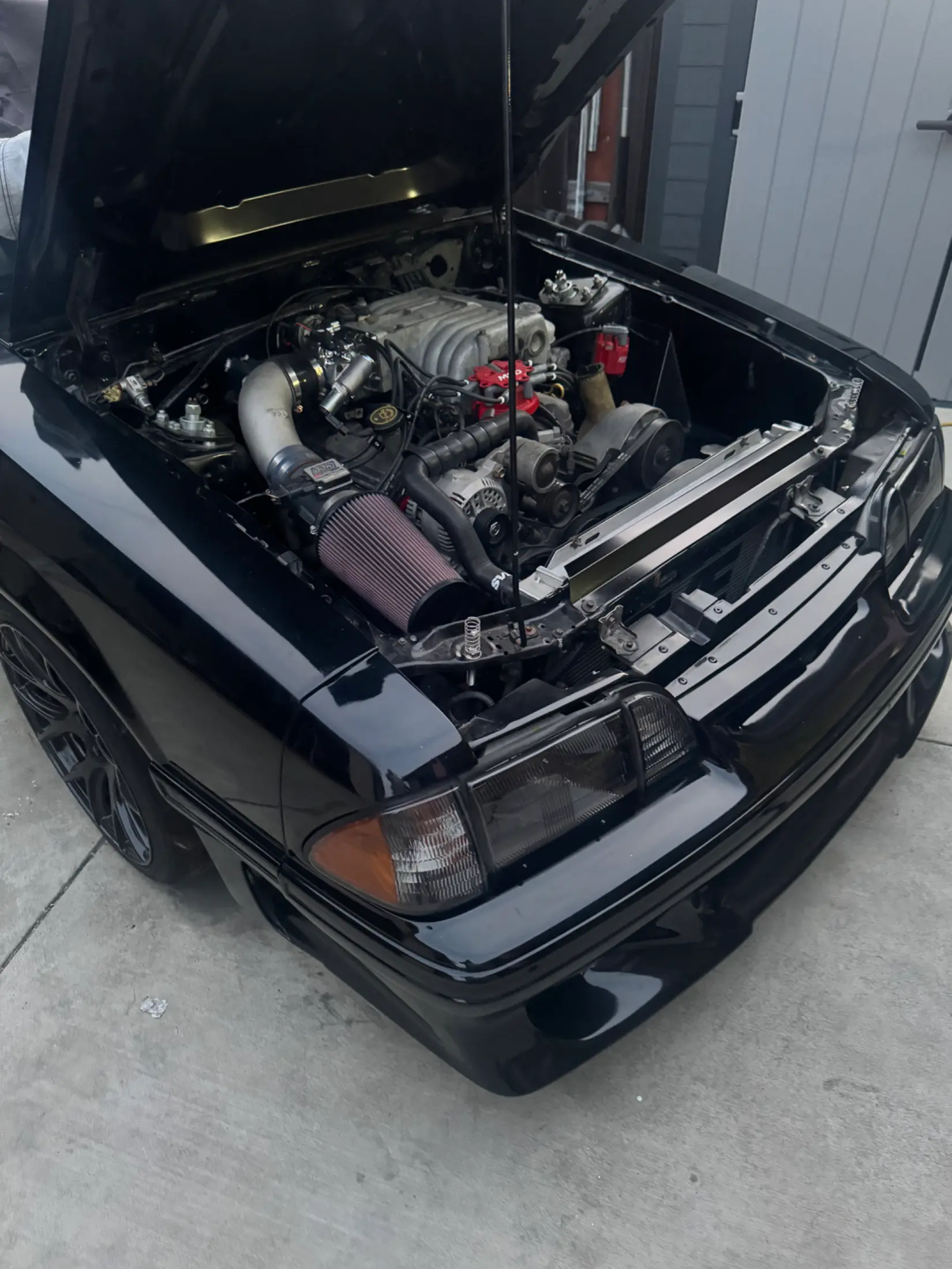

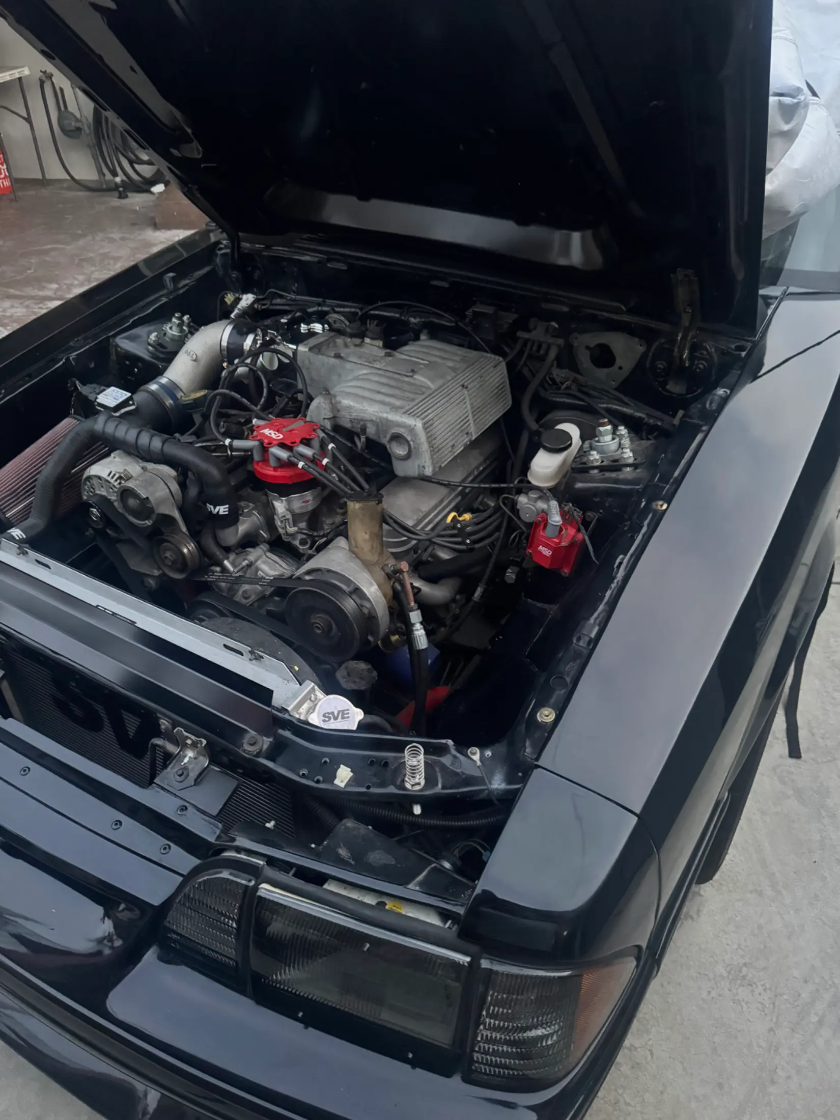

Hello everyone, I’m looking for some help or advice with my Foxbody. I’m having an issue with the idle—it’s idling too high when the clutch is disengaged, and it drops back down when I press the clutch in. The car doesn’t have any major modifications: E-cam, GT40 intake, BBK mass airflow, and a 70mm Accufab throttle body.

WHat is the car? What year/model so we know what wiring we are dealing with? WHat transmission was it originally equipped with? These are important because there are wiring nuances between the cars that will affect how it runs

1988 mustang gt 5.0 convertible, T5 trans is what the car came. The only thing I changed was dash fuse panel harness from 1989 5.0. When unplugging IAC falls to 0, car shuts off.

Is the car an original mass air car or was this added? Just asking because most 88's are speed density except California cars and I see you are in California.
What size is the BBK mass air meter and what size injectors is it set up for and what size injectors are you running?
Can you elaborate more on the "fuse panel harness from an 89 5.0"? Do you mean you swapped out the whole dash harness? Depending on your answer here there may be more questions.
