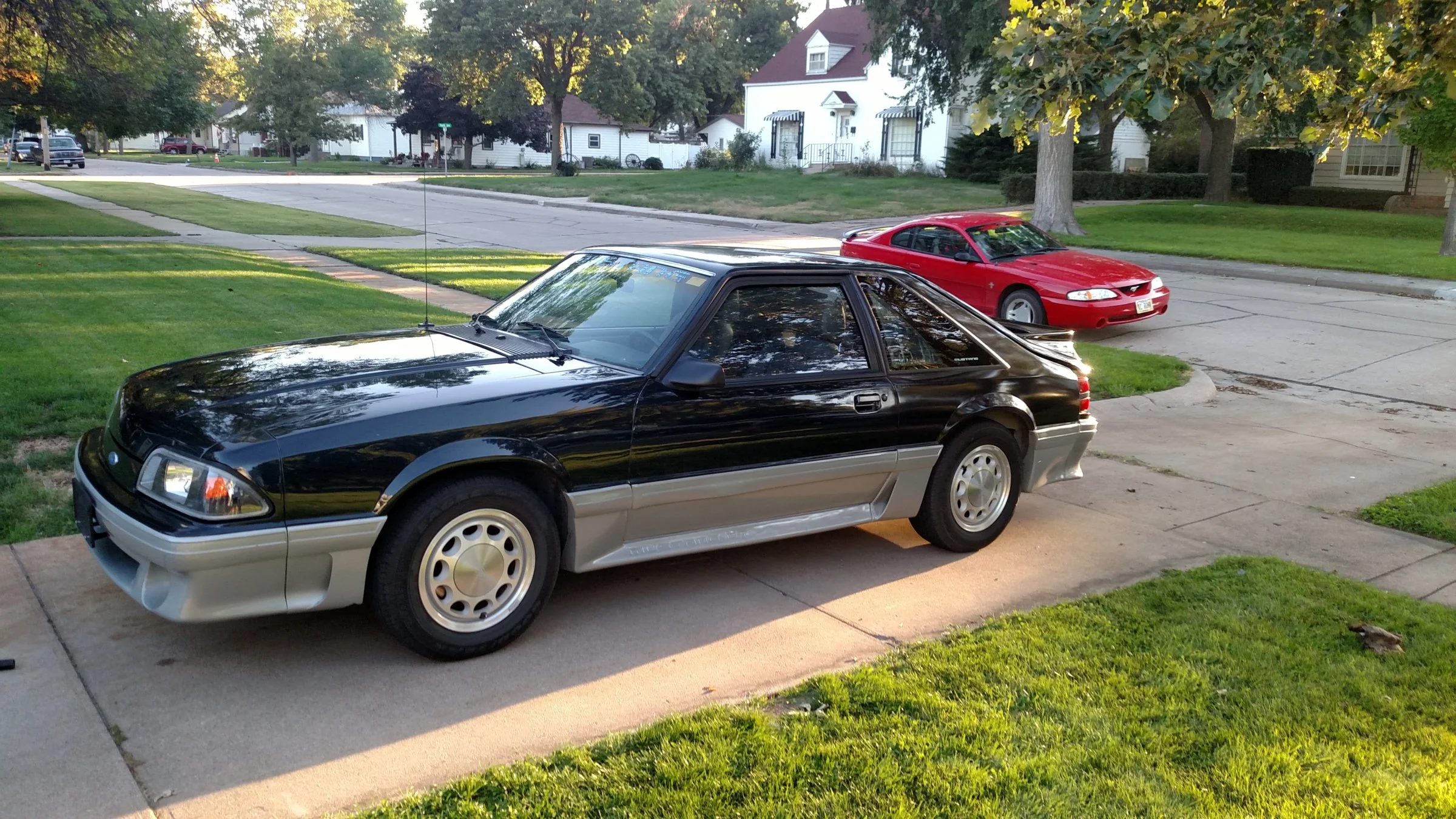

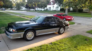

IMG_20160918_184749813.webp Here is a picture.I'll pull the codes,see what it says and report back.
