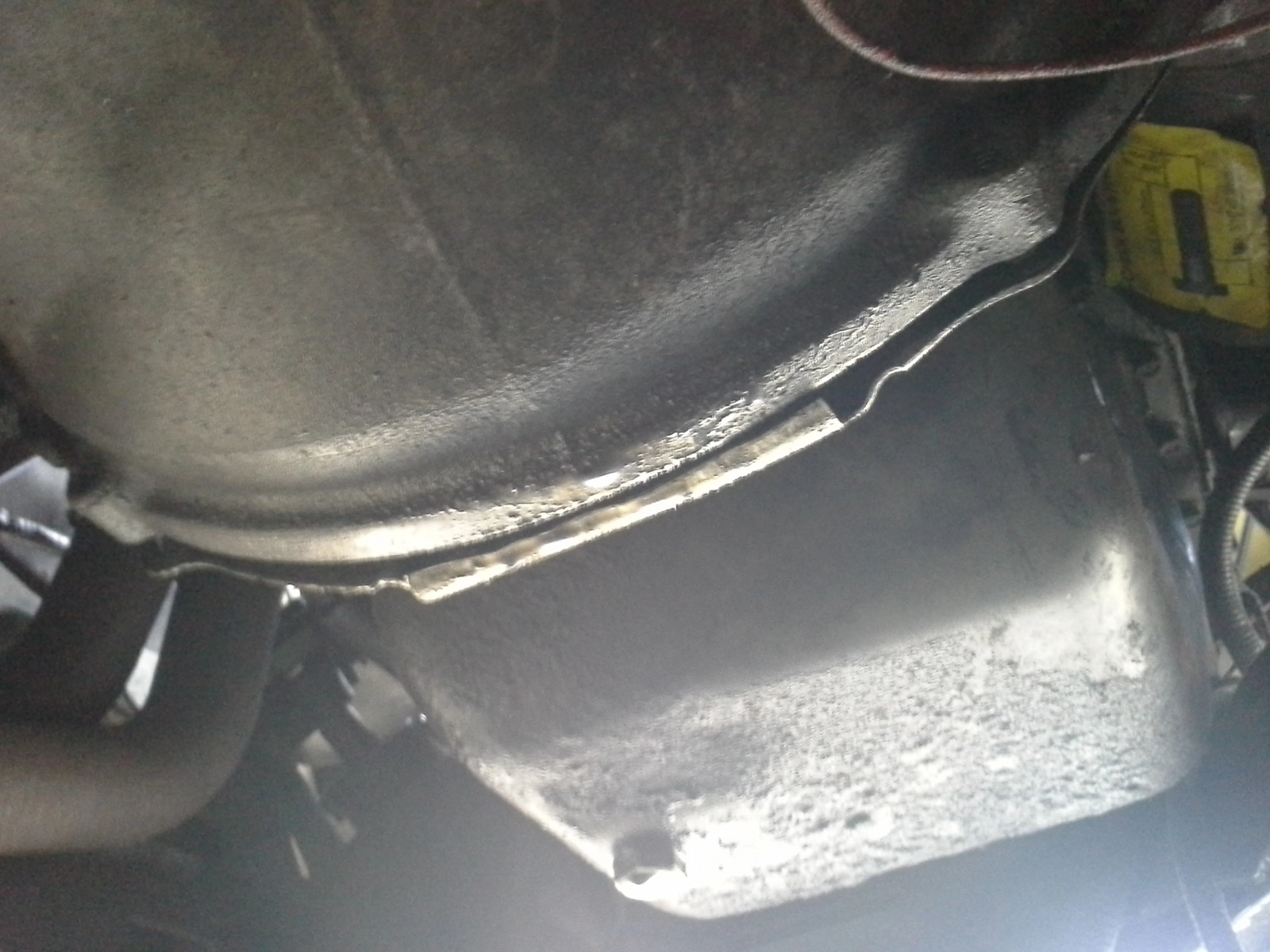

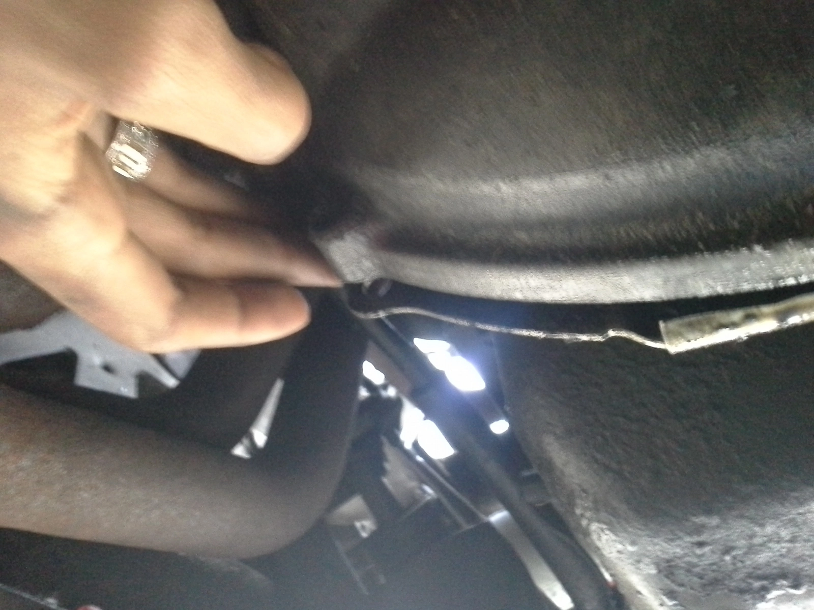

Ok I went and got me some jack stands and went to work the first thing I tried was getting the heads off on the passenger side of the engine...major fail I couldn't get the socket around a few of the bolts and Tryin to wrench them off just warped it..so after fighting wit it I finally managed to tighten the top bolt tht was loose on the starter =_= or so I thought..so I tried starting the car back up and it fired rite up without making the whirling noise so I drove it around the block went back and parked it jumped back in it went back to start it and it made the noise Again..so I let it cool off come to find out the bolt was loose again..maybe I didn't tighten it Gud or maybe something is wrong wit the flywheel..anyway I got some pics

A guy told me I might have a rear main seal leak I looked up under and it looked like I gotta slow leak from the oil pan also Im Missin bolts from this whatever it's called....ino I need help..

I kept having problems with my starter bolts backing out on me as well, so I finally just got some longer bolts, and put a nut on the back of them with some thread lock. I havnt had a problem with my starter since...
