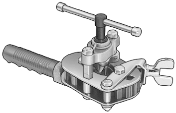

14. AN fittings require a 37 degree flaring tool. A standard automotive or household plumbing tool is 45 degrees and cannot be used with AN flare fittings. If you do, the flare is subjected to too much stress when the fitting is tightened, and is likely to fail or leak.
15. See MSC Industrial Supply Co. | Find Power Tools, Hand Tools, Machine Tools & More , McMaster-Carr or for the flaring tool you will need . Prices start at $85 and go up

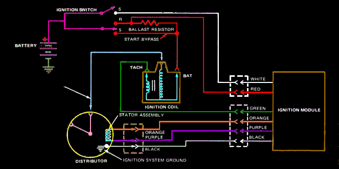

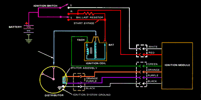

21. While you are at the electrical part, you'll need a Duraspark or similar ignition system. The 85 Mustang GT 5 speed has a suitable Duraspark distributor with a steel gear compatible with the roller camshaft. The EFI ignition depends on the EFI sensors to advance the spark. Rip out the TPS and MAP/Baro sensors and the computer will have no idea of the proper ignition timing for best performance. Running a fixed timing setting is only for test purposes or for a race track only car. Don't try it on the street: the results will not be nearly as good as a properly setup Duraspark or equal. Crane makes a really nice distributor for non-EFI applications. . See Crane Cams | Automotive Home Page for more information. Cost is about $400, which makes the 85 Mustang reman units look really appealing.
Duraspark II ignition diagram:
Diagram courtesy of /Murals and Fine Art by Bill Wrigley
See Duraspark II for more help.
Note the ballast resistor shown in the diagram: you’ll need that too
If you use a coil from a 78 or later Mustang, you don't need the ballast resistor. The stock 89 Ford/Mustang ignition coil does not need a ballast resistor
