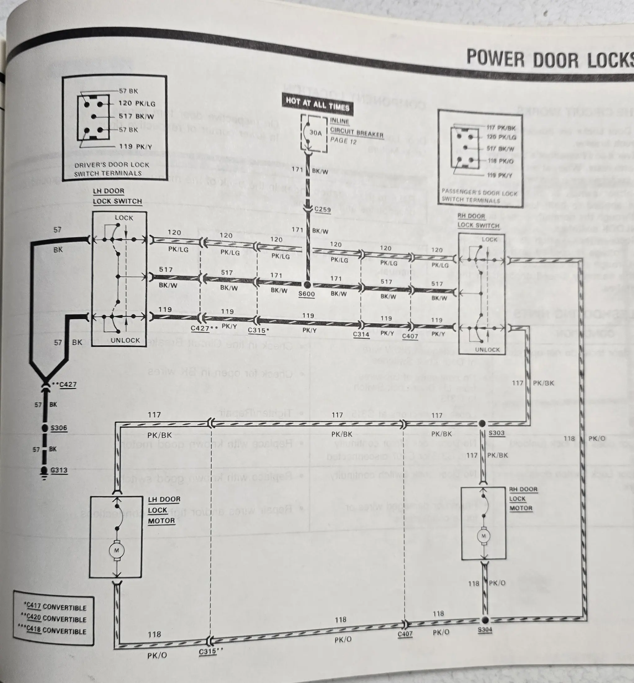

Here are some troubleshooting hints and a schematic out of the 89 mustang EVTM
