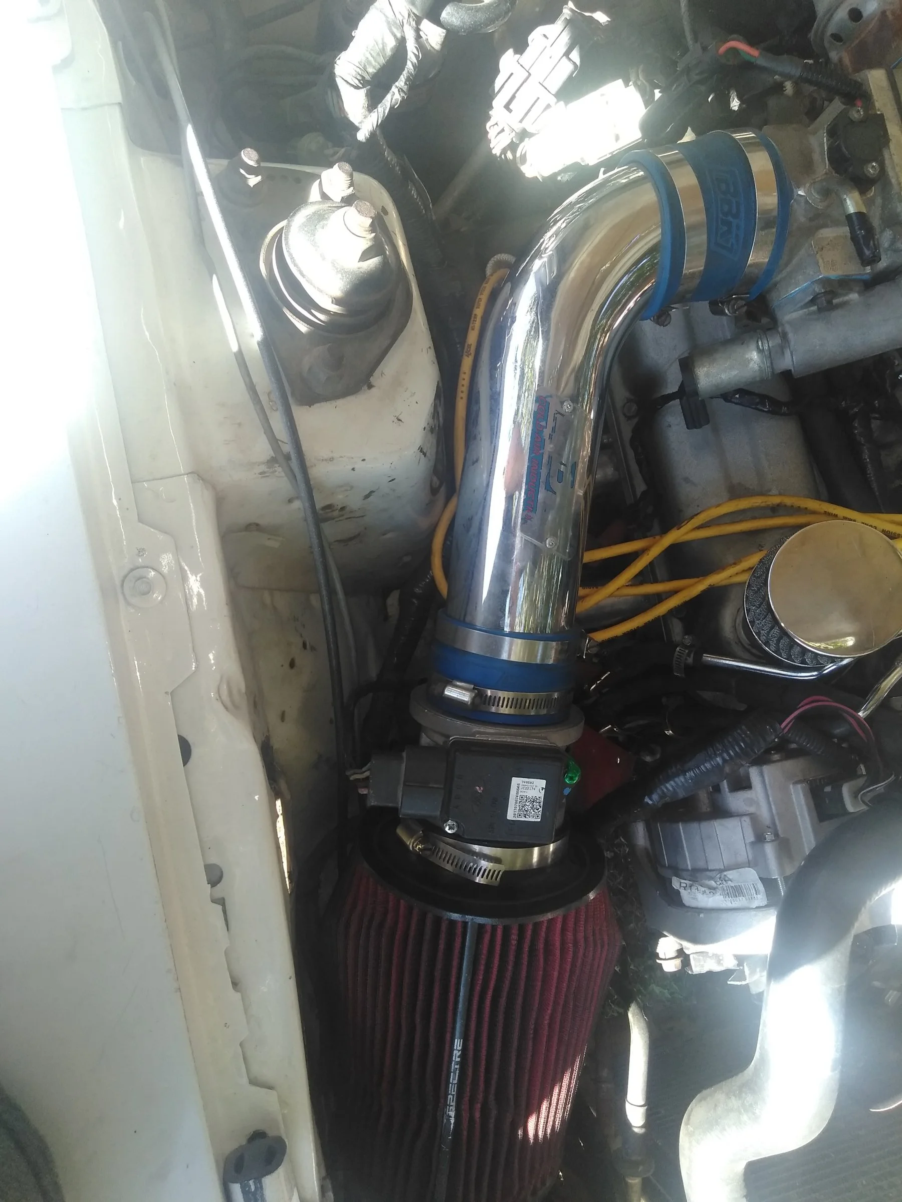

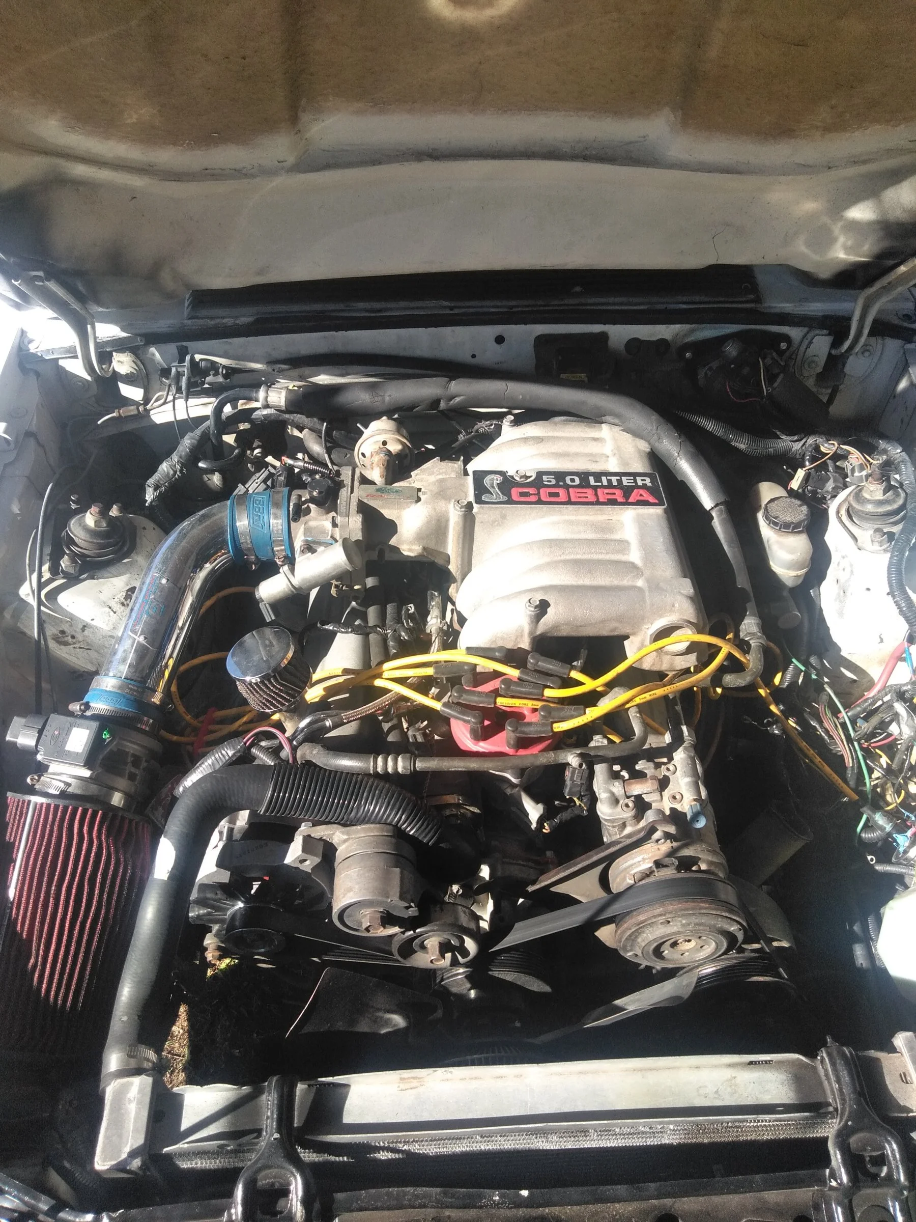

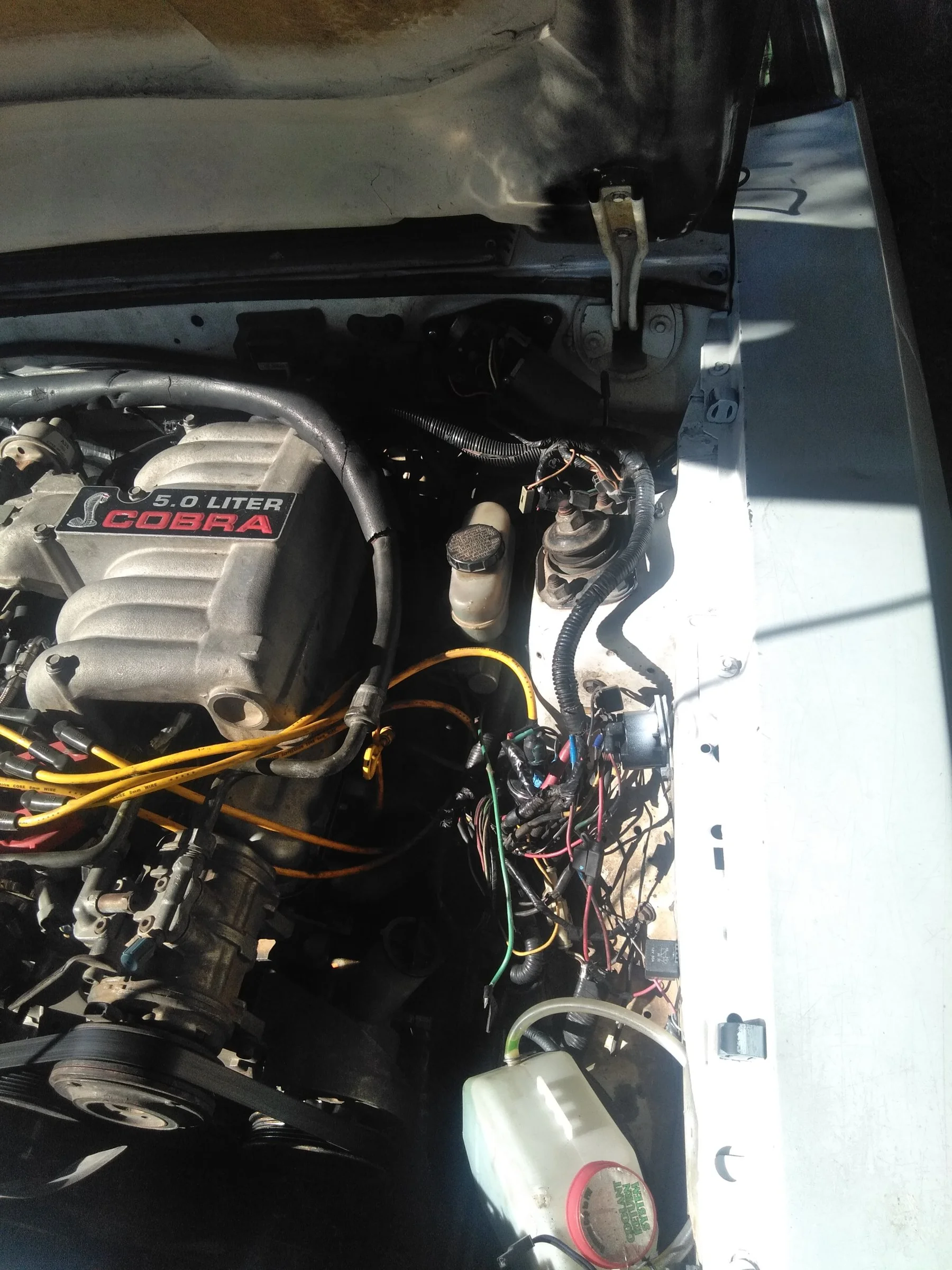

Thats a big azz fuel line there. Also need to reconfigure that hot air intake, and get rid of that breather on the valve cover, make sure your pcv system is functional.
Fuel pressure is a little high, should be 40-42 lbs koeo and 32-34 koer at idle.
What codes have you got
I would guess you have the battery in the back
Reactions: Whitecobrafox13
Didn't ever think about the fuel line honestly. Could an over sized fuel line cause an issue? I can't think of any way it could. I have been wrong before though. Do you know the correct routing of the pcv system? Would be very helpful. And I'm waiting on my battery to charge. Apparently a new symptom has arrived. Parasitic draw. Will be trouble shooting this while trying to watch these replies and give replies back.
I don't think the bigger fuel line is your problem, but I've been wrong before too.

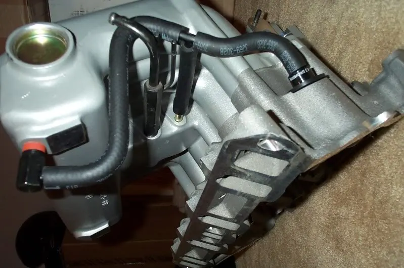

stock manifold routing
You don't necessarily need the hose from the bottom of plenum to the t, just the tree to pcv valve, there is also a screen below the pcv valve.

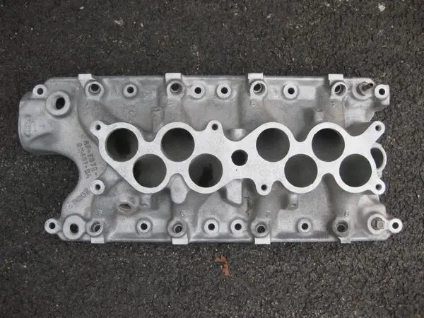

The car must either be of Canadian origin or someone put a cobra cover plate on a stock intake manifold. How do I know? The ports for a Cobra/Explorer/GT40 lower intake are in a zigzag pattern, not a straight line.
Picture of the Cobra/Explorer/GT40 lower intake.
There must have been a BOZO complete with red nose, frizzy bushy hair and big floppy shoes with a wrench working on your car. There are a bunch of emission related code in your code dump in an attempt to make the car faster. It doesn't work that way: all that happens is that the car doesn't perform properly and it makes the computer spit a bunch of codes.

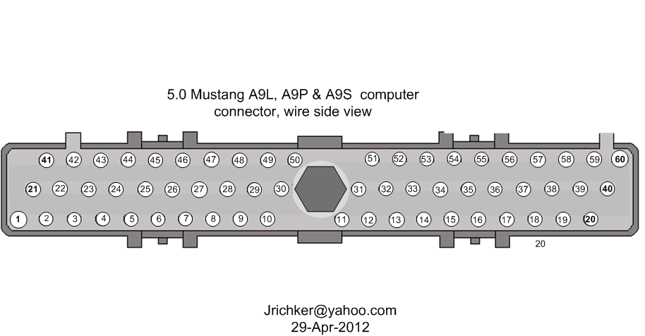

You have 3 codes that are high out of range sensor; codes 23, 34, and 51. This is an indicator of problems with the 10 pin connector or the engine mounted wiring harness.
See the graphic for the 10 pin connector circuit layout.

The NSS code 67 can be bypassed for testing. You will need to temporarily ground computer pin 30 to the chassis. Computer pin 30 uses a Lt blue/yellow wire. Remove the passenger side kick panel and then remove the plastic cover from the computer wiring connector. Use a safety pin to probe the connector from the rear. Jumper the safety pin to the ground near the computer.
Be sure to remove the jumper BEFORE attempting to drive the car!!!
a9x-series-computer-connector-wire-side-view-gif.71316

If you disconnected the carbon canister and failed to properly cap the vacuum line coming from under the upper intake manifold, you will have problems. You will also have problems if the remaining hose coming from under the upper intake manifold or caps for the vacuum line are sucking air.
Charcoal canister plumbing - one 3/8" tube from the bottom of the upper manifold to the rubber hose. Rubber hose connects to one side of the canister solenoid valve. Other side of the solenoid valve connects to one side of the canister. The other side of the canister connects to a rubber hose that connects to a line that goes all the way back to the gas tank. There is an electrical connector coming from the passenger side injector harness near #1 injector that plugs into the canister solenoid valve. It's purpose is to vent the gas tank. The solenoid valve opens at cruse to provide some extra fuel. The canister is normally mounted on the passenger side frame rail near the smog pump pulley.
Connecting the gas tank vent line directly to the intake manifold will result in fuel vapor being constantly sucked into the intake manifold. There is unmetered fuel that the computer cannot adjust for. The result is poor idle and poor fuel economy.

Pull the codes again. The inability the pull then is a clue as well to some underlying electrical issues.
Run the codes with the clutch pedal pushed in. That should clear a code 67 in case the trans NGS is damaged or not hooked up. Then you should be able to start the engine after pulling the KoEO and CM codes and run the KOER codes.
Check your grounds. The coil arcing to the fender makes me wonder if your engine ground (firewall and to battery) is in poor shape.
Where would these grounds be. I was pretty sure I went through them all. But only what I could find. Again. I've been wrong before. (quite often. Fabricator isn't exactly the same as mechanic lol. ) but I try hard to be a mechanic and love every second tinkering on this car
Alrighty guys. I think I've found and fixed the problems. 4 issues remedied.
1. Probably the biggest problem. The two wires on the fender well, below the firewall tethered to one large eyelet. That I had spliced together. (rebuilt harness in a hurry. Forgot to crimp them) had come lose from driving. (both black one a hair bigger than the other).
Now car would start but was still stumbling over itself.
2. The brand spanking new tps was registering high closed throttle voltage. (just happened to notice that the original that I had replaced and set base idle on had a different number inside the pigtail connector) called the partshouse to see if they could replace it since they had evidently not given the right one. Upon calling was told that there was several different tps's available for that vehicle. I give them the old number and then the new tps sensor. I was told that the different tps sensors are all the same physically but read differently based on what engine trans model you have and smog needs. Because the car was a Cali car and here in Texas they sold me a Texas smog needs tps. (so they say. I have no knowledge whether he knows what he's talking about or just pulling my leg) after replacing with oem parts number tps runs almost perfect.
3. Fuel pump ground was almost rotted into.
4. New iac isn't functioning correctly. Will get another one and report back.
I only have a mild stumble now. When instant heavy throttle is applied (goosing it) it hesitates for a split second and then revs.
Thanks for all your help guys
