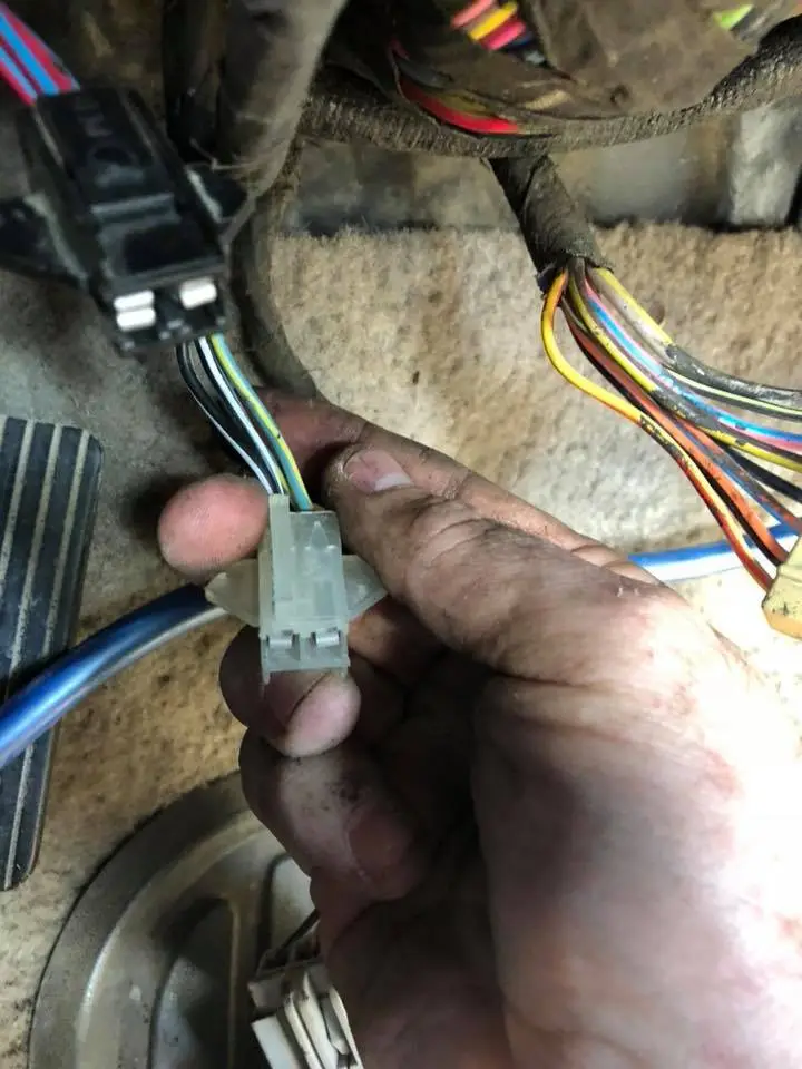

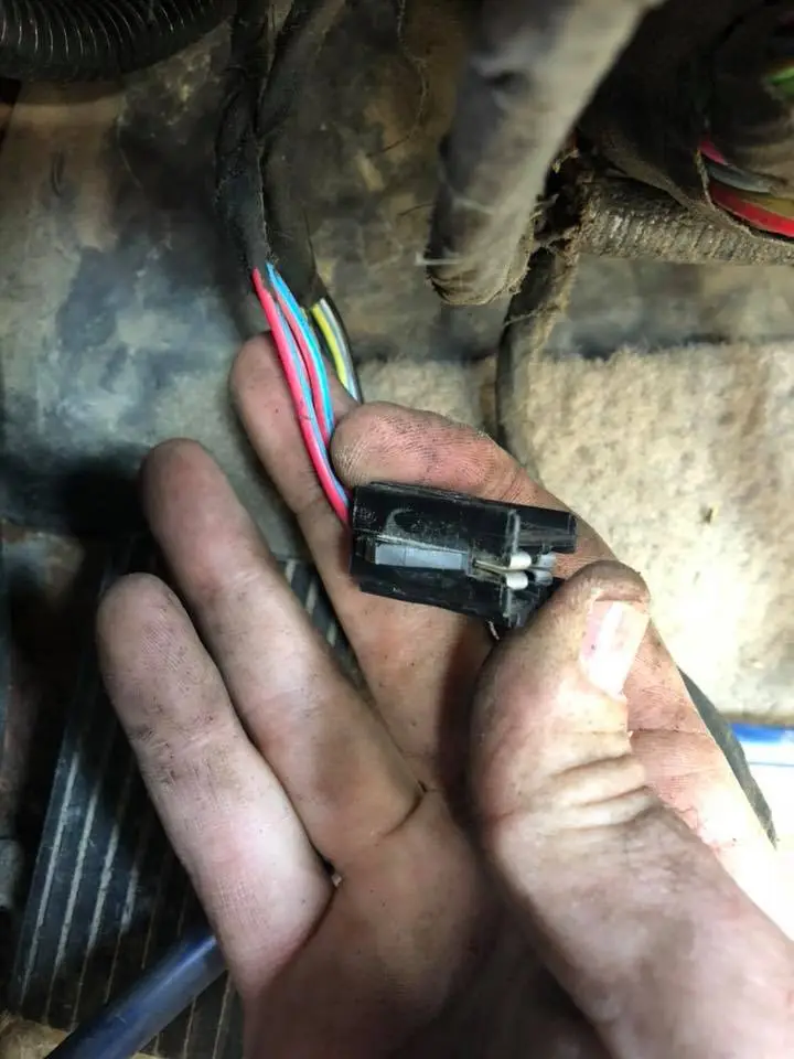

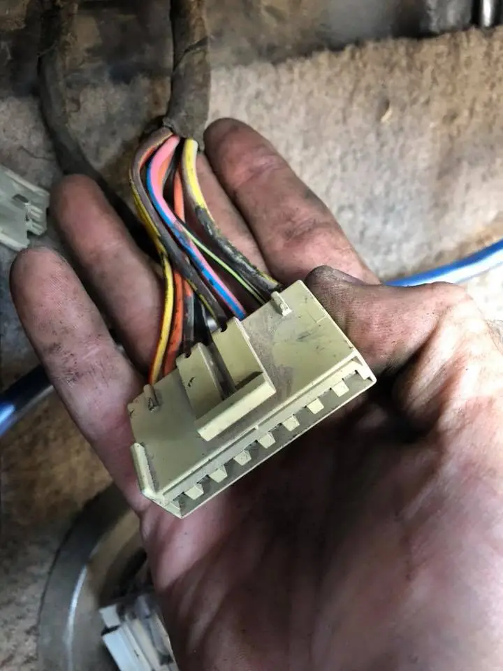

1990 mustang 5.0 auto. someone butchered the wire harness installing an alarm system. black plug was spliced into the alarm dont know where it goes.

What doesn't work without the plug connected? Will then engine crank and start? Does an alarm sound: do lights flash?

took all the alarm wiring out. car has power and seems normal even the fuel pump primes but no crank. didnt jump the starter yet to see if that will start it

The black plug is the clutch safety switch. It prevents the car from being started without the clutch press in. It should be jumpered on a auto car and is probably your problem. The other plug is the neutral sensing switch for a manual. I believe it is left disconnected on a auto.
I'm not 100% sure on the larger plug but I think it might be for your cruise control module.
I concur

Is the large plug for the door ajar chime module? Sorry I don't know the correct term for it.
