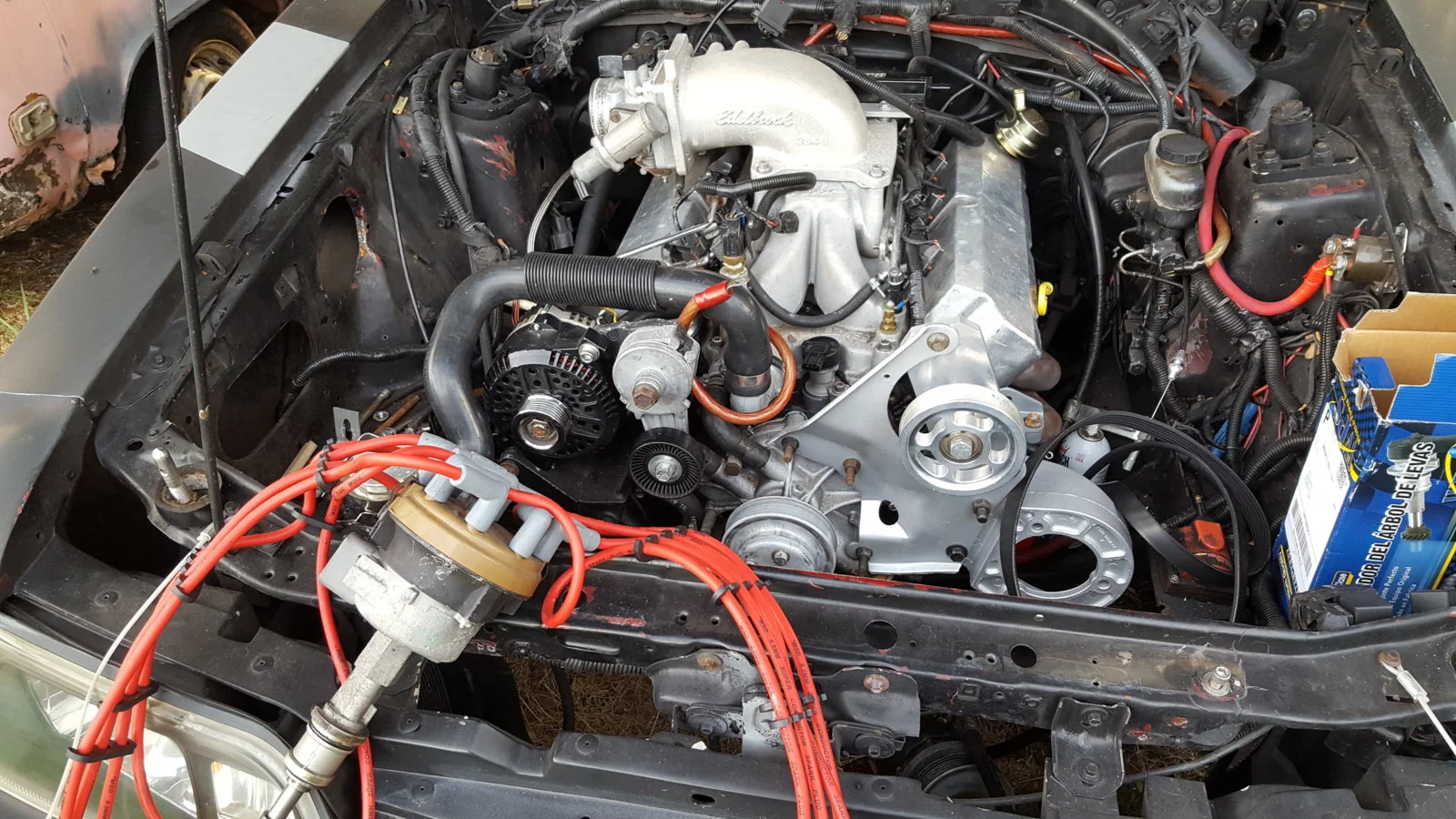

You could use something like this.
I took a Parker funnel web and drilled it for injectors. Worked fantastic.
A megasquirt is a low cost option as a standalone system. Check my Sig for the link to our megasquirt thread.

Also most of us have parts on shelves.... like 30lb injectors, elbow and throttle body in this picture..... i already sold the intake but i believe proffesional products makes one ready to go.
