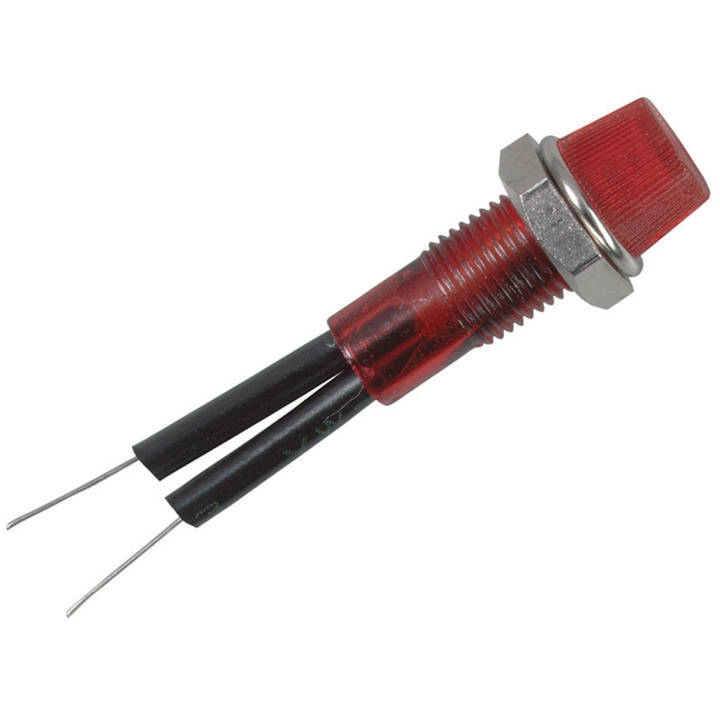

An incandescent bulb works by heating the filament to the point where it emits light. That takes time and steady current. Neither of those two are present in the injector circuit which is a square wave pulse of short duration and low repetition rate when the car is being started..
The best substitute for a noid light is a $2 Radio Shack 12 volt LED.
Noid light substitute: Be aware that LEDs are polarity sensitive. Connect it the wrong way and it will not light up.. The good news is that if you connect it backwards it doesn't hurt anything.
RadioShack® 12V/20mA 4mm Red LED with Holder
Model #: 272-345 | Catalog #: 2720345 cost is $1.99

I know that the LED works .
Yes I have about 10 years ago when I couldn't find my Noid set. Haven't tried the test light method but I assume it would work as well, as the video is on a 5.0 mustang.

I have used the led with good results to chase down faulty components. Good testing tool there.
