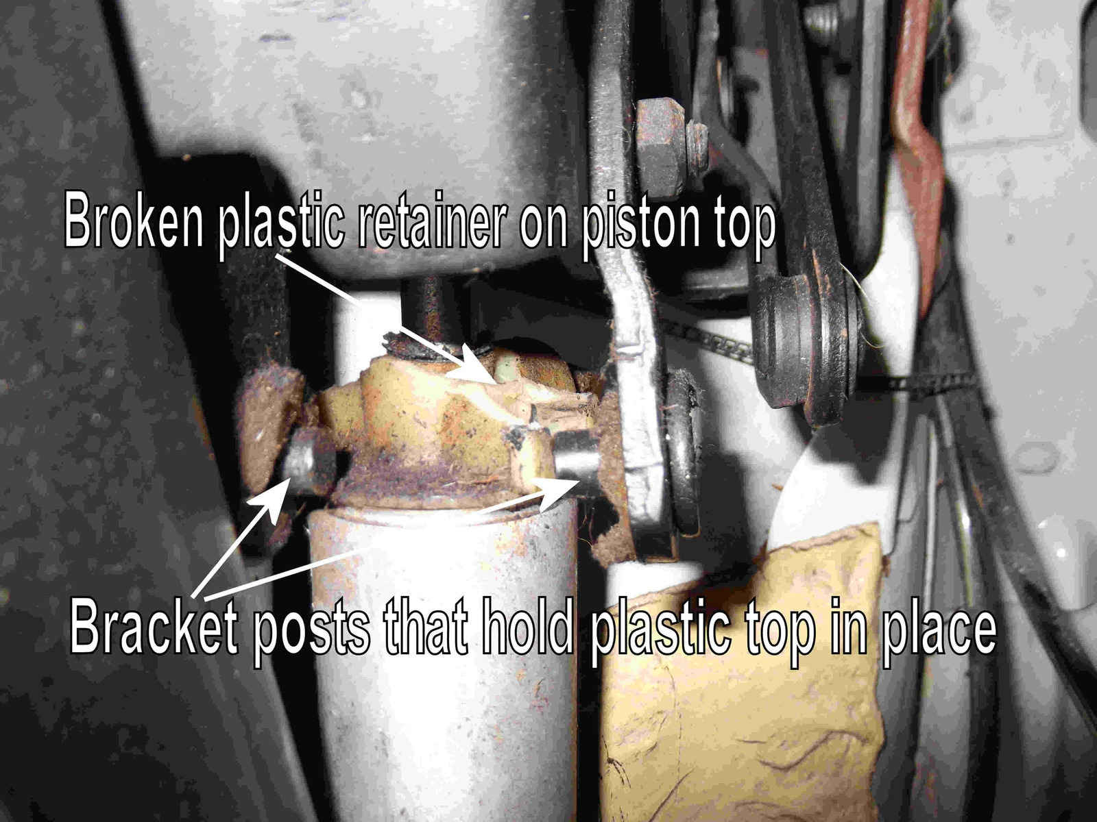

I also found today, that one of my hydraulic pistons (for the top) has broke free from the mounting mechanism (the piece that broke can not be replaced). I would like to come up with a bracket assembly to hold the piston in it’s proper place (piston torque being an issue) without it tearing up the inside fender-well in the process.

Do you have any welding skills and/or access to a welder? If so, once the surrounding area is cleaned up, the original piece can be welded back in place and if necessary, reinforced so the problem does not happen again. And while you are at it, take a look at the other side to see if it is about to come apart and repair it before it gets worse.
If the original metal bracket was broken I would have no trouble welding it myself (I have welding experience), but that’s not the case. (I’ll try to include a photo). What broke is a plastic retaining ring affixed to the top of the cylinder which the pull/push rod runs through. Attached to the backside of the retainer is the upper hydraulic fluid hose connection. The metal bracket has 2 nubs which fit into either side of the retaining ring and secure the cylinder in place. There are no other brackets holding the cylinder.
I just took another look at the original bracket assembly and noted that it is very rigid, very thick steel mounted to a reinforced steel plate, to protect against the torque created by the cylinder I suspect. For this reason I am going to just replace the entire cylinder (both of them as a preventative measure) rather than risk damaging the Pony with a new redneck bracket that could tear her up.
