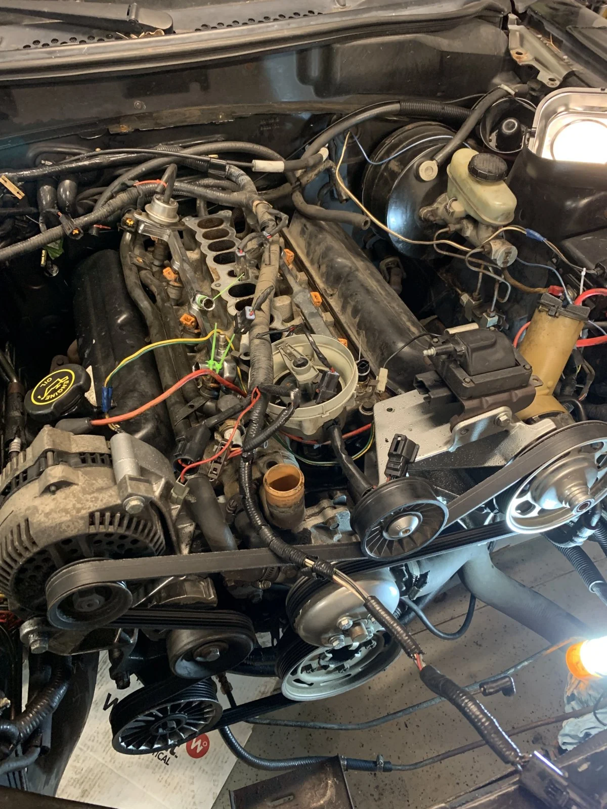

Got any pics of the engine bay and wiring? I’m curious how clean of a job whoever did the swap did. Sounds like you got a good deal on the car.

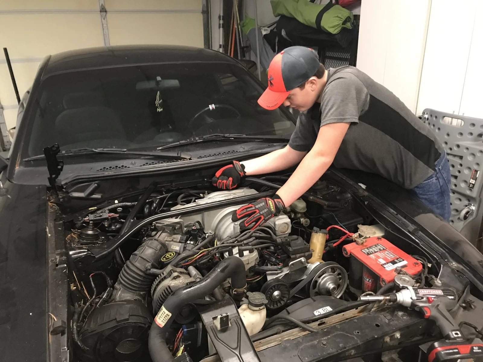

Thanks for reply 96pushrod. Unfortunately I didn’t take detailed pics of the wiring before I started disconnecting things (but I labeled them) while it was all intact. I will include the only pics I have of before but not sure what can be seen. Like I said, it’s not pretty but it obviously works. There are some areas that looked like they were either spliced or reconnected with butt connectors. I’m guessing in the long run it’s probably worth just replacing it,especially if the engine comes out.
I did verify they are GT40p heads with the bars on the end and they are stamped “GT40p” under valves. Looks like I’ll need a hood to fit it because it looks taller. Also if I go that route I’m figuring a new TB?
As for radiator and fan, I assume they are both original v6 because they don’t look like they’ve been separated and “3.8L” is on a factory looking sticker on top of fan shroud.

Doesn’t look too bad. I believe I have a spare sn95 5.0 engine harness lying around.
You know how you make that v6 fan a 5.0 fan? Rip the sticker off lol. As long as the ccrm is from a 5.0, then it will act the same as the 5.0 version, as the 5.0 ccrm has a relay that trips the high speed mode when temperature gets above a certain point.

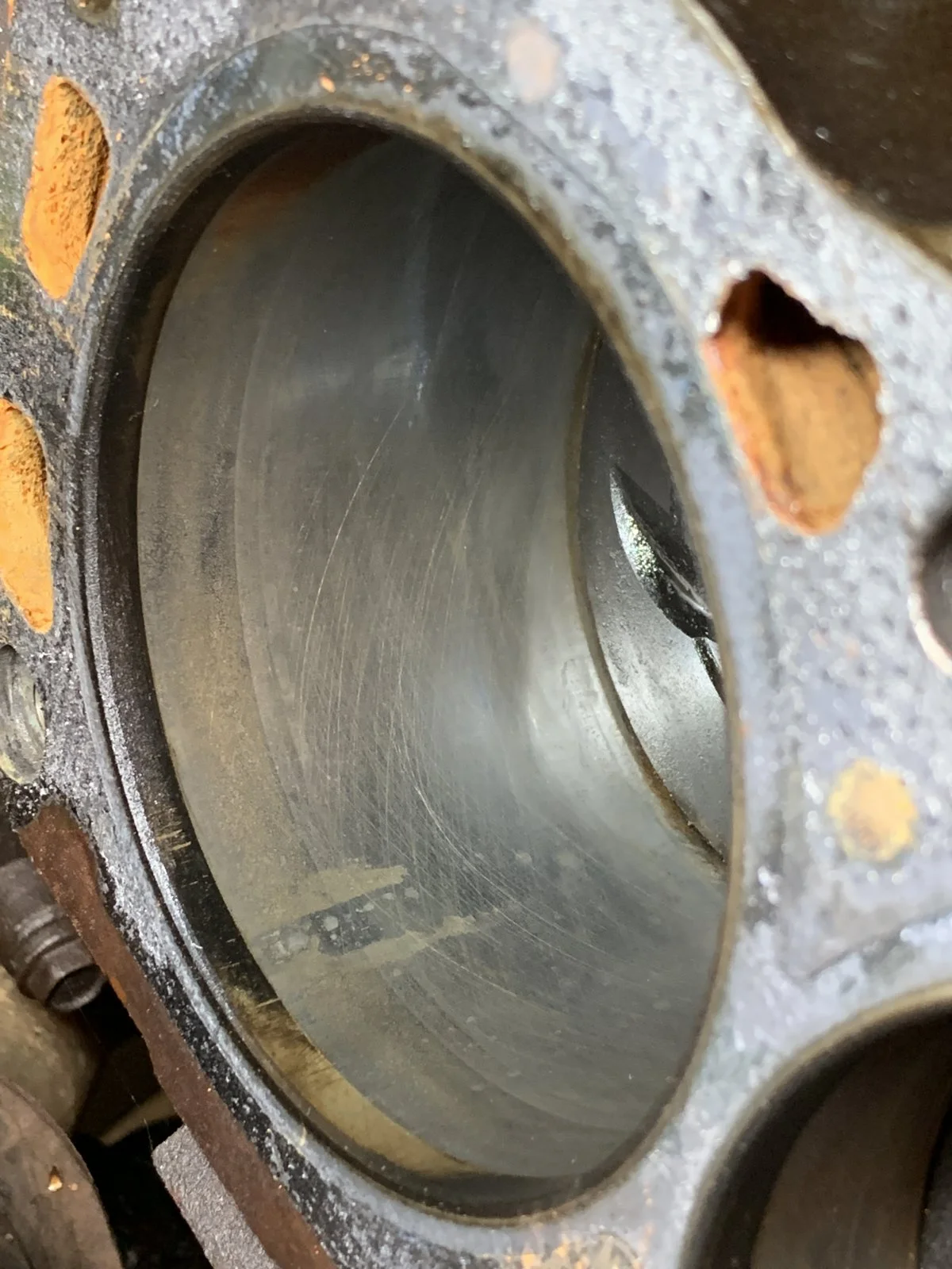

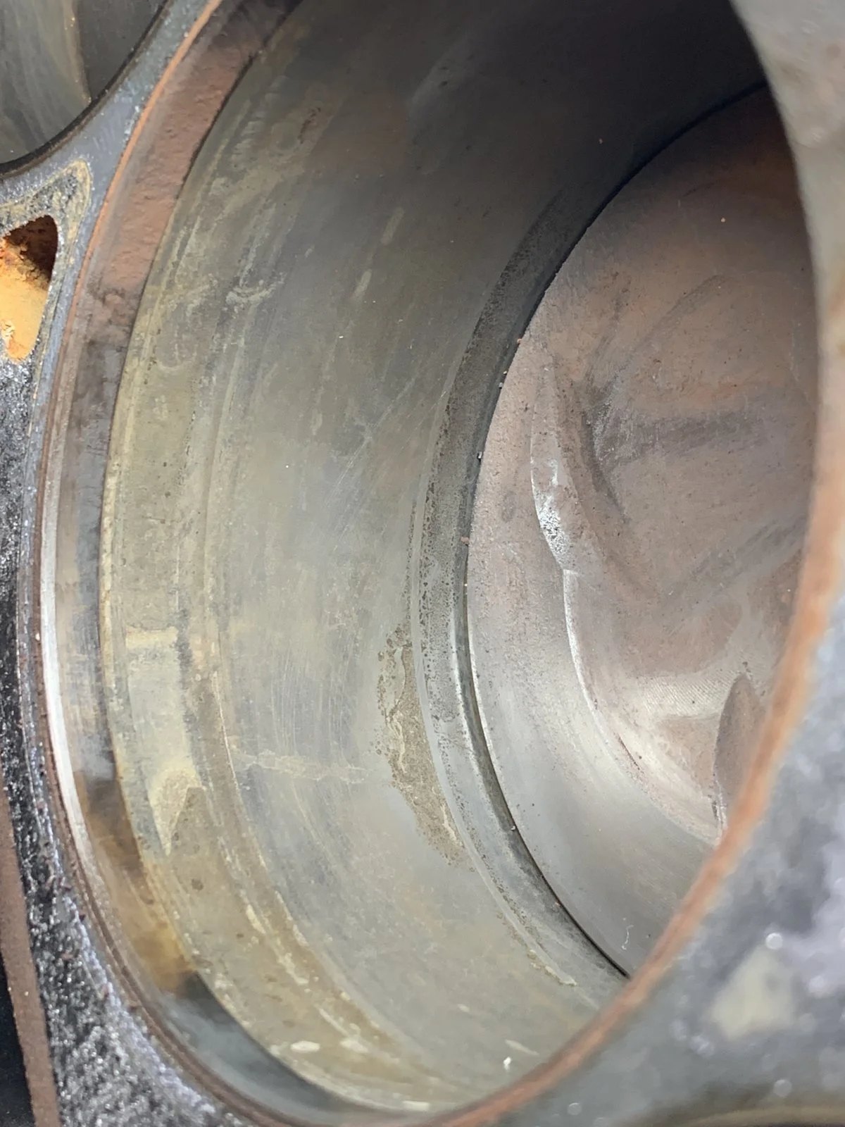

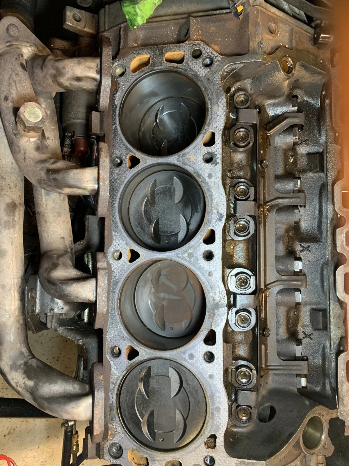

Also got the passenger side head off today and want to post pics to get second opinion of cylinder condition. Doesn’t look like it’s got many miles because you can still see the honing marks. There are a couple spots there is slight discoloration but not sure what it means if anything. Hoping the previous guy didn’t let it sit too long without fixing head gasket and cause too much damage. Want to get other side for tomorrow and see what it looks like. Going to tear down heads and send to get tanked, fluxed and decked.
There is a small lip but I don’t think it’s too bad. This may be a dumb question but every engine I’ve ever pulled has gone right to machine shop so I’ve never really worried about cylinder condition... but wouldn’t honing marks not be visible if it had a lot of wear/miles on it?
I'd clean up and run it, the ridge looks to be above piston travel so not a huge deal. He is building a car for his son to drive around in not a drag racer so if it doesn't make peak performance from a little ring wear or whatever what does it really matter?
A 'little ring wear' is best defined by measuring the bore. What it matters on a street car, if it's worn enough, you'll burn oil, foul plugs, get poor fuel economy, poor acceleration, wear out your catalytic converters, have hard starts, and eventually have it break down. When you have a significant wear ridge, that probably also means the bearings are worn and your fuel pressure is starting to dip.
Does this mean that's the case here? No. Is it easiest to measure your bore while you already have the heads off? Yes probably. :-) That's why I suggest it.
The wear ridge is always above the piston travel. We can't eye-ball it from a photo and say it's either a lot or a little - it looks pronounced to me, definitely something that'd catch a finger-nail. Car may still run fine for another 100k, or may be blowing off the oil filler cap with blowby. Measuring's a pretty cheap way to determine how worn it might be. It's not new, for sure, based on the ridges. Cross-hatch still visible or not.
Sure measure it if you like but is also important to keep in mind the context of it being a $500 car, so jumping to engine rebuilds instead of throwing some new gaskets at it and using it for the time being is a big jump to me.
I’d have to agree with this. If it’s my car, I’d probably throw a new gasket set and run it for another 75k
Heads are off and will be a week or so at the machine shop anyhow so car isn’t driving soon. I’ll get a measuring device somehow and see where it’s at. If motor needs to be pulled not is definitely the time to do it. Also trying to keep in mind I’m not shooting for 500hp or 11 second 1/4 mile times. Just want a fun street car that my son and I can play and tinker with for a few years until we decide if we let him drive it at 16 or so or ditch it for something else at some point.

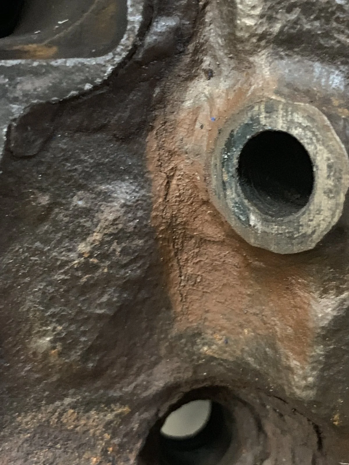

Well, hit a roadblock. Dropped the heads off at the machine shop and the guy noticed what he is pretty sure is a crack. It’s in the area where if it came from the same side, is near where the head gasket blew. I just went and looked and engine block seems ok in that area from only a visual inspection.

There aren’t any junkyards that have explorers or mountaineers near you? They’re pretty abundant where I’m at. Gt40p heads tend to be pretty easy to find and are usually cheaper than regular gt40s.
