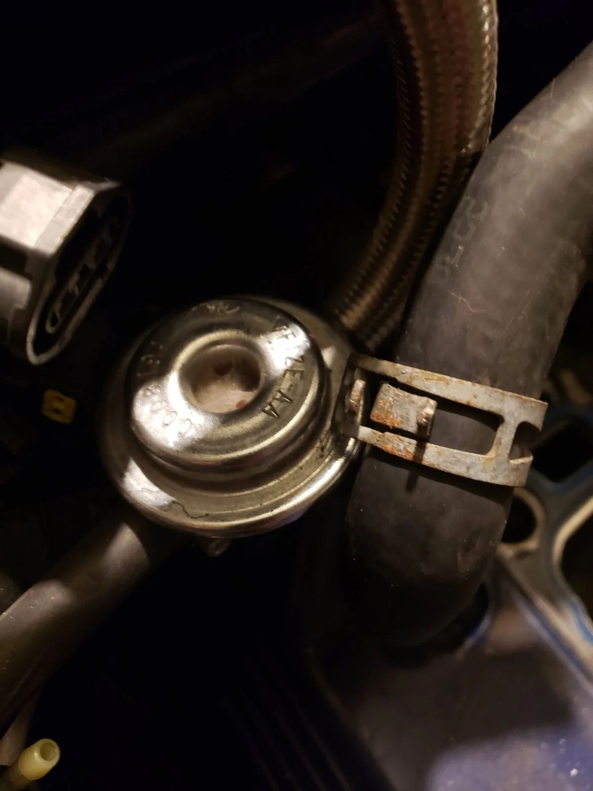

Can you keep it running while revving it like as long as you like if not do you have (forget what there called) but like a pressure regulator reserve in the fuel line ill post a pick since im sure I'm saying its name wrong. And is it still fuel injected or did you carb it cause then ide say your carb needs adjustment hard to say whats wrong without seeing/hearing what's its doing
Whoops forgot the pic
I can get at least one "rev" buy pulling the throttle cable, then it dies. Everything is original stock. The only new stuff is the fuel lines, filter, pump and tank. All the lines running to and from the motor are original. The lines I added just connect into the system on the motor.
