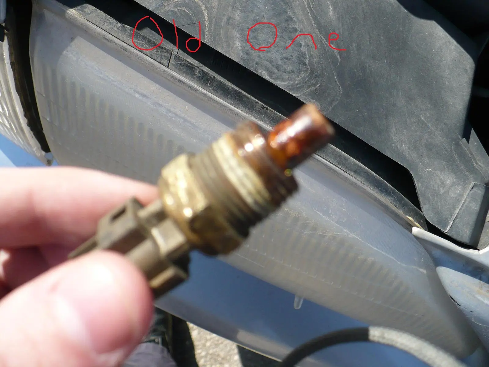

I bought a temperature sensor from Oreily's and put it in the spot next to the intake manifold, screwed into that brown metal pipe, where only one wire appears to go into it. Now, the engine light's still on and the temperature gauge actually moves farther left towards "C" than when the car is off. I think I also need to replace something called the "Temperature sensor switch" or something. It's another 20 dollar part I'm getting mailed in from oreilys, but I don't know where it is to replace.
Also, I'm afraid I might have them mixed up or something. The sensor I took out was (rusty) and looked like a cylinder shape on the end, where as the one I put in was cone shaped like this one: http://www.latemodelrestoration.com...5-Ford-Mustang-50L-Coolant-Temperature-Sensor .

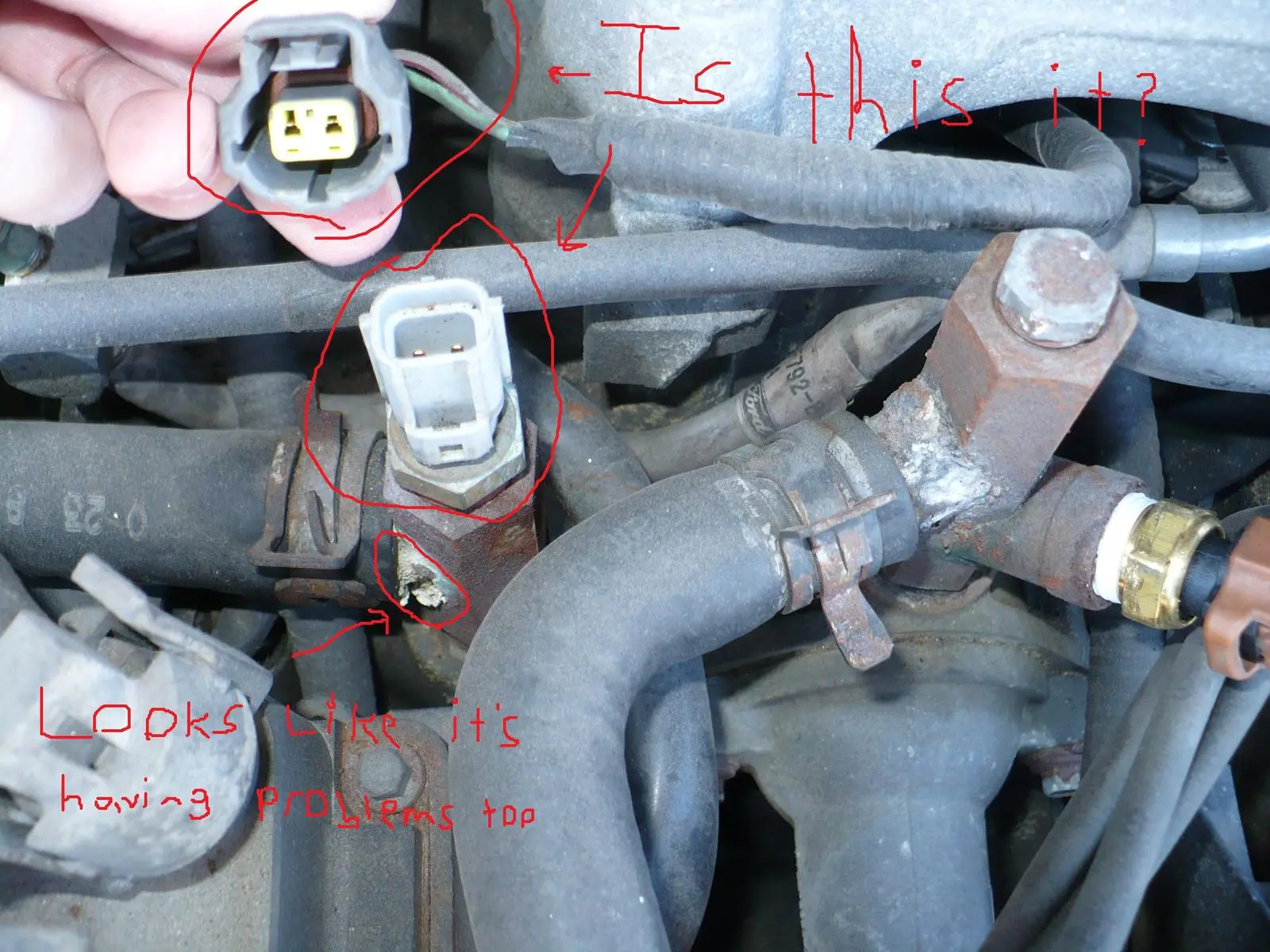

2. Where's the other temperature thing. Is it this one near by with the two wires?

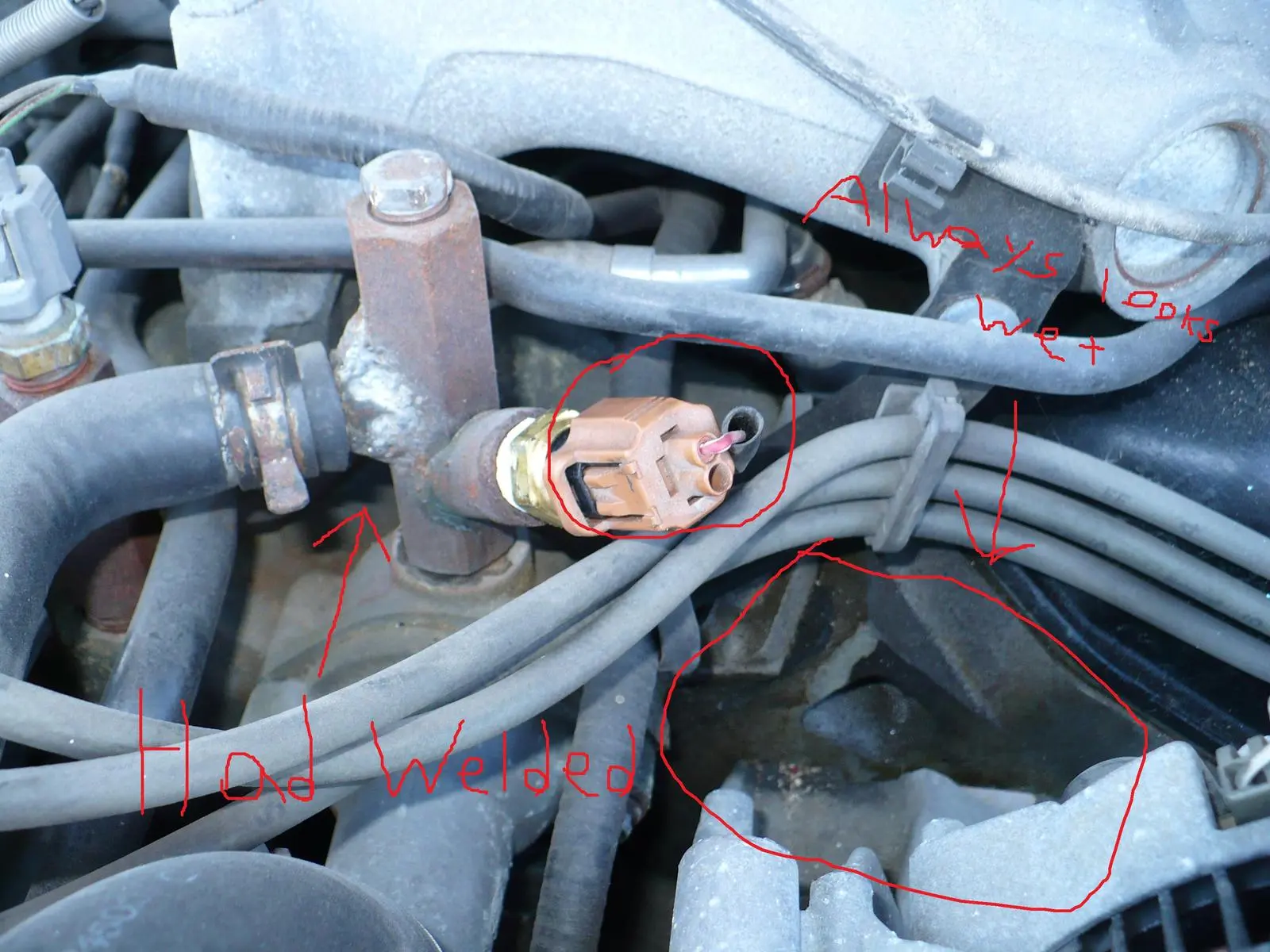

3. Are those two brown rusted pipes I'm showing you replaceable? Is it practical?

Well, I just dealt with that problem too. I installed a 98 motor into a 97 mustang, and within 1 year, the sensor went from a two line(97) into a single line(98). I looked into the wiring diagram in Chilton's and it says the green with red, grey with red wire goes to your gauge. Now, these wire are also being feed to your 02 sensors as well, which makes me believe that in (98) they only have 3 sensors? The (98) motor I picked up actually had another EGR right there in front, your first pick where your text says "always looks wet". See that black bar holding your wires together? right there. So, It leads me to think that you might have a early 98 version?
I do not have my chilton's in front of me at the moment, but when I get home I will check. I do have a set of extra "brown pipes" that are in better shape. When you added the coolant, did you burp the system? meaning, see that bolt on top of that "brown pipe" you need to open that up while you are filling it with coolant, but not when the motor is running. Coolant will go everywhere, I know, I tried.

OK so the sensor I put in wasn't the right one. In fact, I'm thinking the one I put in goes in the second spot. It doesn't have any notches, so it fits into either of the plugs which made it confusing. I bought a second sensor today, which has a cylinder shaped tip, and put it in the spot on the right, and the temp gauge actually works!(after about five minutes of running.) I still think my car's leaking somewhere though...
