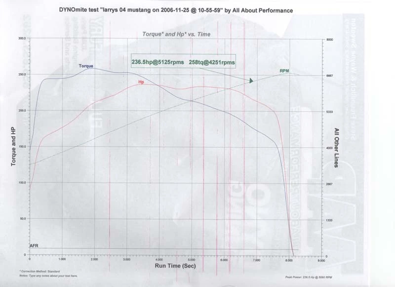

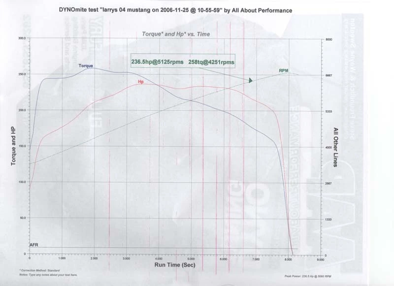

I did one pull only to get a baseline to work from. At the time a K&N drop in filter along with a modified fenderwell snorkel were in place. This is an eddy current dyno and I was told they read less then a dynojet.

235hp???? Did you put a 2v motor in it? Wow that seems extremly low.

Next time you should just dyno it on a conventional dyno. Those numbers that dyno spits out are gonna be hard to dissect because the numbers are so far out of whack, and your peak horsepower RPM is also off by about 900 RPM for peak power. Use a dynojet or Mustang Dyno next time. Even on a Mustang Dyno your numbers for a stock 5 speed would be about 250RWHP.

I was told this dyno reads about 40hp less then a dynojet. I am concerned about the power curves, especially torque. I haven't found any others running on this type of dyno so I can't compare to others. The owner has a supercharged roush and puts down 280 on it.

Well, if you add 40HP to that dyno pull, it would put you at 276RWHP @ 298RWTQ. So that would put you in the average area that a 5 speed Mach puts out. The torque RPM that dyno showed is where peak TQ RPM should be, but the peak HP RPM is low.

That is one odd looking dyno chart you got there! I don't think I've ever seen one that plots the rpms as another line on the chart, as opposed to being either an x or y axis. I think I'd try to find a dyno shop that uses more mainstream equipment, such as a DynoJet or Mustang Dyno, and do some more pulls.

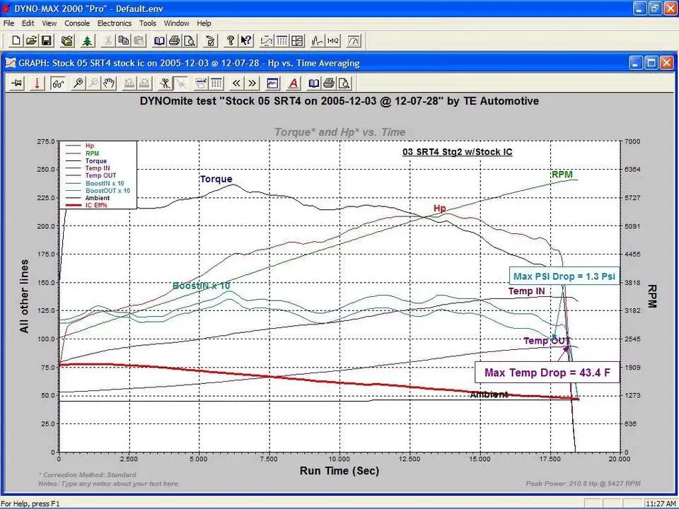

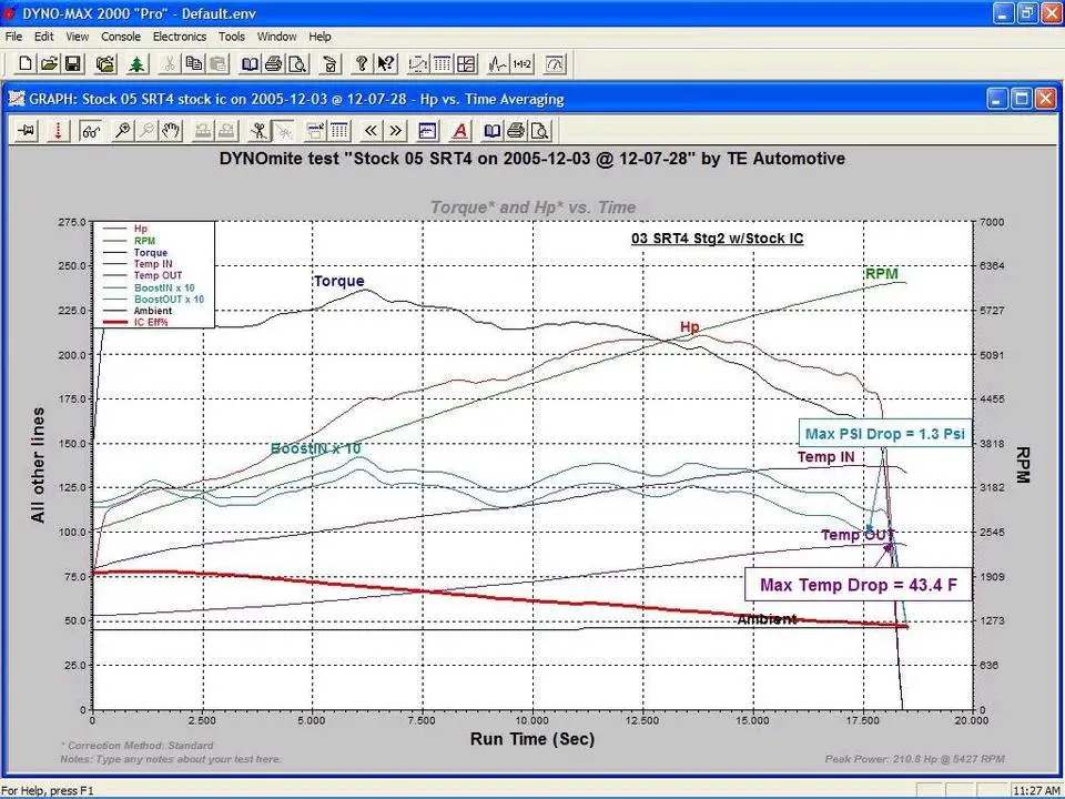

I found another graph from a dynomite (just not the same one),
Crzyhrse
Dec 23, 2004
38
Seattle, WA
Nov 27, 2006
#11
  • Nov 27, 2006
  • #11
VG30DE said:
explanation:
if it were a GT that was turned into a mach 1 clone (like tons of people do) than maybe those are more appropriate dyno numbers <--- sarcastic remark
But just for comparison, the horsepower curve and numbers are very similair to my 5.0 when it was NA and thats really strange from a 4 valve......
What kind of dyno were you on? A dynojet? Their is no way you got 230RWHP from a bone stock '93 GT. The dyno he was on is really strange. Way to confusing.
