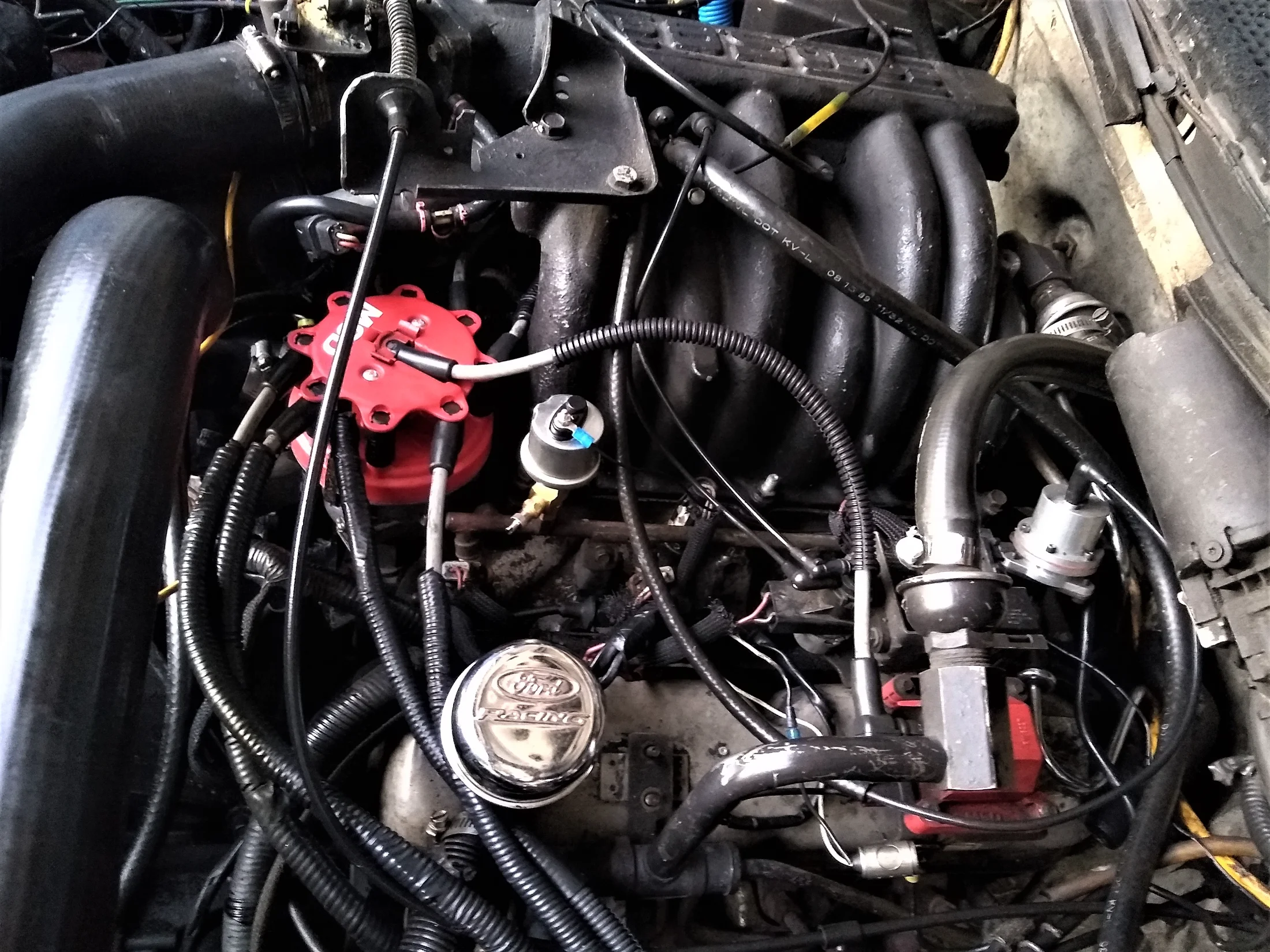

When you increase the pump size you should put an adjustable fuel regulator to account for the increased pressure from the extra volume. and to dial in the pressure.
When you do the math a 155lph pump is enough to support 440hp.........
The extra fuel volume will cause your engine to run richer especially after the vacuum diminishes and the regulator raises the pressure more than the regulated 39psi wit vac hose disconnected and the engine running..You can put a gauge on the schrader valve to verify the pressure.

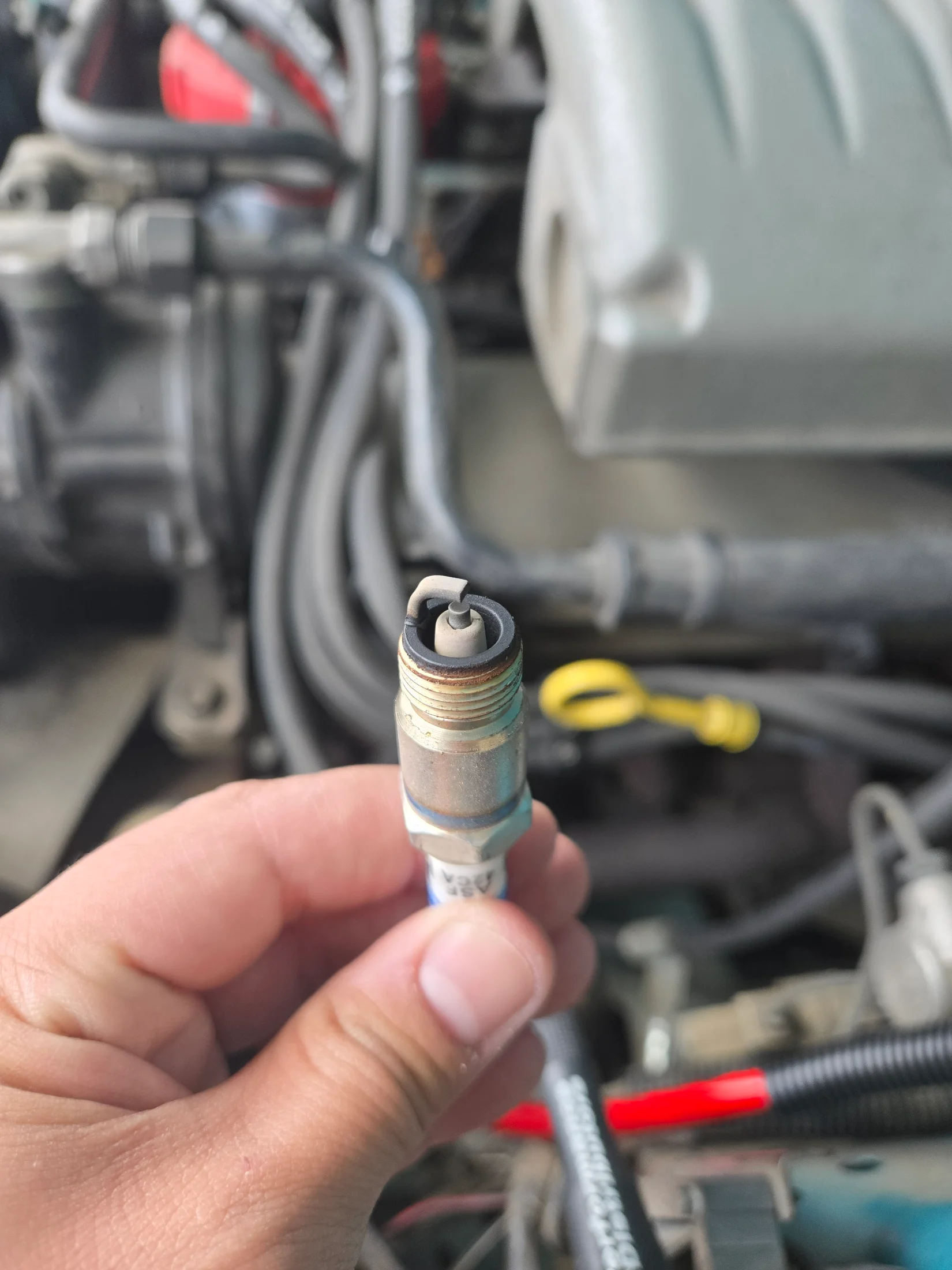

Pull the sparkplugs im gonna wager they come out black. unless your fuel filter hasnt been changed since the Bush administration...LOL
Another thing to note is that when you upgrade the fp its good to also change the fuelpump relay and replace it with one that is diode protected,,,The lil contact patch inside that transfers the power deosnt stay good forever and a slightly larger fuel pump equals a slightly larger power draw...
Good Luck
Reactions: Ryu
