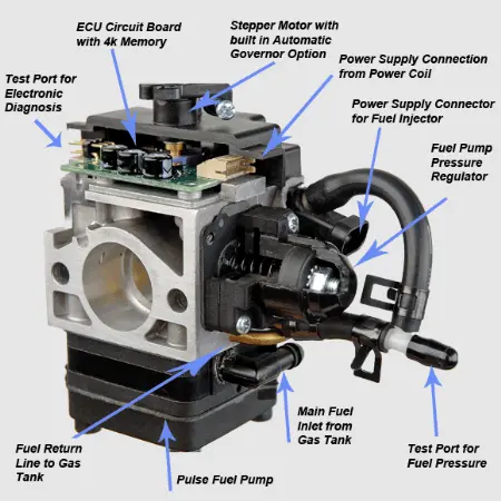

Not for long. Kohler and Kawasaki make most of the engines used in commerical mowers. Both companies have been using EFI for a long time now in selected engines. Both companies are getting ready to switch their entire lineups to EFI. I have a 2003 60" Dixie Chopper with a Kohler 28 EFI. It has the TPS, O² sensor, 2 injectors, T/B, the whole nine yards. Kohler's system is made by Bosch. Kawasaki makes their own system.
Robin-Subaru is currently the only manufacturer of a single cylinder EFI utility engine. Subaru Robin These little engines have almost the entire EFI system built right into the throttle body. It's also a low pressure system.
These ain't your daddy's old 3.5 HP Briggs engines.

Here's that throttle body.
