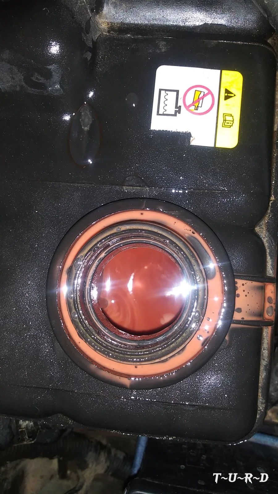

W wedo70 New Member Jun 11, 2018 1 0 1 Levelland, Tx Apr 9, 2020 #1 Apr 9, 2020 #1 Oil in the coolant reservior tank what should i do Attachments 20200407_212052.webp 234.1 KB · Views: 161
wmburns SN Certified Technician Aug 14, 2009 5,892 514 204 Houston Texas Apr 9, 2020 #2 Apr 9, 2020 #2 Is this an automatic? It looks red. Check to see IF this is transmission fluid. IF it is transmission fluid then the problem could be something as simple as a rotten radiator.
L Leonitus New Member Apr 9, 2020 4 0 1 Denver, IN Apr 11, 2020 #3 Apr 11, 2020 #3 I see a new radiator, transmission flush and possibly a new trans in your near future. Do not drive it. Don’t start it.
