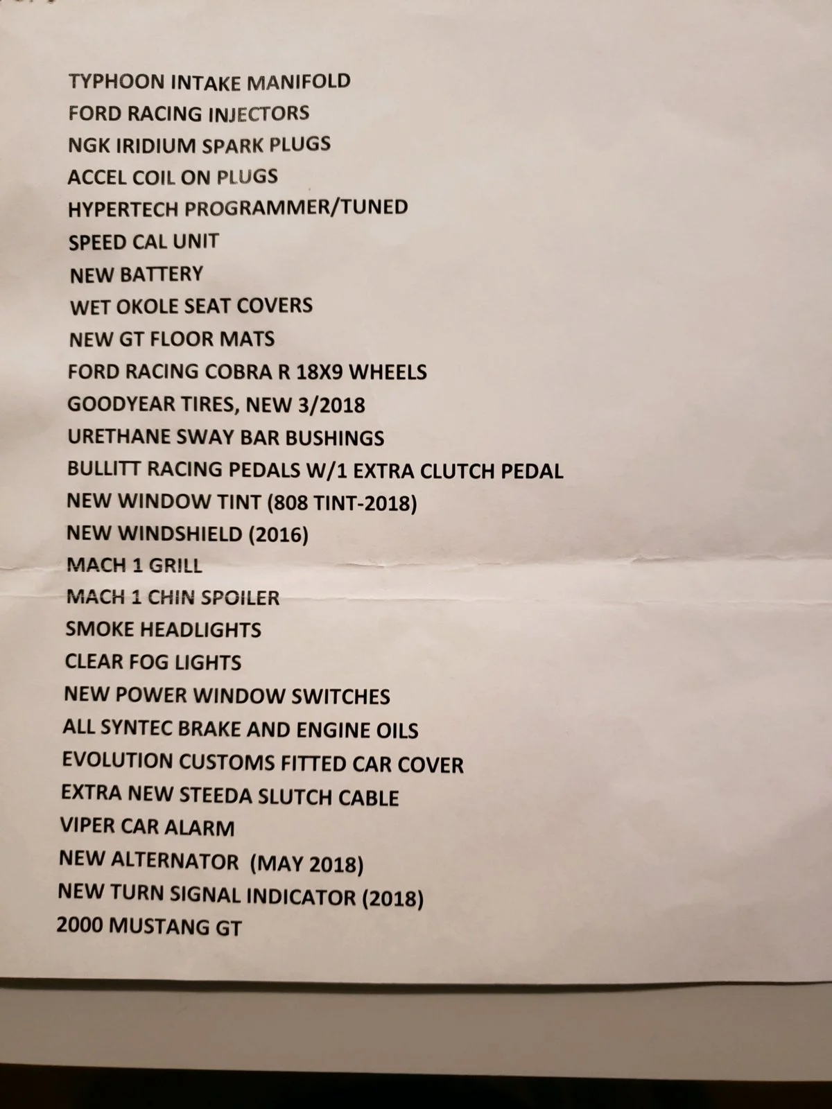

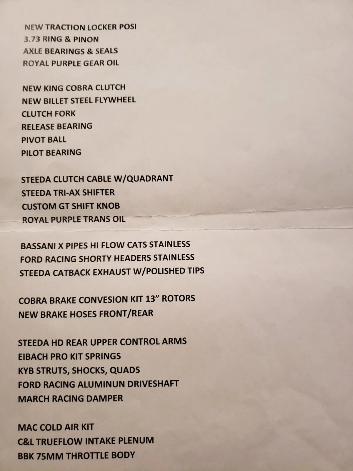

Hello everyone,
I recently picked up a 2000 GT 5 speed and looking to do a mild build. Shooting for a reliable 320-350 rwhp (I think 100 more than stock should definitely be a fun weekend/street car).
I’ll attach what the cars specs are currently. I’m definitely wanting to add cams to the 2V because honestly, these 2V’s sound amazing! I still need to check which injectors I really have, and plan to ditch the crappy hyper tech for something more substantial. From what I’ve read, the basic bolt ons are there. I just don’t know what else is needed to reach the goal (maybe supercharger?)
I’ve lurked and read that 400rwhp is the max for our stock internal block, yet seen posts of members going well beyond that mark with forced induction. So how true is that 400 on a stock block?
Any guidance and tips are appreciated!

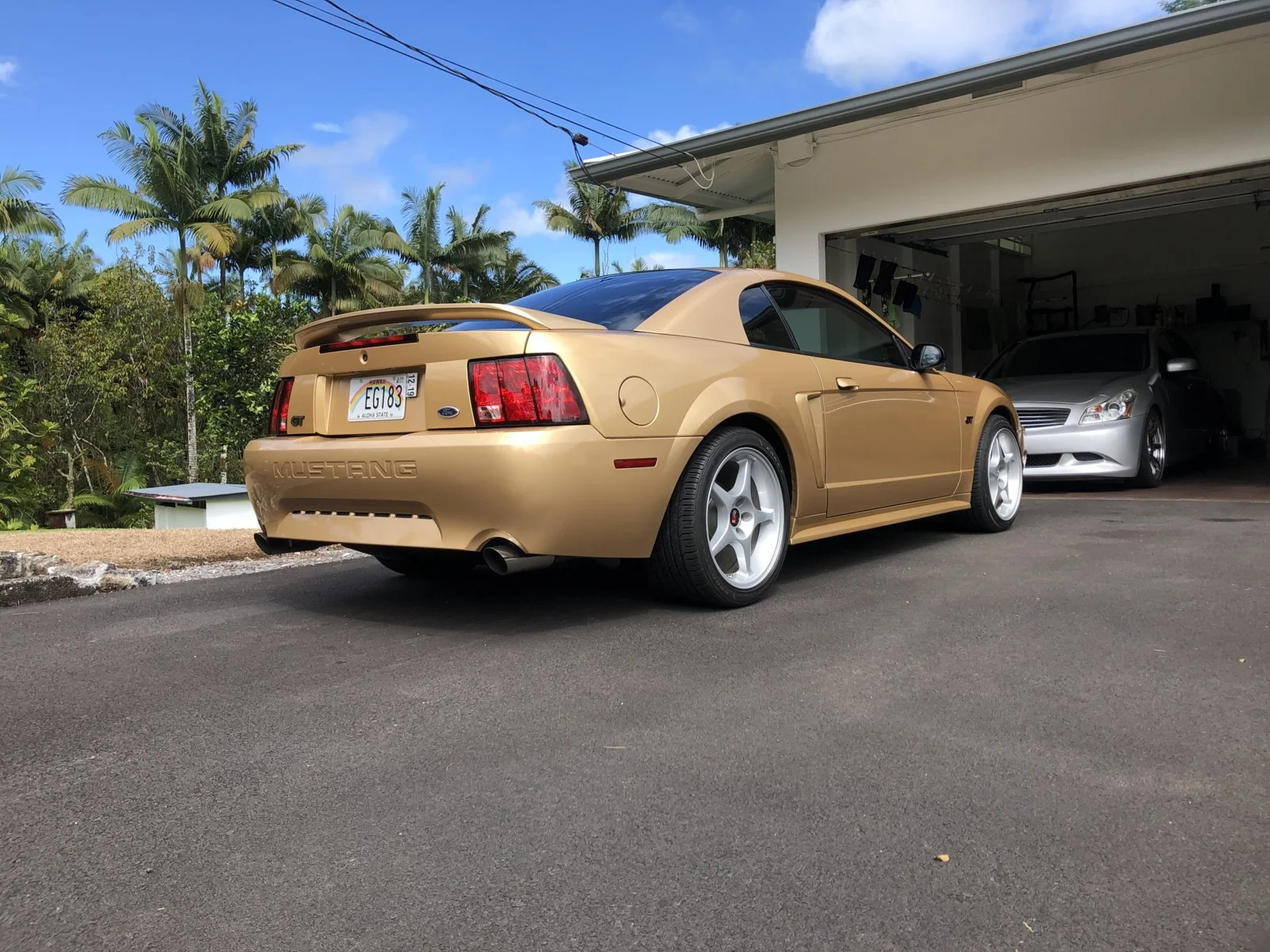

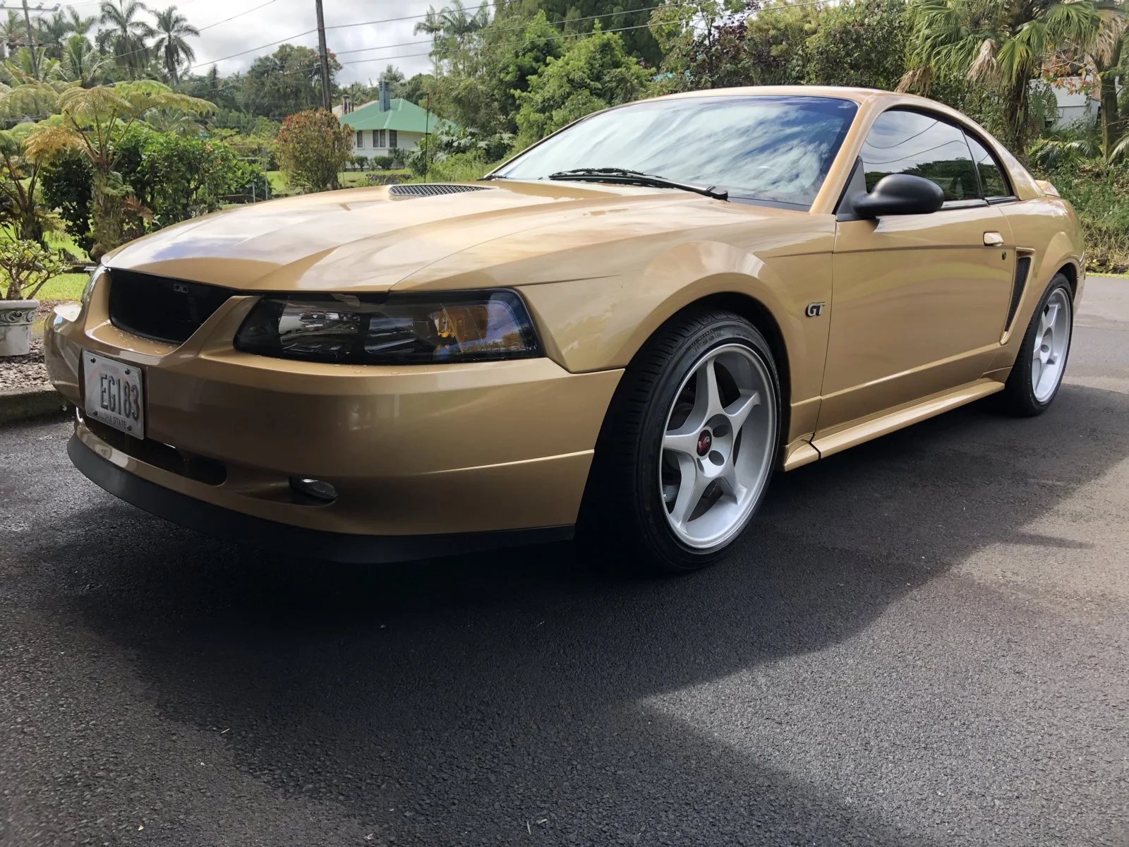

Here are the specs and of course, the pic of the car.

You can probably get away with about 450 HP on stock rods, they're powdered metal with does well under stress due to the brittle nature of it but doesn't handle fatigue as well. Most life expectancies of parts include a peak power recommendation averaged with a fatigue life of about 10 years normal operation. So for example, you might be able to put the rods up to 500 HP, but they won't last as long, and as you add more and more power the life gets exponentially shorter. It's the same with transmissions, if it's rated at 300 Ft-lbF, that means it will hold up to that rating for a 10 year life before going out of service specs. The stock bottom end of the modular 4.6 is limited by the rods, so if you want to do one build and be done for a long time you'd be wise to keep it under 450 HP, but if you don't mind less service life you can go to 500 HP but expect way shorter life and you'll end up with a thrown rod most likely. To prevent this you'd have to grind down all stress risers on the rods and you'd have to xray test the rods for internal cracks aa well as consistency of the material. All this expense would just warrant forged internals at that point.
