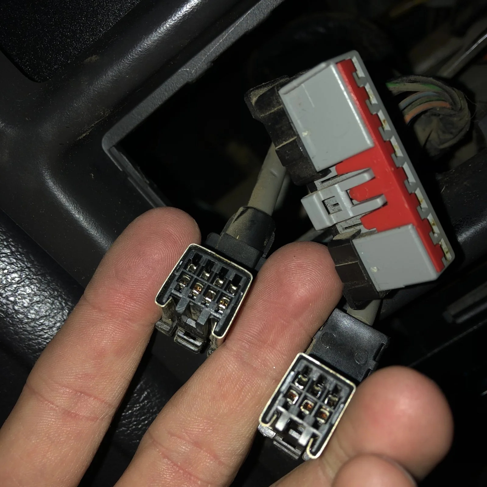

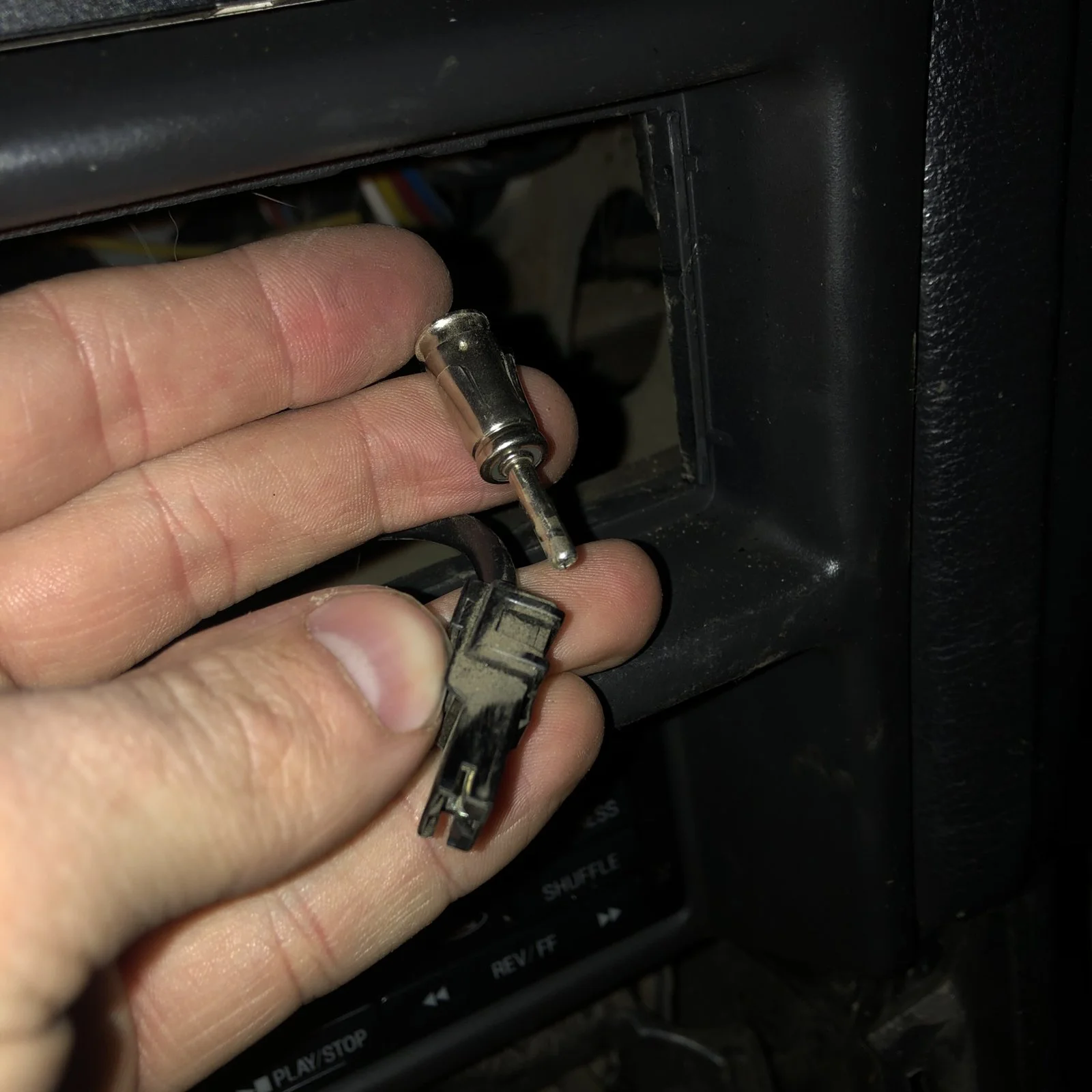

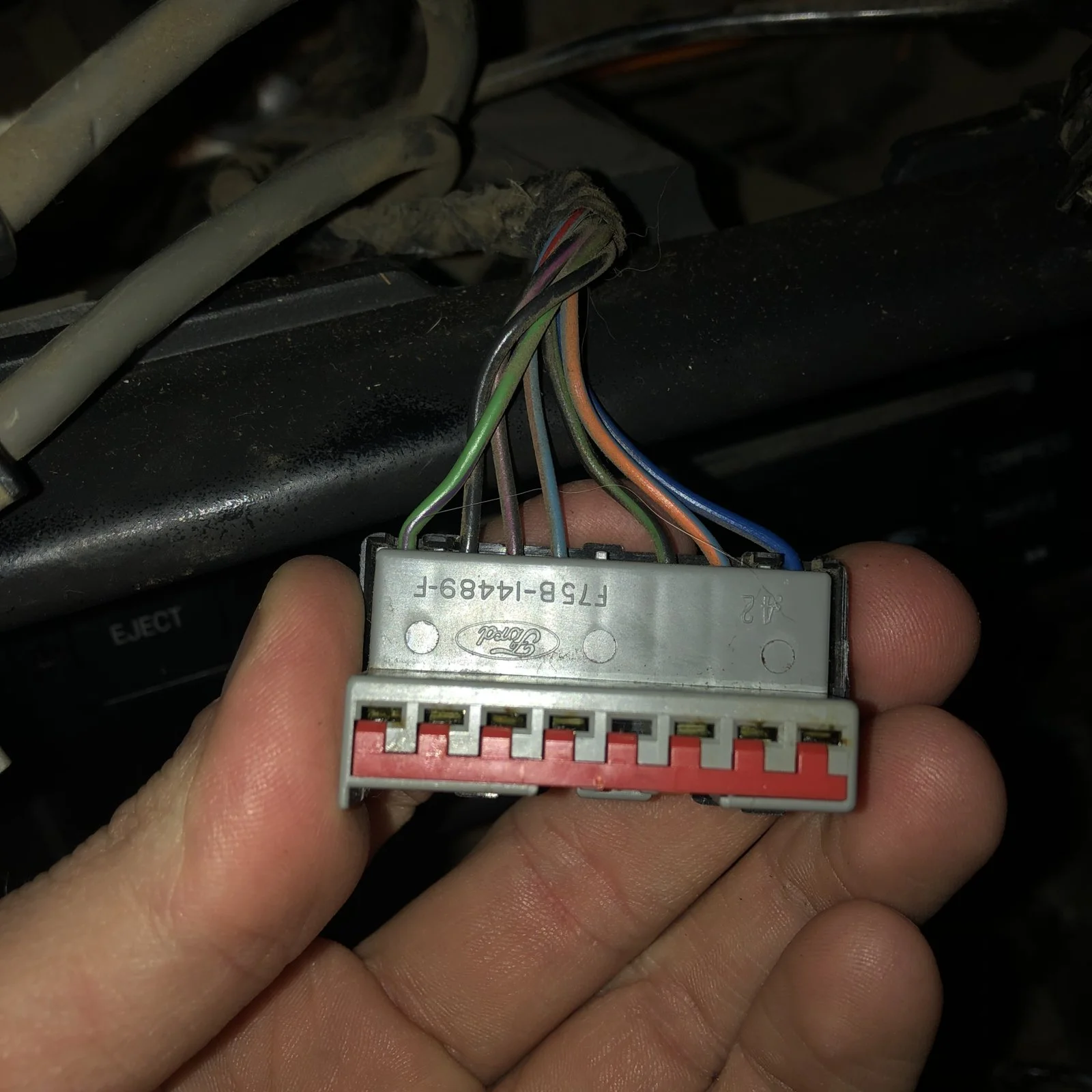

Susposedly I have the Mach 460 system but I think it’s been modified. Every video I see shows 3 connections. 1- 8 pin connection, 1 flat unit connector, antenna
Mine has 5... I have 2 separate 8 pin connectors, the flat primary, antenna, and another flat one I don’t know ... anyone know why??? I’m in process of replacing my stock stereo but now have to order more pieces
I have a 2000 GT with the Mach sound system. The original set up had a separate CD player. The two square connectors in the 3rd picture are for the separate CD player.
The single connector black wire with a white stripe is a ground. Usually there's a spade lug somewhere on the replacement radio. Expect problems if the ground isn't hooked up.

In my case the replacement single DIN head unit had a CD player. So the separate CD player wasn't needed. I took out the separate CD player and replaced with a "blank" cubby holder.
